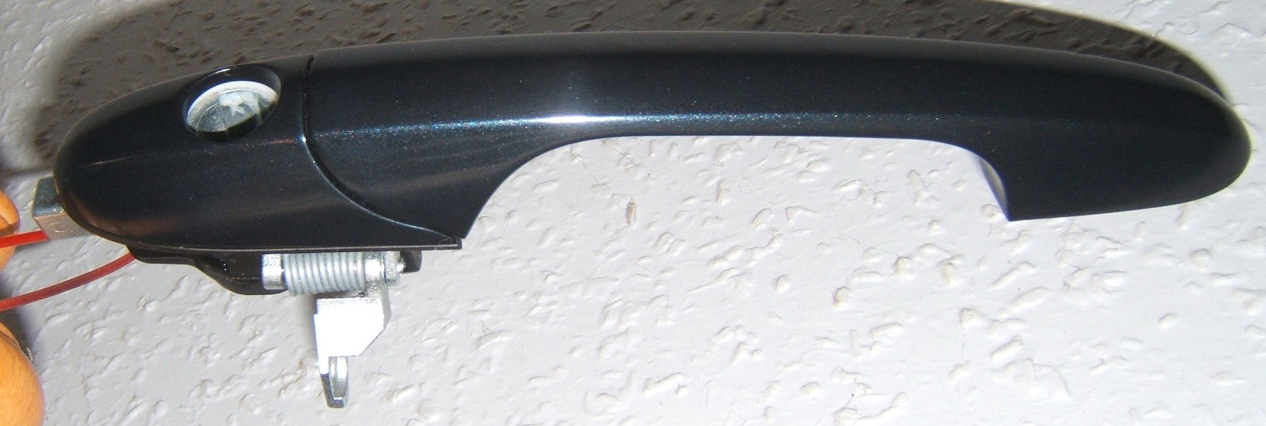

Modifying The Handle Rod Connection
The big different between these handles and the originals is the Handle rod connection. This causes two problems 1. The size causes it to hit the window runner and 2. The rod connects to the wrong side of the handle.
I think the large piece of metal is there to add extra theft protection or to add weight in the handle pull mechanism. Either way its got to go for our use. It is relatively easy with a hacksaw though the metal is quite dense so a good hack saw blade is needed.
First cut off this section of the metal. Put some masking tape over the mechanism to stop filings getting everywhere.
Half way through the cut.
All the way off, You may need to file the back down to smooth off any sharp edges and level it out with the rest of the part.
Next you need to cut off the part that interferes with the window runner.
I filed down the sharp edges to prevent any paintwork accidents.
