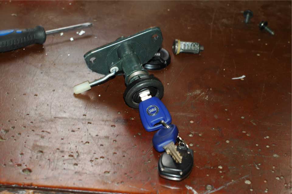

Swapping The Lock Barrels
Now to the object of the exercise, changing the barrels over.

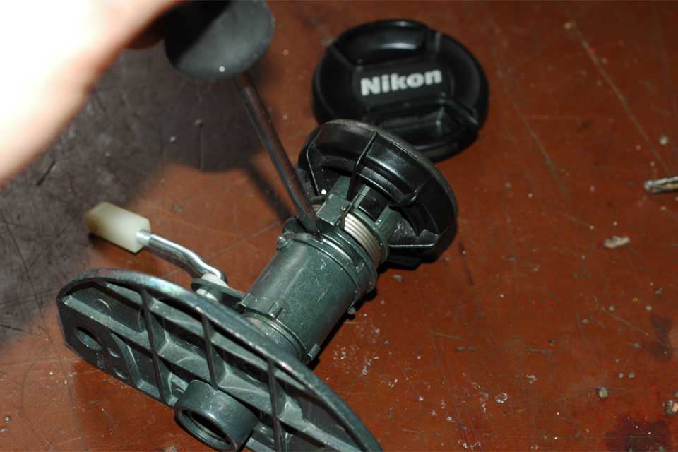

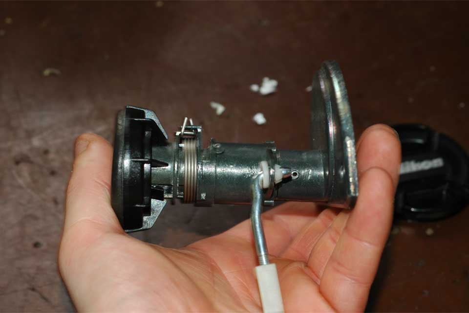

First, prise off the plastic cover, just use a flat head screw driver to push the plastic clip
you might find that you need to support one side with your thumb while you push the other side off.

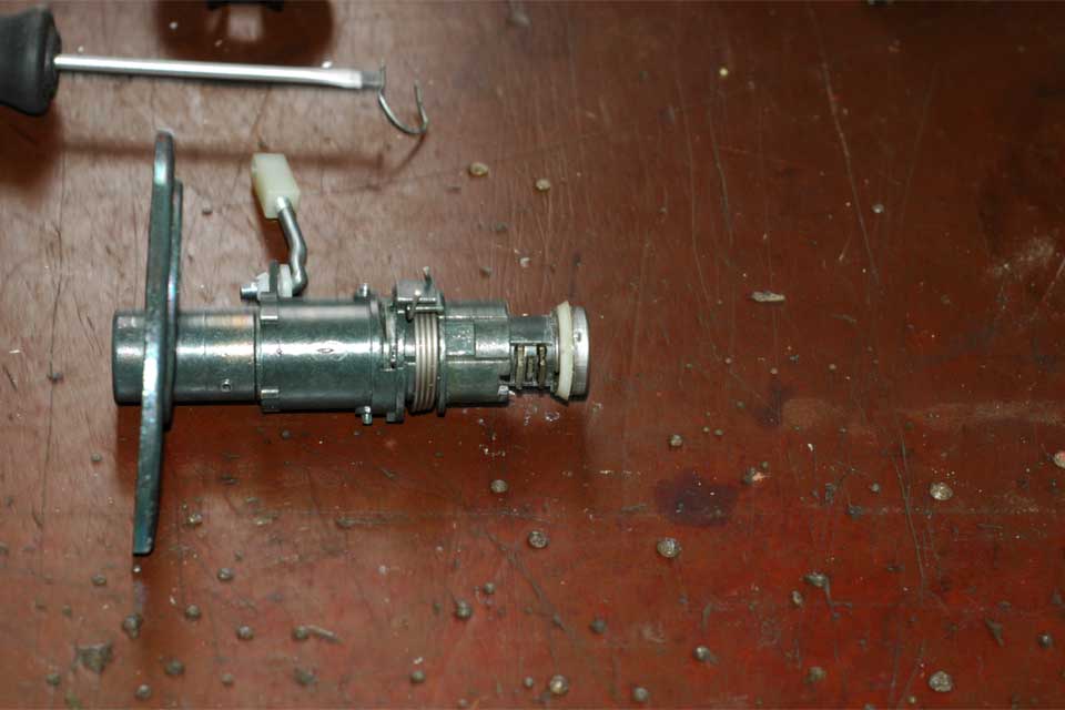

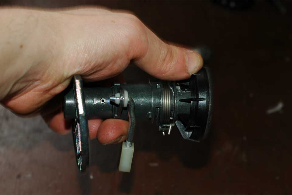

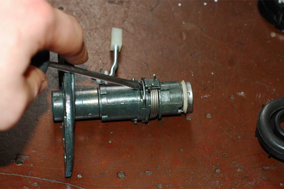

With the long flat edge of the back plate facing downwards you should see the lock barrel retaining clip in a slit of the rotating collar use a screwdriver to lift the clip out
The lock barrel should simply pull out

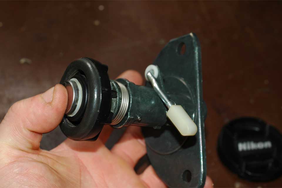

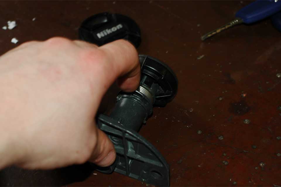

Once the barrel has been removed clip the plastic cover back on to the mech, then push the new barrel in
it will only push home in two positions so if it fits it's aligned properly

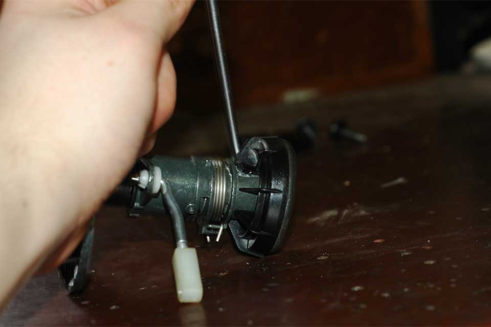

Once the barrel is in place insert the retaining clip, you may need to push it down with the end of a scew driver
I'd check that the lock works
