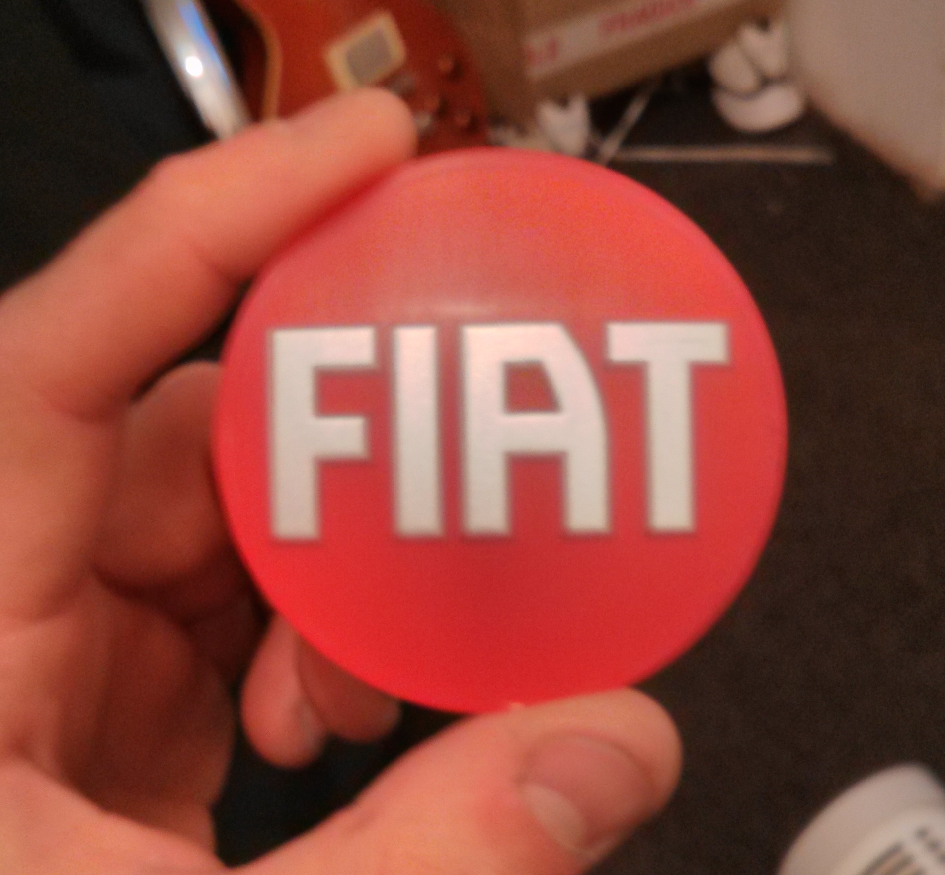

Clean and colour.
Remove all the oils and any other unwanted-ness on the surface of the Fiat logo using the paint preparation wipes.
Follow the instructions on the tin, if it doesn't have any, follow these instructions.
- Make sure the tin is warm, preferably at room temperature.
- Spray in a warm and dry area, free from dust.
- Shake the tin vigorously for at least 2 minutes to mix the paint up.
- Give the tin a quick squirt on a blank sheet so unblock the nozzle.
- Spray the badge at least 7-10" away from the logo, applying several even coats until you think it enough.
I used 3 thin coats, in between each coat I used a hairdryer to dry it faster and gave around 10 minutes until I sprayed the next coat.
This also applies to the silver part of the badge.
