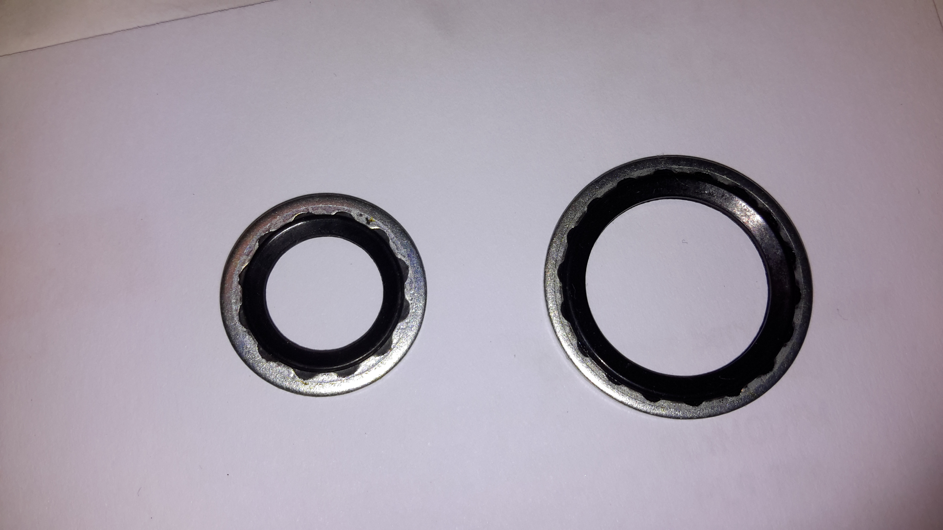

The 'O rings' originally talked about in this post are not standard O rings (I will add a picture of the parts). On the subject of O rings, it's not that easy to just go and ask your local aircon garage for some, for a start I don't know many garages that will do this and secondly aircon O rings are a special type of material and there are so many different sizes used in aircon systems that are not standard. It's not worth the gamble when it's going to cost £50-60 to regas if they end up leaking. There's also the environmental consideration, as already mentioned. Buy the correct seals and do the job properly from the start.
