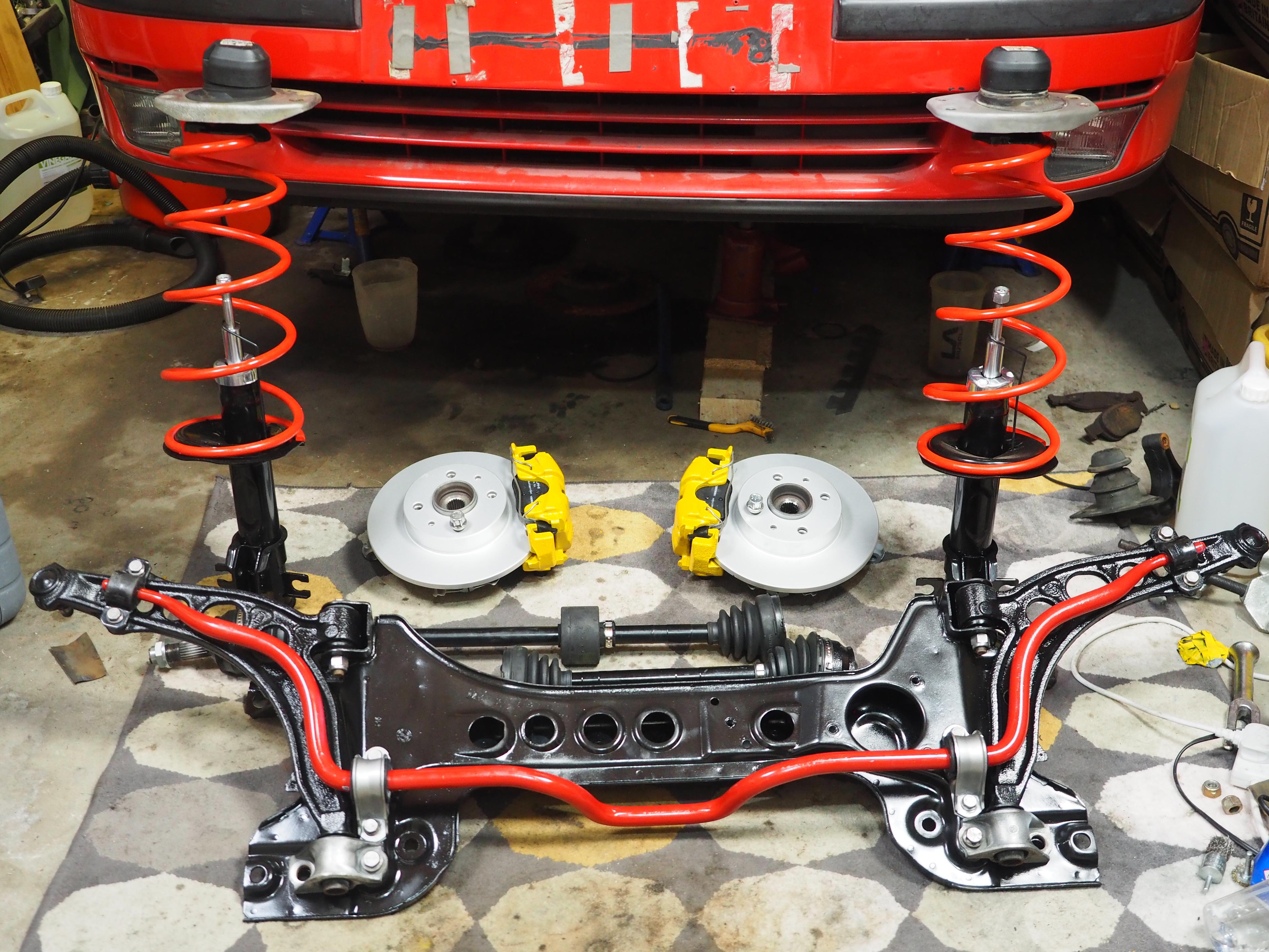

The subframe was not just in a surprisingly good condition, aside from some very mild surface rust, it was basically completely untouched.
A quick clean up with a wire brush to clean up any loose dirt and rust, and then a damn good blast with the pressure washer and it was as good as new.
I layed down a coat of Etch Primer, then some gloss black to make it actually look as good as new.

What then followed was a lot of sanding, wire brushing and cleaning. over the course of the last 3 or so weeks in the evenings. Then the application of a lot of paint. Some colour coding of parts to make it a little more visually appealing rather than just painting everything black. So anything springy (springs and roll bar) got painted red. Anything structural got painted black, and anything else was either painted silver or nickel plated to add contrast. The steering joints for example were painted silver as everything attached to them was painted black. Finally because the brakes would be visible through the wheels and the car being red I panted the calipers a nice bright Yellow.

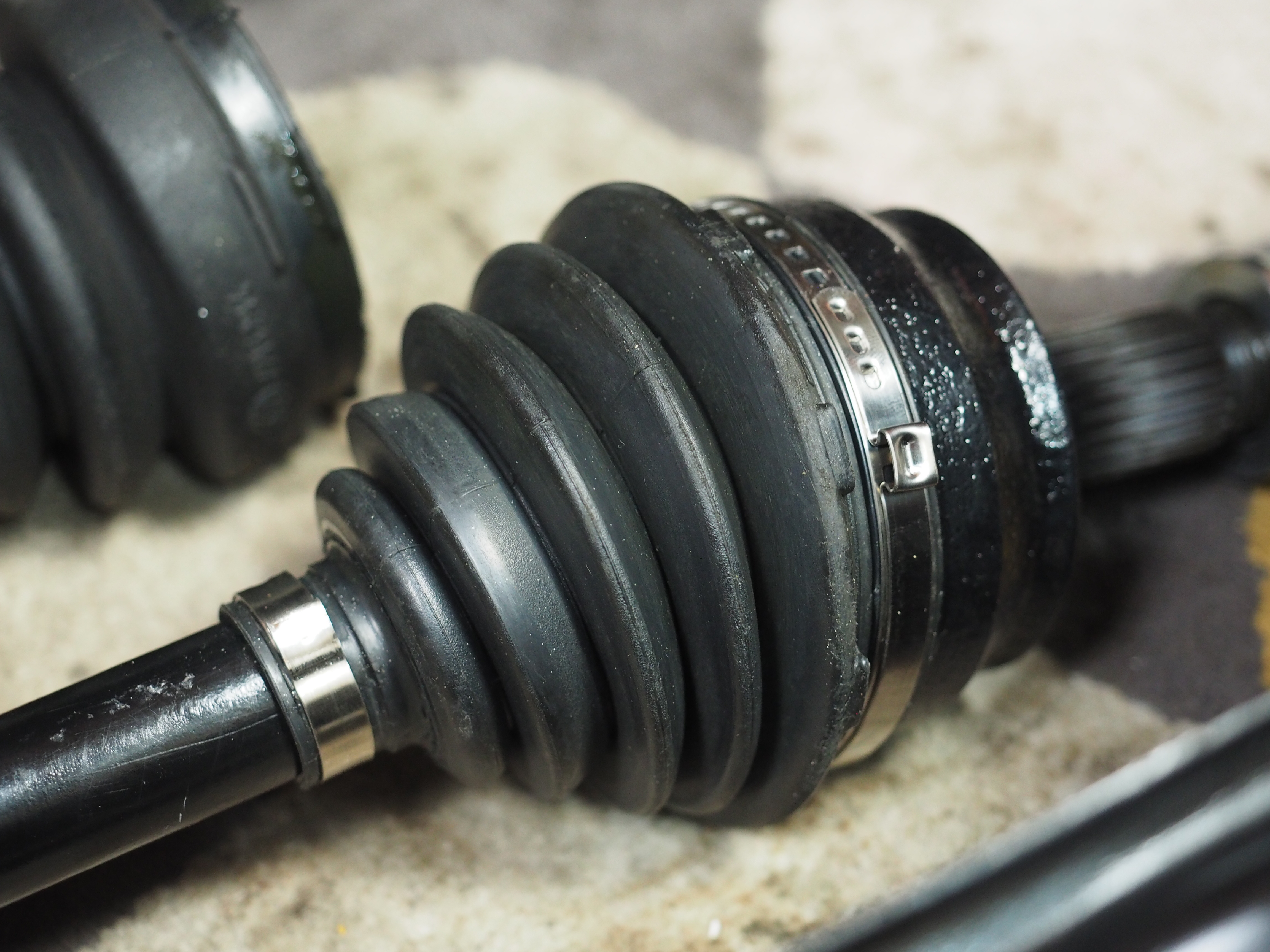

The drive shafts have also been fully refurbished and painted. new grease and checked for wear.
Everything was properly prepped and painted with high quality paints.
I have installed all new parts where needed or essential for safety. So new brake discs and pads. New shocks, new antiroll bar bushings. New ball joint covers, new clips and bolts where needed. New boots and gaiters where needed.
I am super happy with how it has all turned out. Everything looks shiny and new and is better than when it left the factory. I am just waiting on a set of bump stops for the shocks (the old ones had ceased to exist) and then I can start bolting everything back on the car. The one thing that has really surprised me is the insane amount of weight in all these components for such a little car, I would estimate probably more than 75 KG in everything bolted to the subframe. I think I may have to find a way to weight it to see for sure, and that is without wheels.

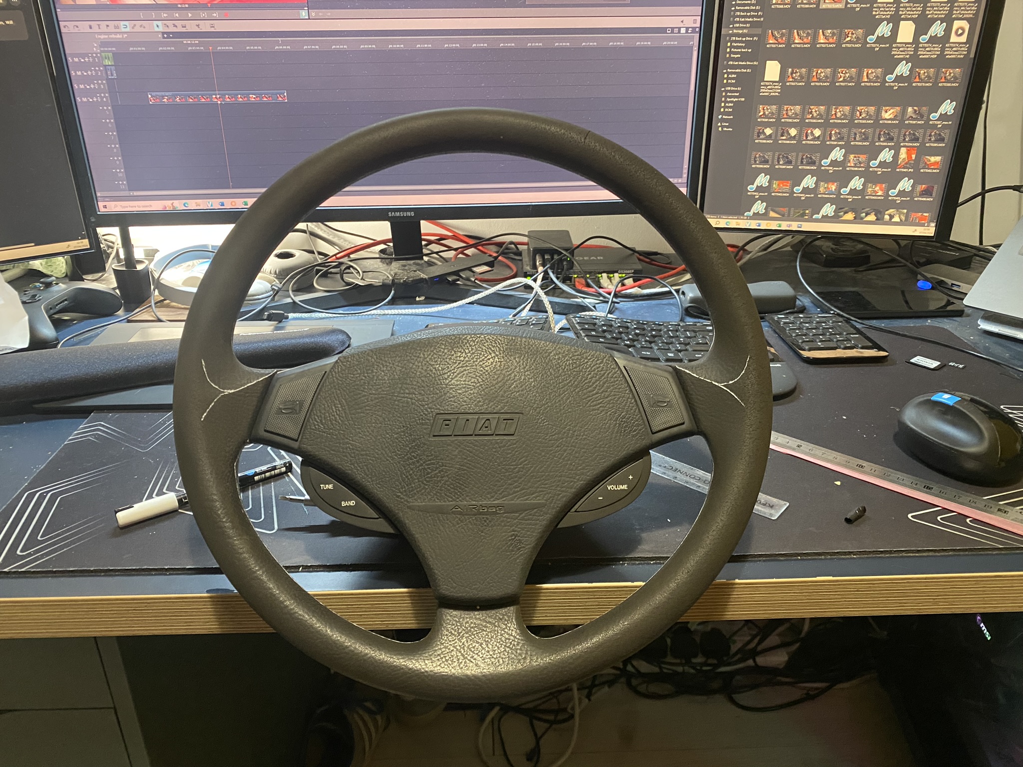

I have obtained a second steering wheel with airbag which I plan to retrim with Leather, a nice little project to undertake soon.

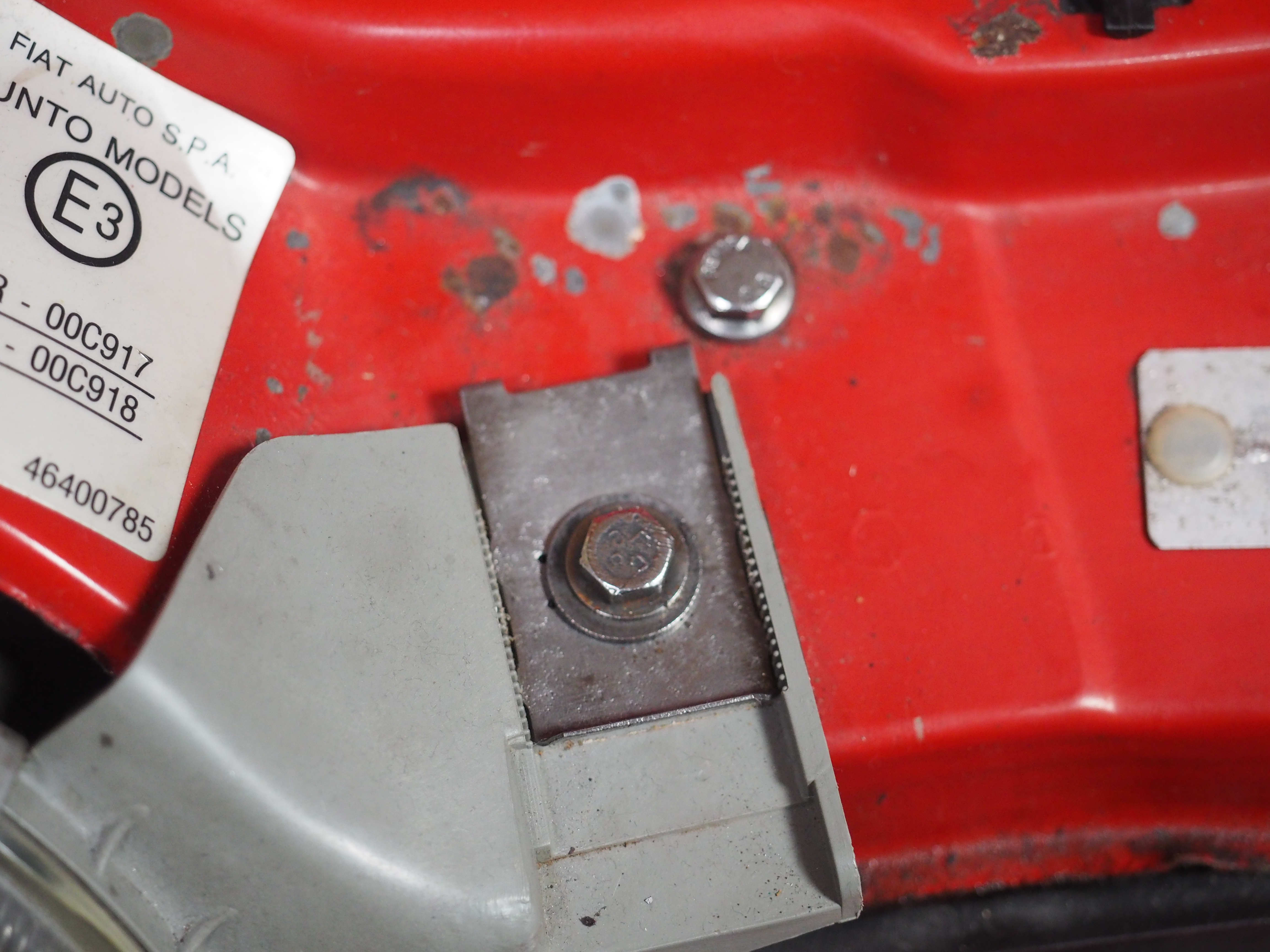

Misc metal brackets that hold the headlights in place

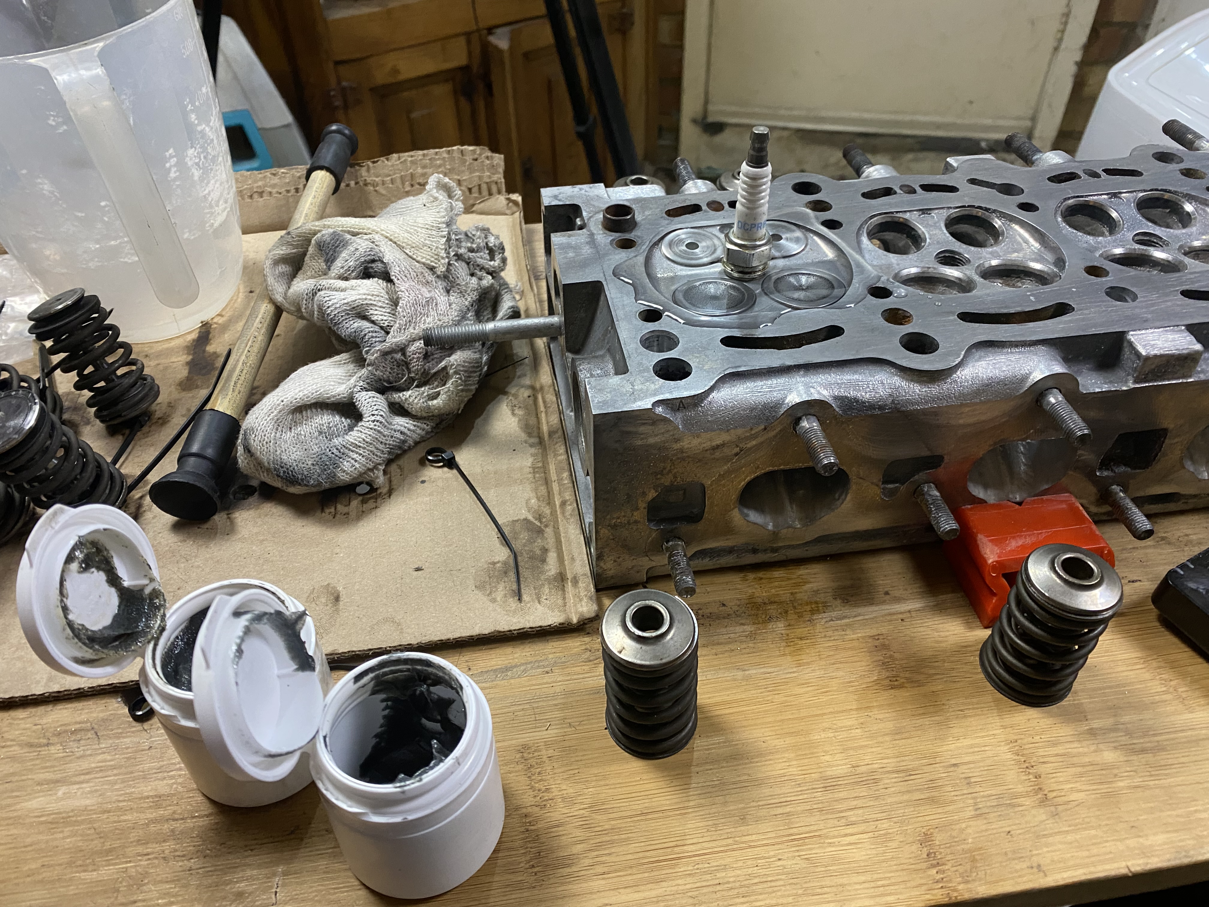

Started lapping the valves last night, only got one cylinder done but was getting a pretty good seal, put some water in the head and left over night, this
Morning a lot of the water was still there.
Was having problems with the stick not sticking to the valves, basically the valves are just too small so I’ve ordered something better which should arrive same day

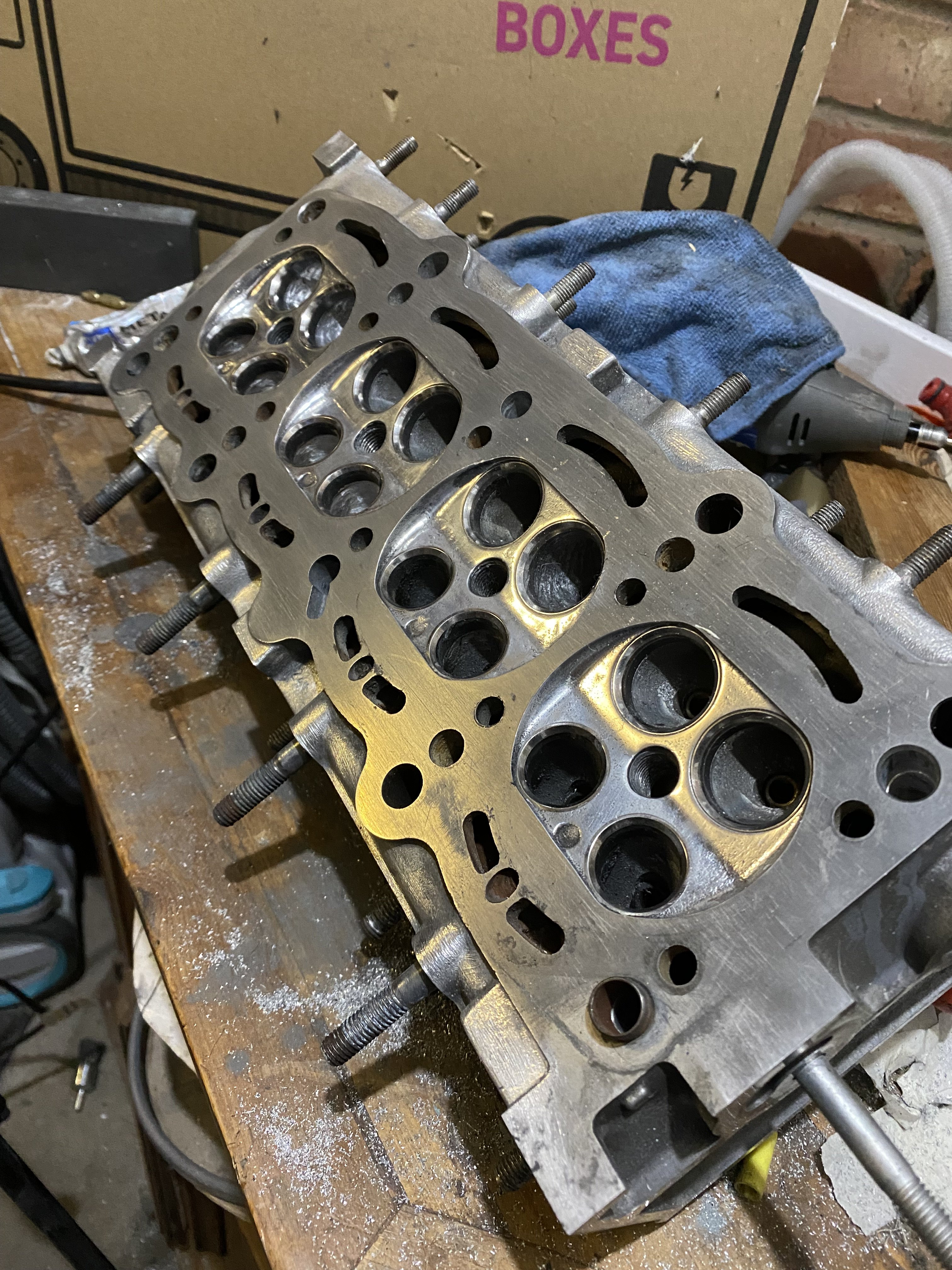

Cylinder head stripped down cleaned, combustion chambers given a light polish and the ports all given a going over to remove burrs moulding marks and anything else that will disrupt airflow.
The valves are all now clean and have been kept with all their own original parts, this engine has double valve springs which is impressive the collets have all been cleaned.
One of the discoveries is that the exhaust valves were so dirty and coked up even when fully open they would have had a considerable restriction in air flow.
They also had a about a mm of cack as were the intake valves the amount of carbon in the engine both in the combustion chamber and on top of the pistons would have massively decreased the displacement, airflow and increased the compression ratio this is probably why I was getting such high figures on the compression test
