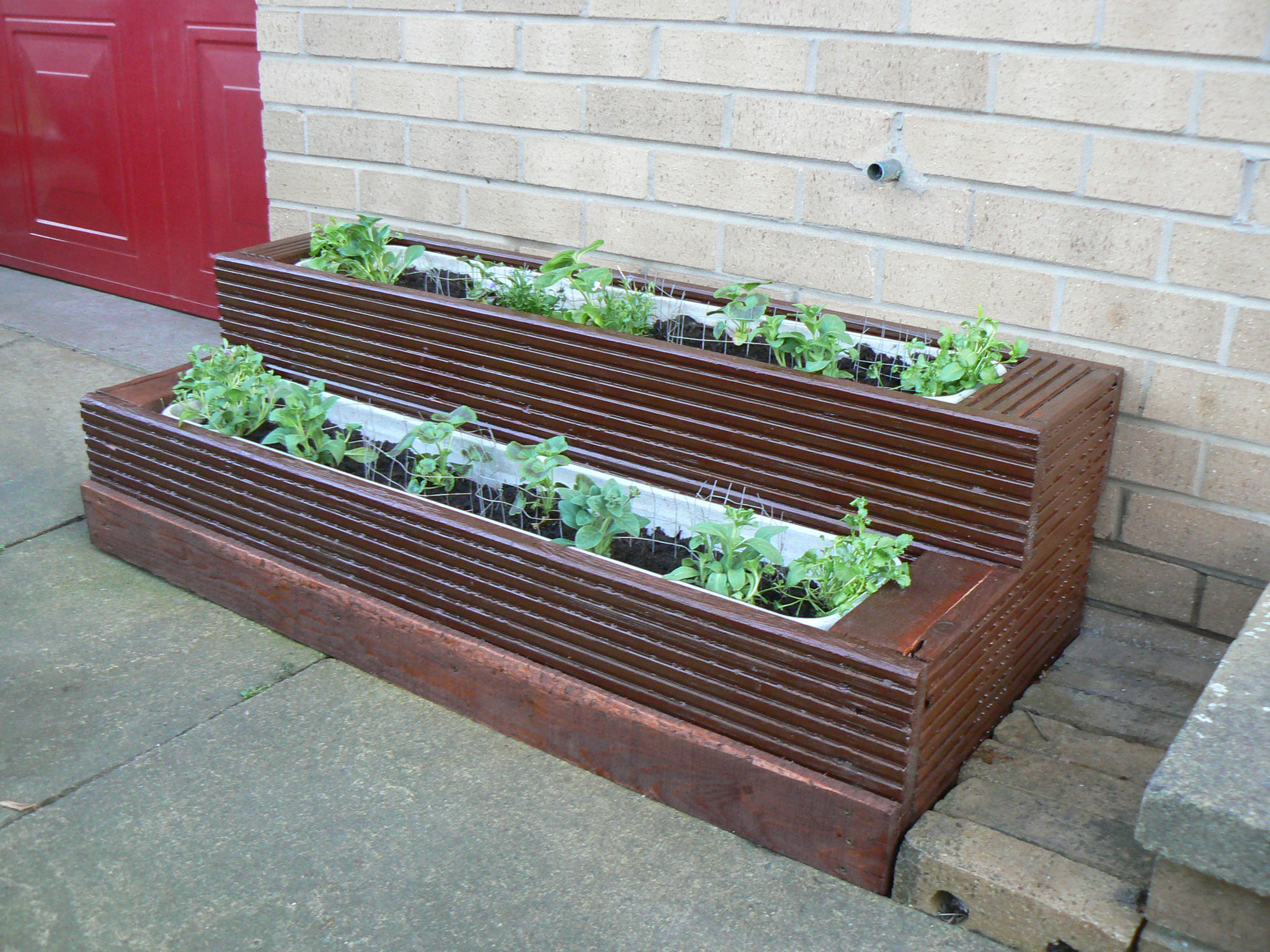

About 10 years ago I "rescued" a couple of trough planters and built a tiered display for them out of off cuts of decking. Last year I noticed a fair amount of rot in the timber so knew something would have to be done this year. I decided to dismantle most of it and rebuild using some of the timber I've got stored for a "rainy day". Getting the rusty screws out of the bits of wood I wanted to reuse without damaging the wood was what took the most time then cutting back to good wood and letting in new bits and replacing the bracing. Started around 10am and finished approx 3pm. Looks pretty good I think:
On reflection I'd have probably been better to just scrap the lot and make a new one but I think what I've got now should do a few more years and I got a lot of satisfaction out of doing it!
I also have 3 half whisky barrels which I use as planters and they are also in poor condition but I don't think I'll try to repair them.
