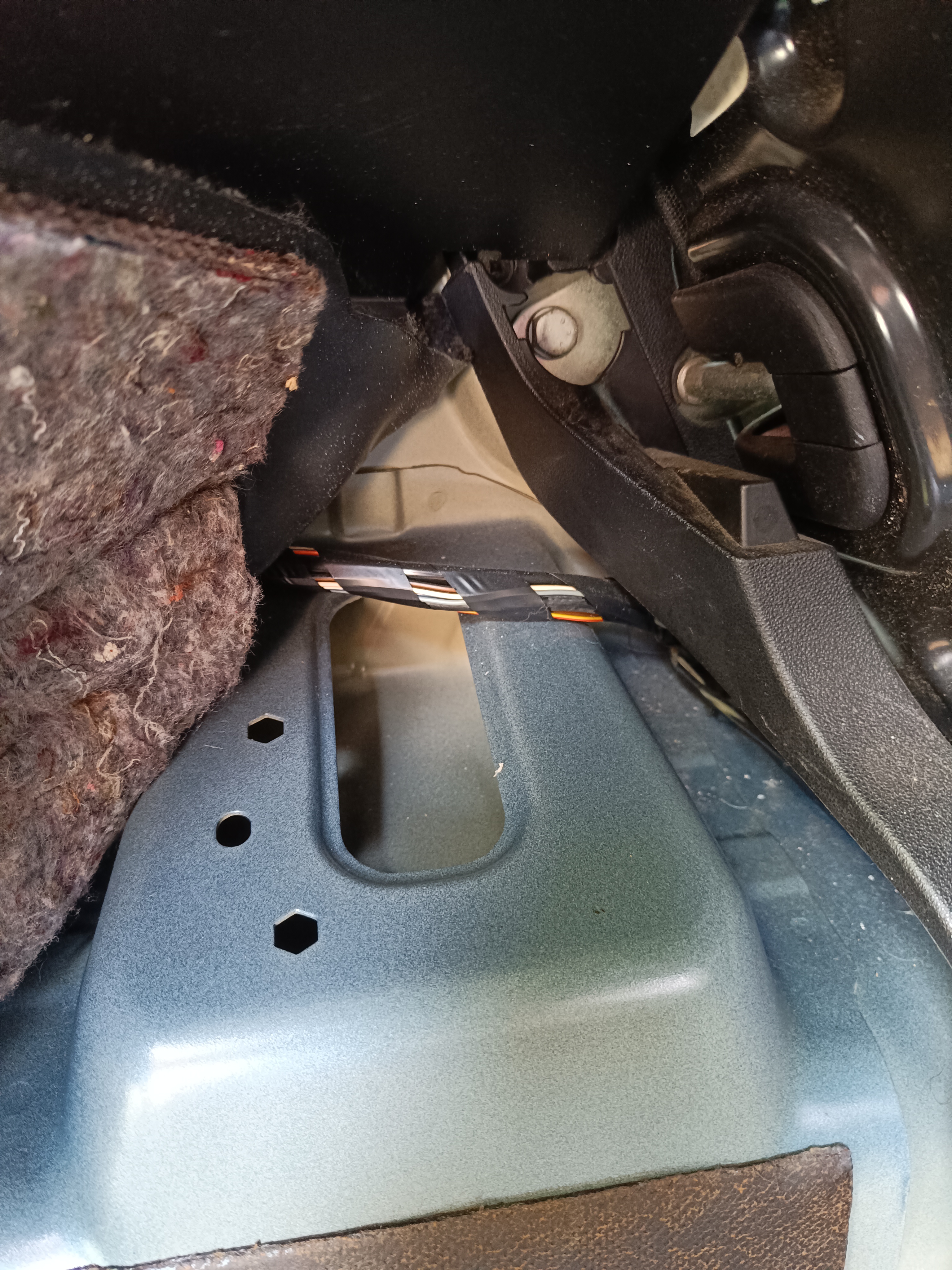

Look into the axle mounts, the nuts (welded inside the body - pictures in the link), if there is a rust.

I think you're right, there is rust in the shock mount threads!
I cleaned the bolts and got rid of that rust, but didn't clean the mount threads in the body of the car.
I can't access the mount threads directly, this car has a metal panel blocking my way, but i'll re-do the job tomorrow. Thanks!

Is it possible there is something in the body of the boot that is loose?

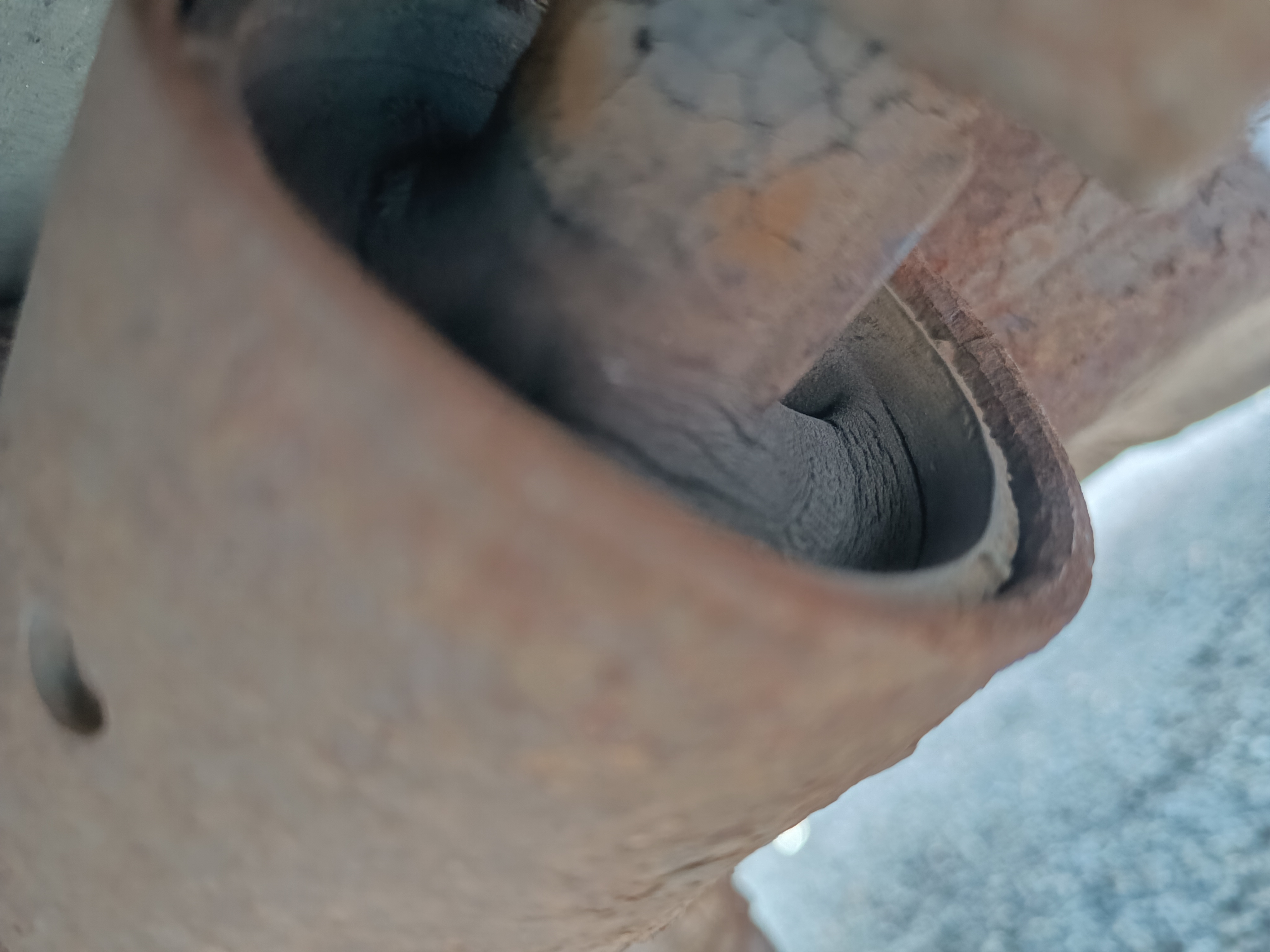

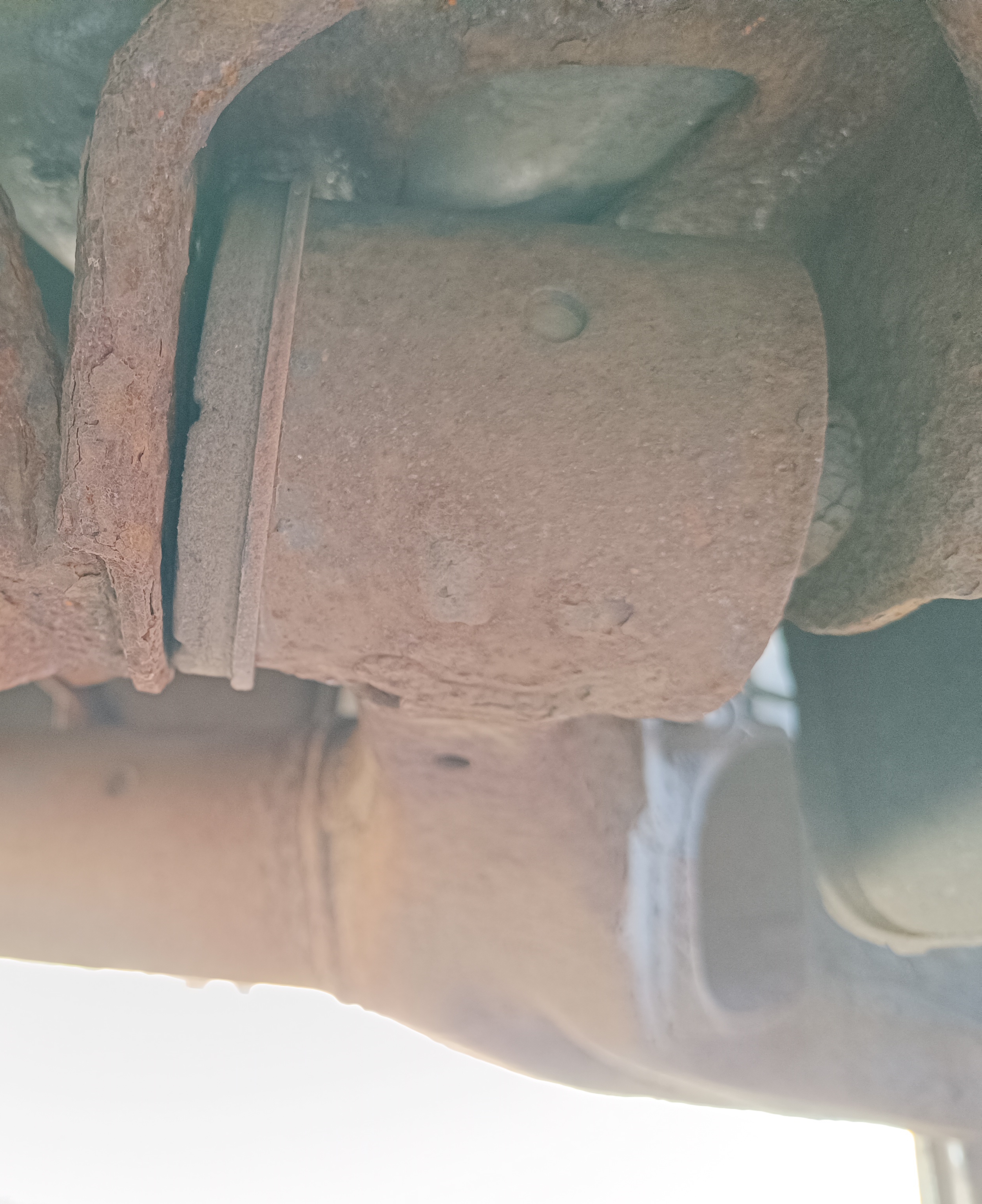

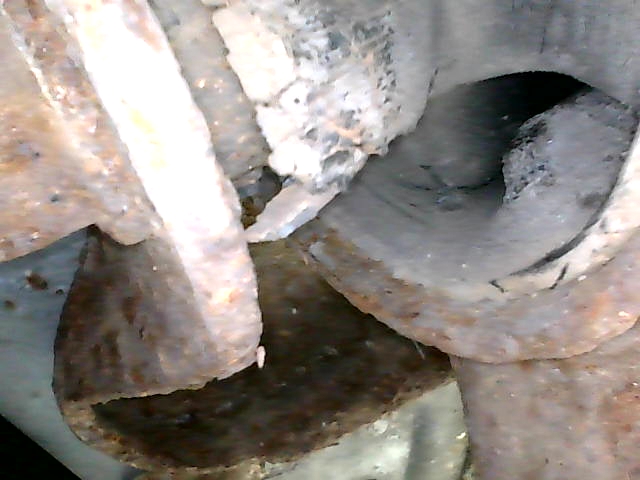

I took some pictures of the axle bushings, they look OK i think?

Bushings are old, but still holding up (kind off). But the amount of rust is not "OK". It should fail the MOT.
It had an advisory for rust on the rear axle.

looking at the general state of the axel in those photos I would be inclined to take it off and attack it violently with a wire brush on a drill. The whole thing needs cleaning up and a new coat of black paint. In doing so I’d replace those bushings, they look shot to me. It could be the forces that the old shocks were not resisting are now being pushed into those tired looking axel bushings.

I had a closer look at the axel bushings and one of them is a bit frayed at the edge where it covers the bolt, but the rest of it seems ok. I've still not given up hope it is something else because I think the job of replacing them would take me too long.
