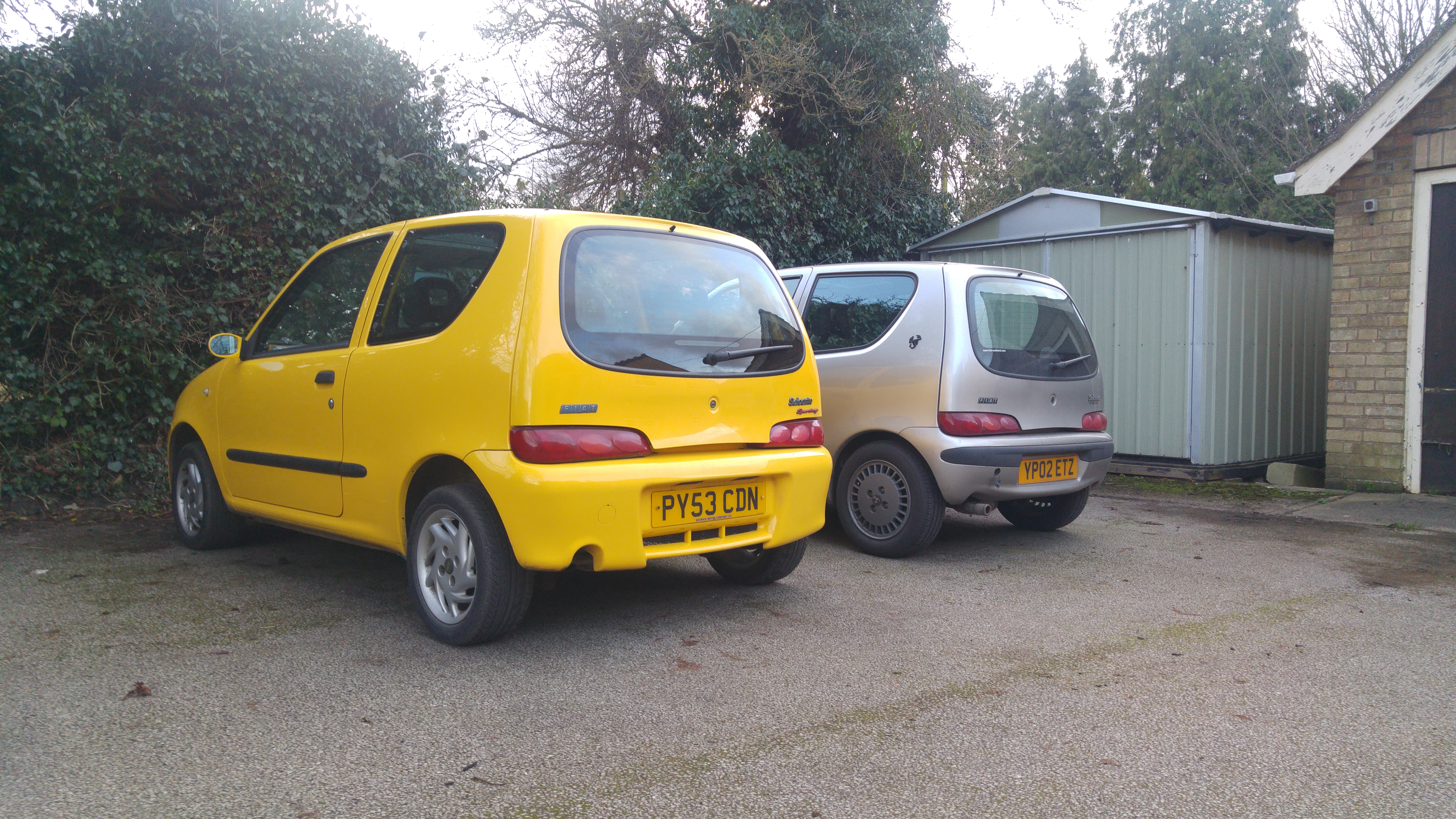

It's a Seicento, '53 plate MPi, Sporting, in Yellow. You know the type...
Well, the little yella fella has just come back from a date with the MOT man with a fresh ticket and a clean sheet so thought after 2 years plus of owning this now, and a little silver SX before that, I might venture out into the Cinq/Sei section for a change of scenery since the Panda classic forum is a bit tumbleweedy now and Grumbleweed's been laid up for about 3 years with no sign of me getting round to learning to weld.

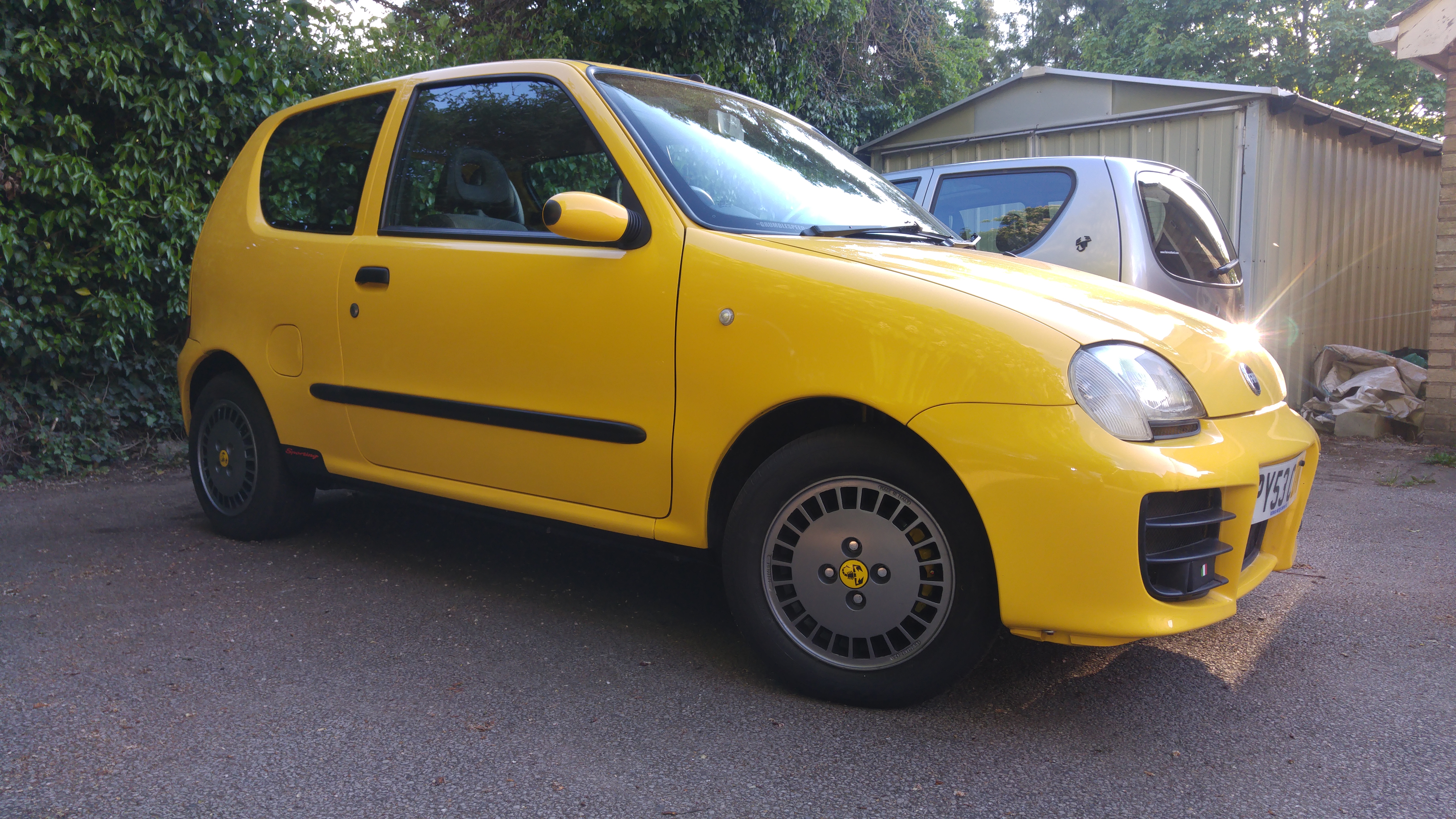

So this is mine today:

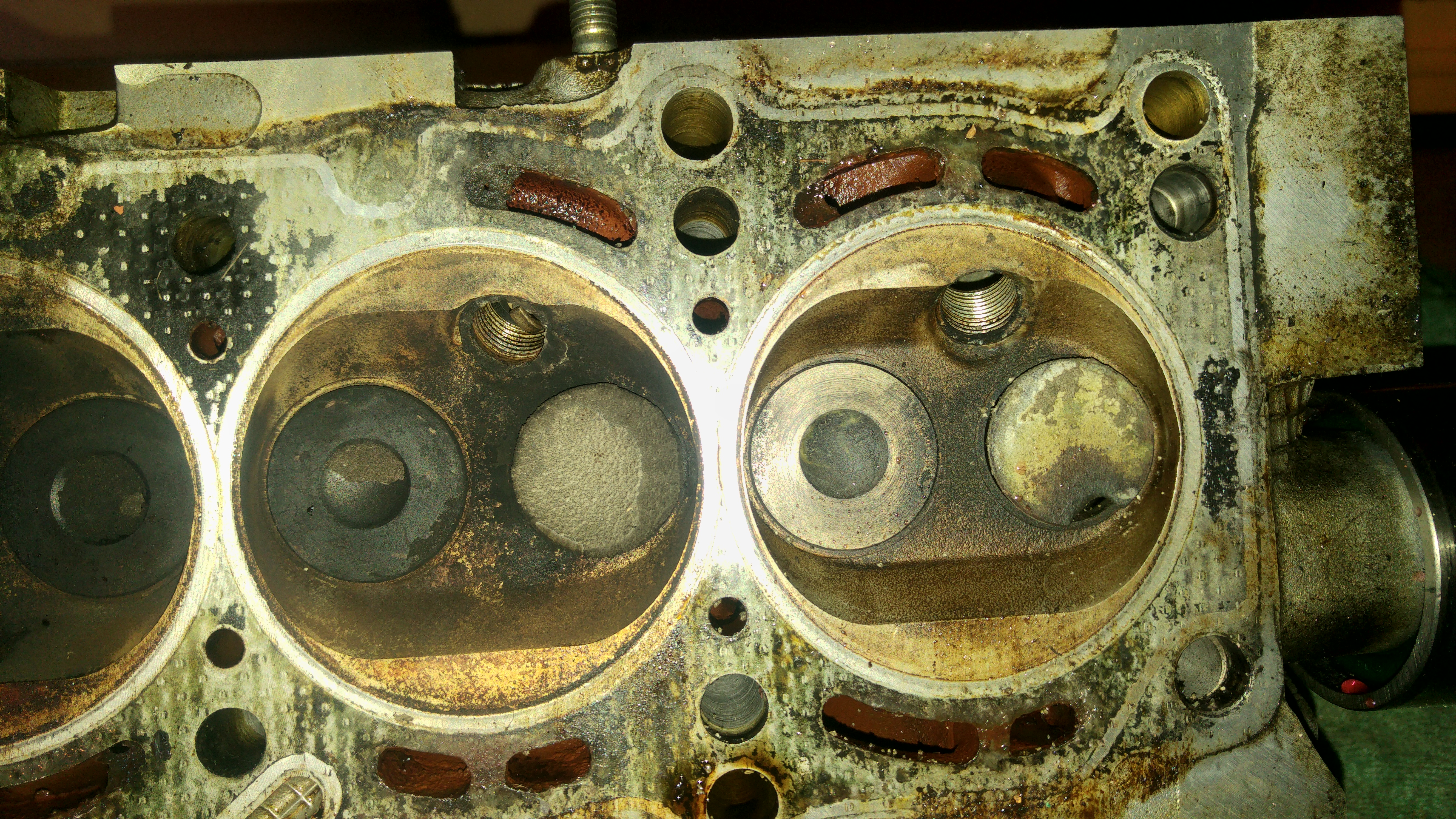

I bought the car back in Feb 2020 (remember that!?) and it provided me with hours of "fun" in lockdown 1 when it blew a chunk off the edge of a valve after I'd had it about a month.
As it arrived. That's the previous one wearing the lowering springs and wheels that went across shortly afterwards.
And the state of play first week of lockdown:
Fortunately given the state of the world at that point, I had absolutely everything I needed to get the car back up and running laying about in the shed, pinched the valve out of a spare panda head I had sitting, keep a head gasket set and bolts in stock just in case, oh and this 866 cam I'd never got round to putting in anything and a decent stock of shims to get it all set up right:

Is the Panda wearing alloys or are those hubcaps? That style look like they'd go well on my Brava.
They are Mk1 Punto alloys, need spacers to go on the Panda because they are something silly like a 48 offset. Might be a bit narrow for a Brava too, iirc they are only a 5" I think. Wearing 165/65/14 tyres when I got them and you wouldn't want to go wider.
Ah that is a bit dinky, Brava is currently wearing 175/65/14's but don't think I'd want to go any narrower
