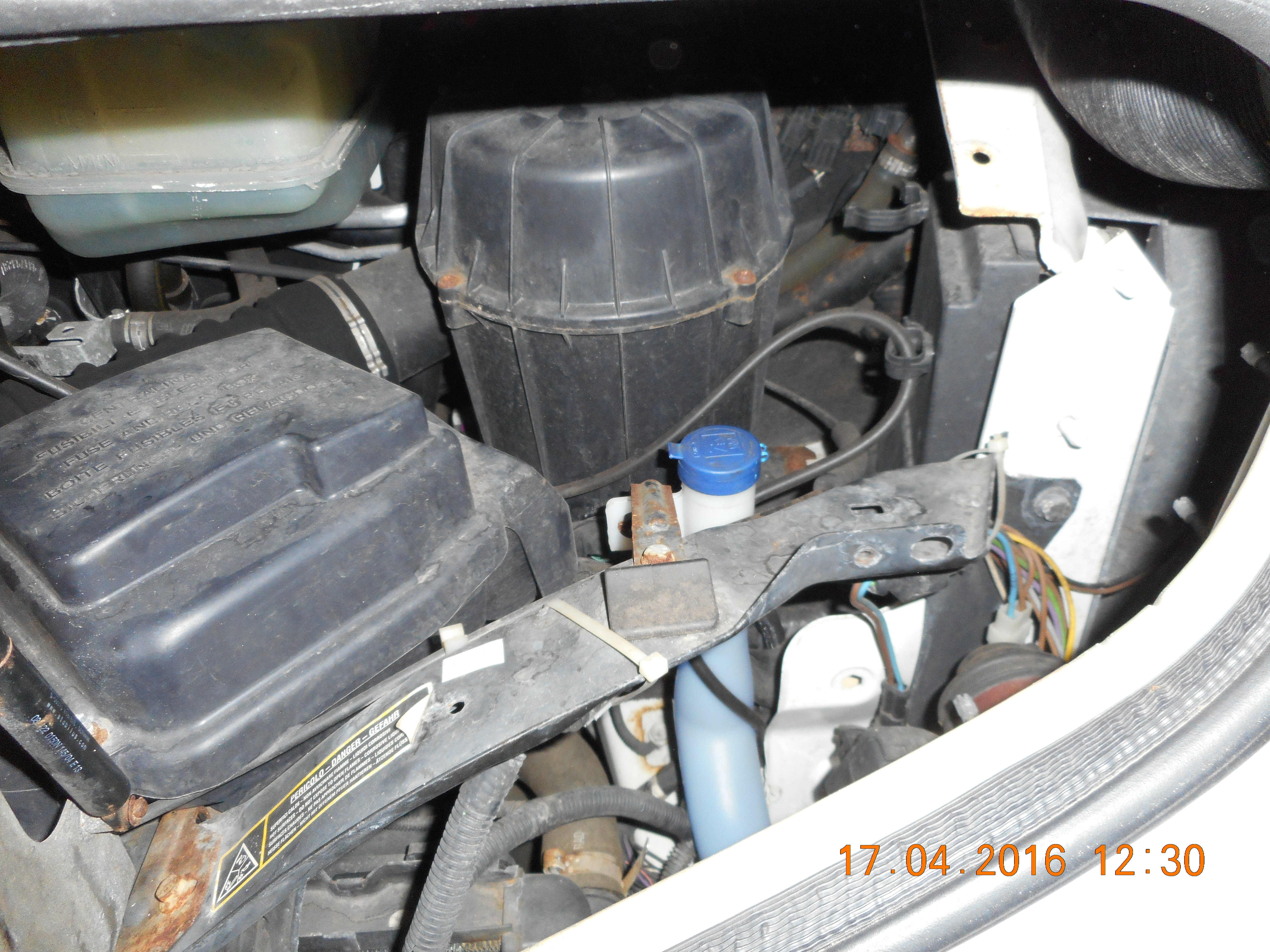

This is the air intake for the heater on standard X250/290 rhd
Wow!! That’s quite an intake. And does the air come down from the grilles on the top edge of the bonnet?
Yes. On the X250 the grills were part of the bonnet On the A class motor homes I have looked at the vehicle converter has constructed a fitting which connects to the intake which is shown on the photo, with one or more air intake hoses attached which go to the front of the vehicle to collect the fresh air.
The photo shows the X250 scoop, the X290 is similar.

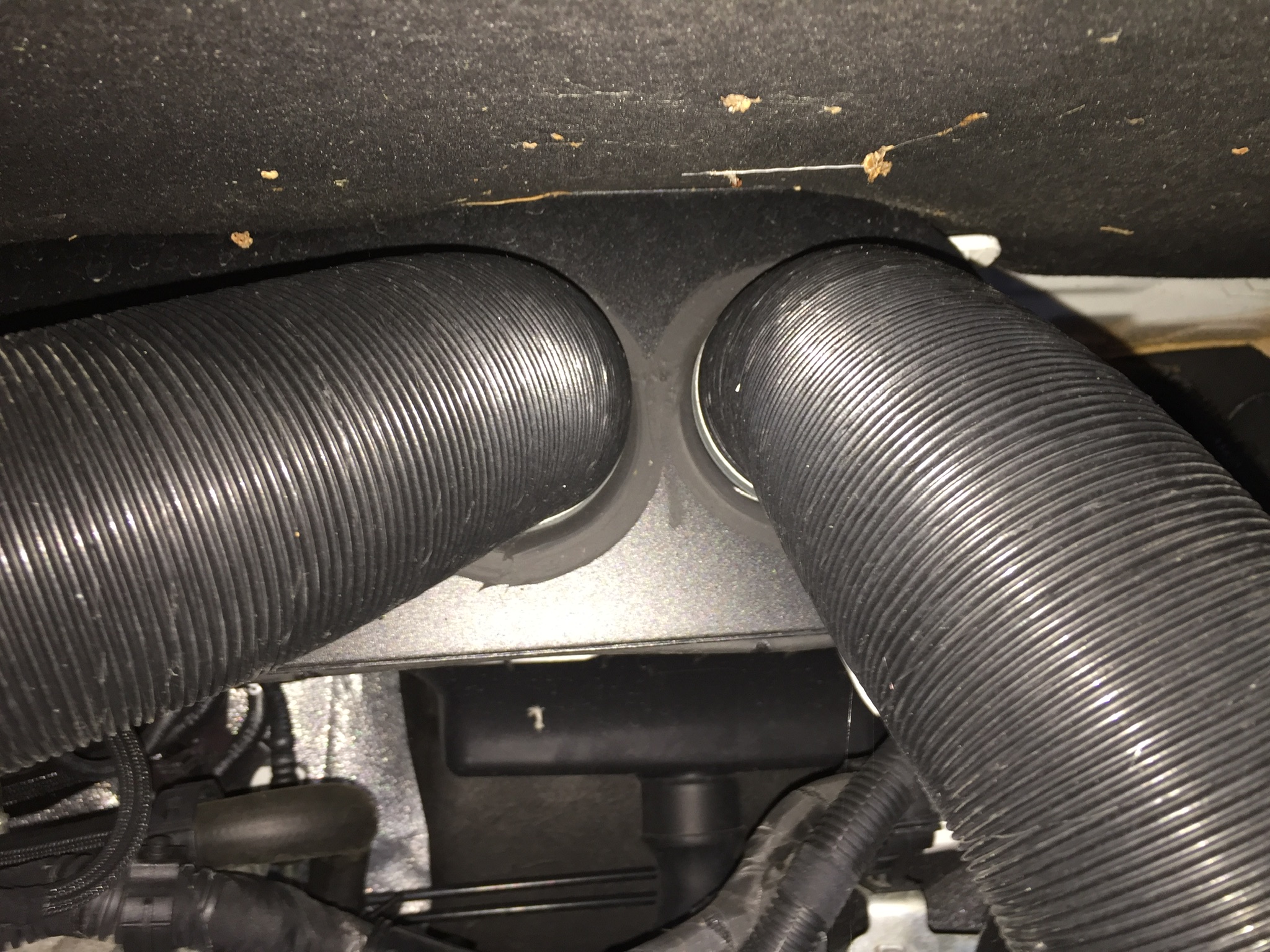

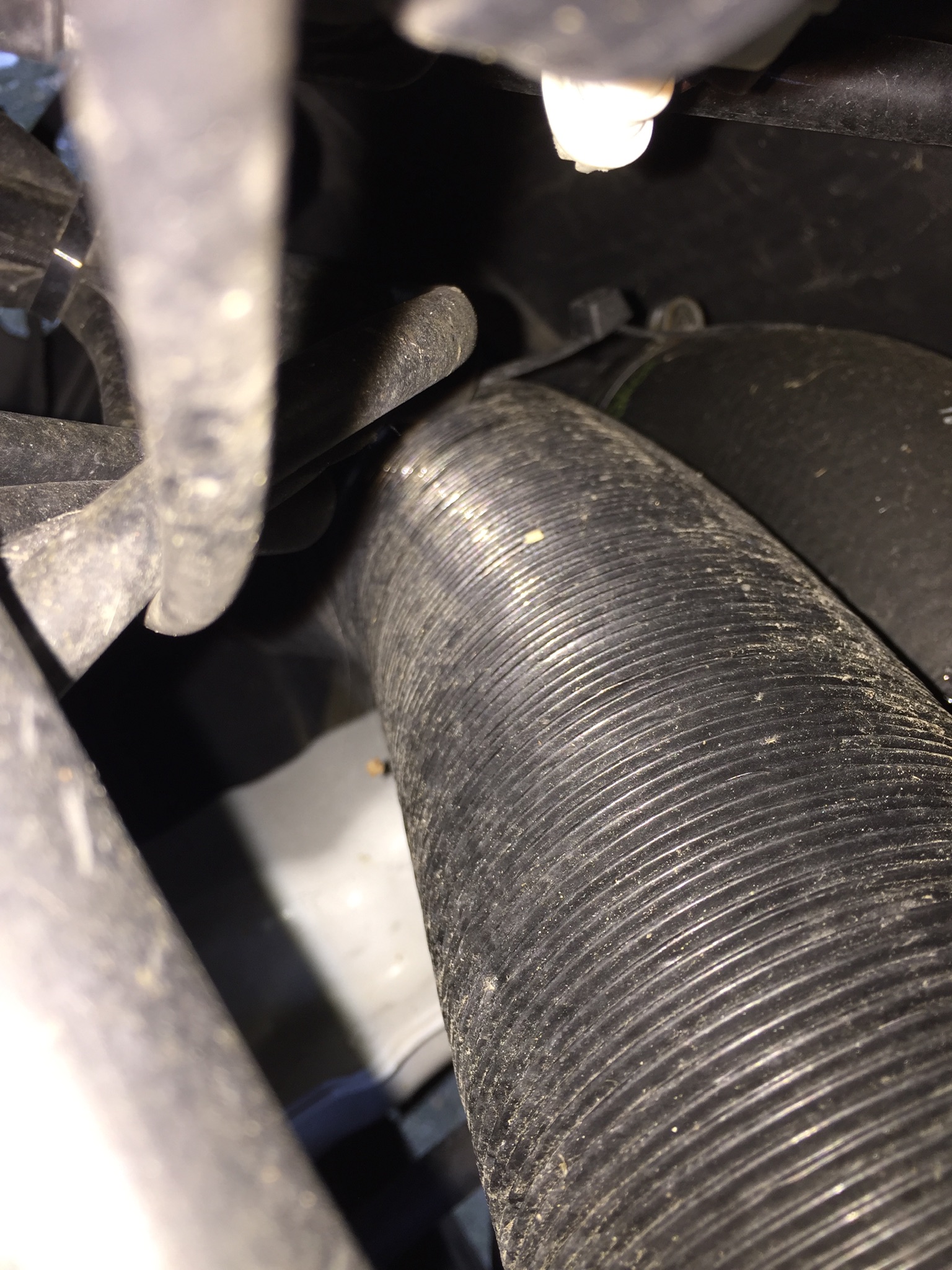

I’ve now managed to get my head under the bonnet and have discovered a large plenum at the top centre behind the engine with two 100mm flex’s tubes coming out and then going out to behind the headlights each side but the ends point straight down and have no direct access to air ram when moving.
I think these could be re-routed to finish pointing out of each side of the Carthago front grille. Water getting in would not be a problem as the plenum is quite a bit higher than the front grilles.

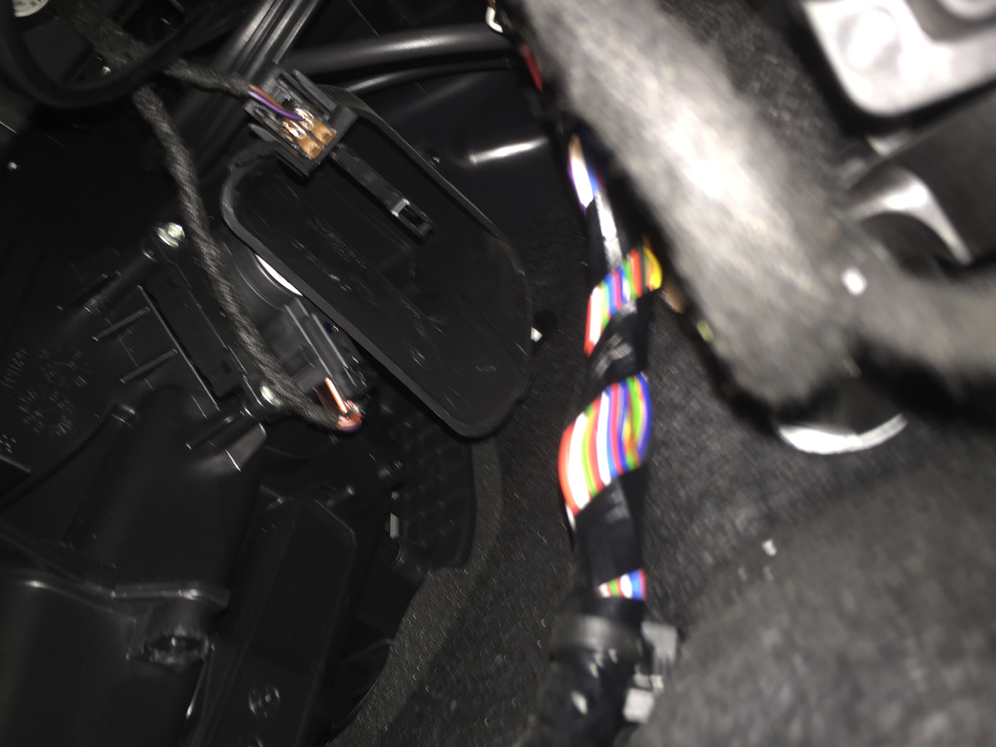

BTW, this all started because my feet were always cold and I discovered that there was no heat ducting to the drivers footwell! This apparently is only applicable to RHD comfortmatic Fiat chassis. Because they fitted a footrest due to the lack of a clutch and this blocked the air flow. To fit this they removed the bottom section of the drivers side ducting. I’ve now fitted some ducting to this outlet and routed it down around the steering column to exit pointing down on my feet. Whilst fitting this pipe I noticed some wire terminals on the piece of ducting left behind the heater unit. You can see them in the attached photo. I’m starting to wonder if this was connecting to a heater temperature sensor fitted in the output ducting that has been removed. Wish I could get hold on a workshop manual.
