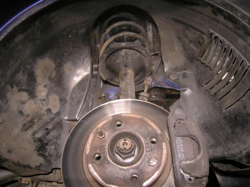

Jack up the Seicento and remove the right wheel:
The spray tank and pumps are located behind this grill:

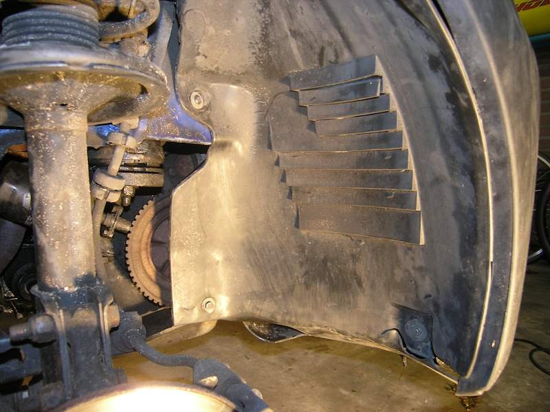

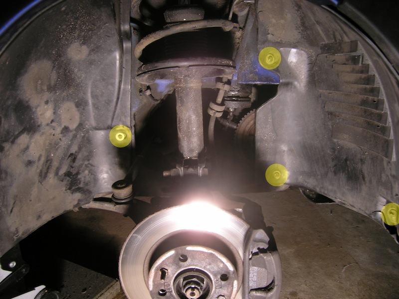

Remove the following 4 highlighted bolds:

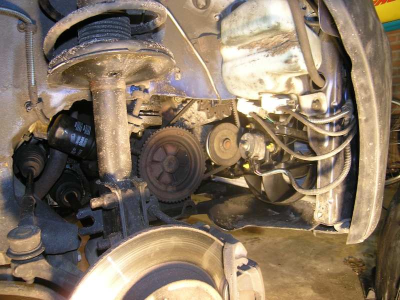

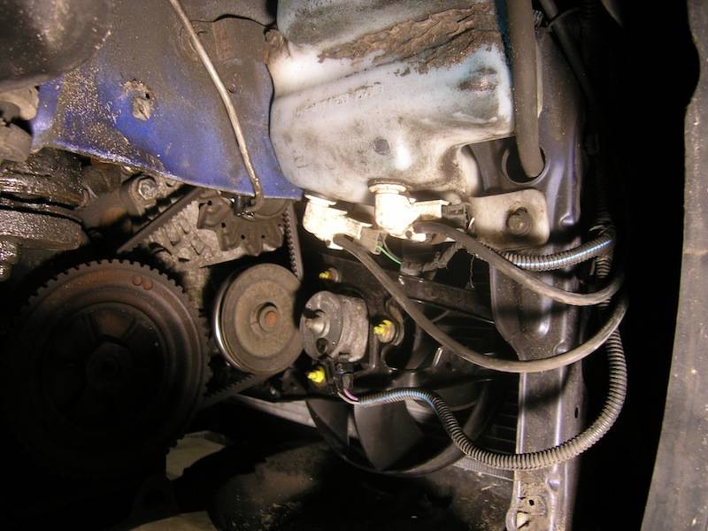

The left pump is for the front, the right one for the rear:
