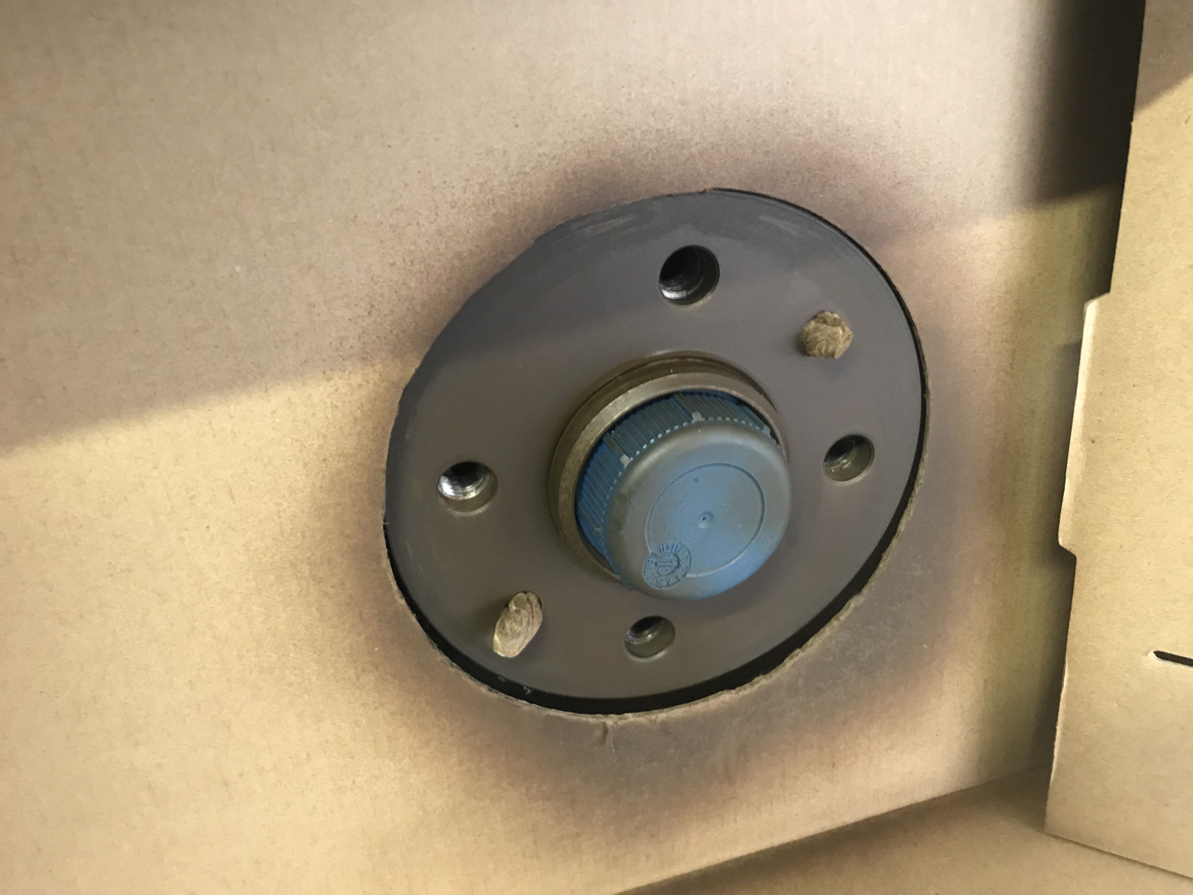

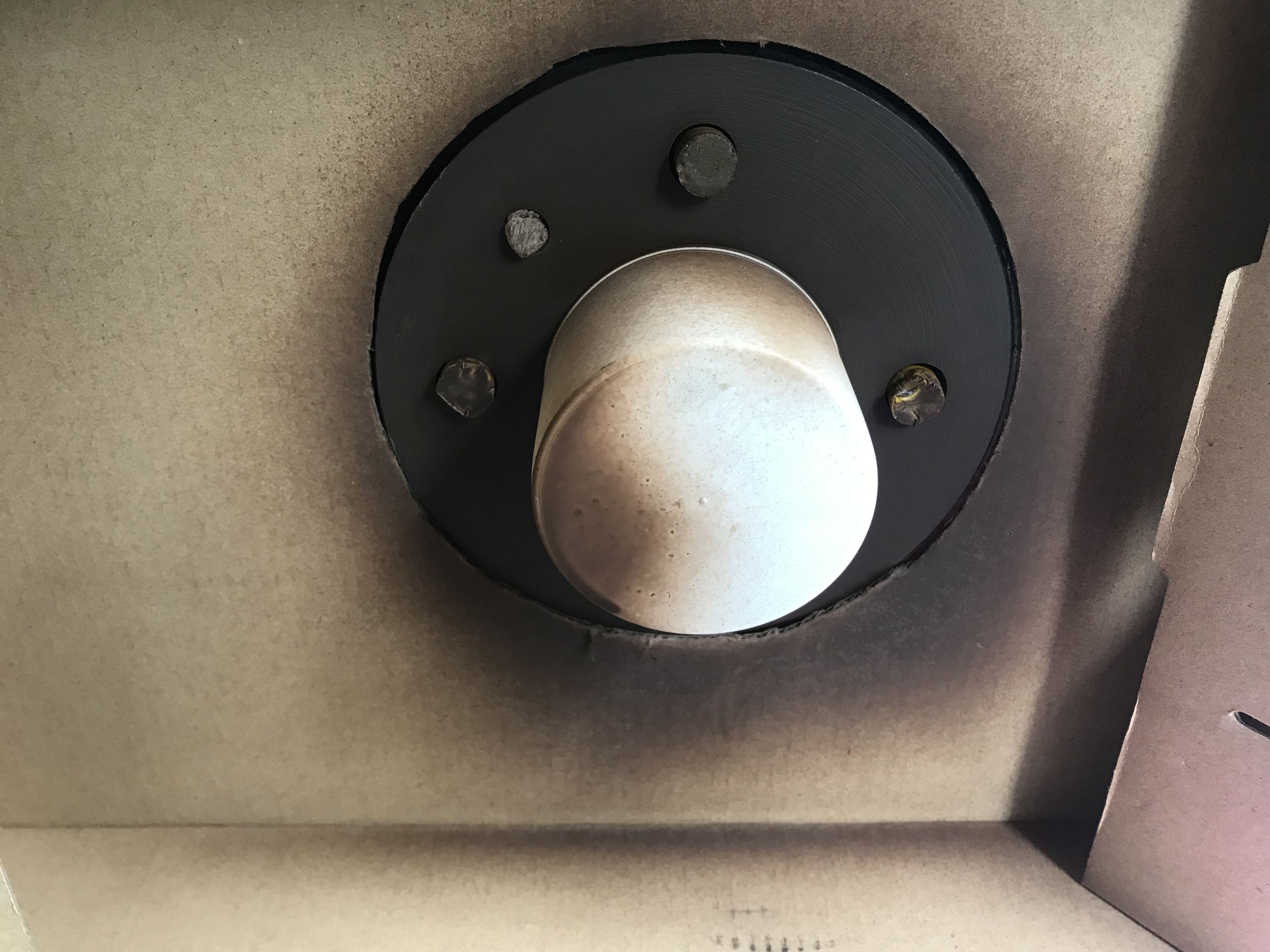

Rust prevention of the brake drums and disks under the wheels with Hammerite rust prevention primer. There was already quite some rust that had to be brushed off.
Nice find: outside the wheel area, the brake drums are already coated with black paint (or powder coat), so this should keep them rust free for some time.
The front wheels will get dust cover caps for the center nuts where rust is already growing fast. The back already has those.

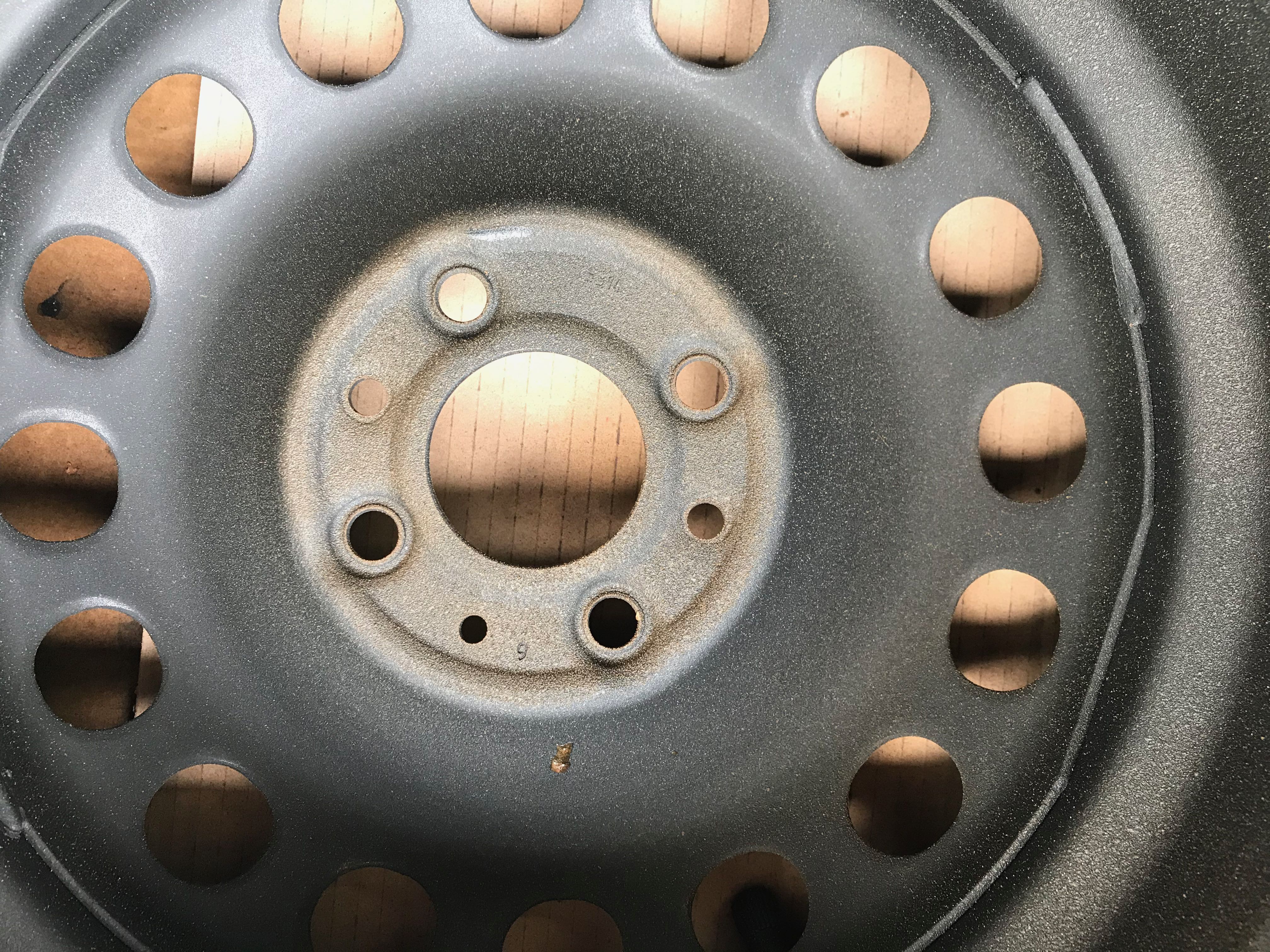

The wheels got a spray wax cover on the inside, too

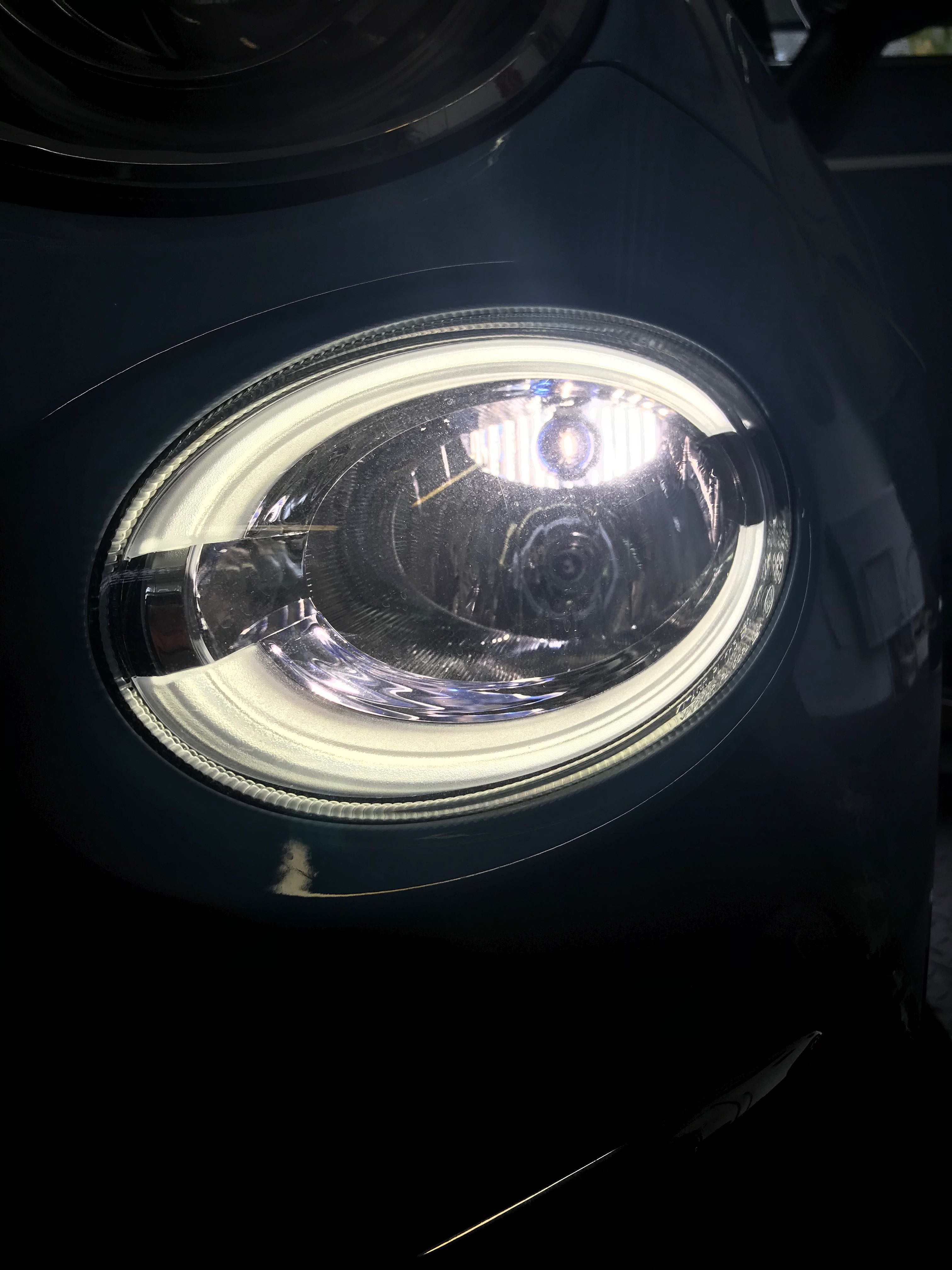

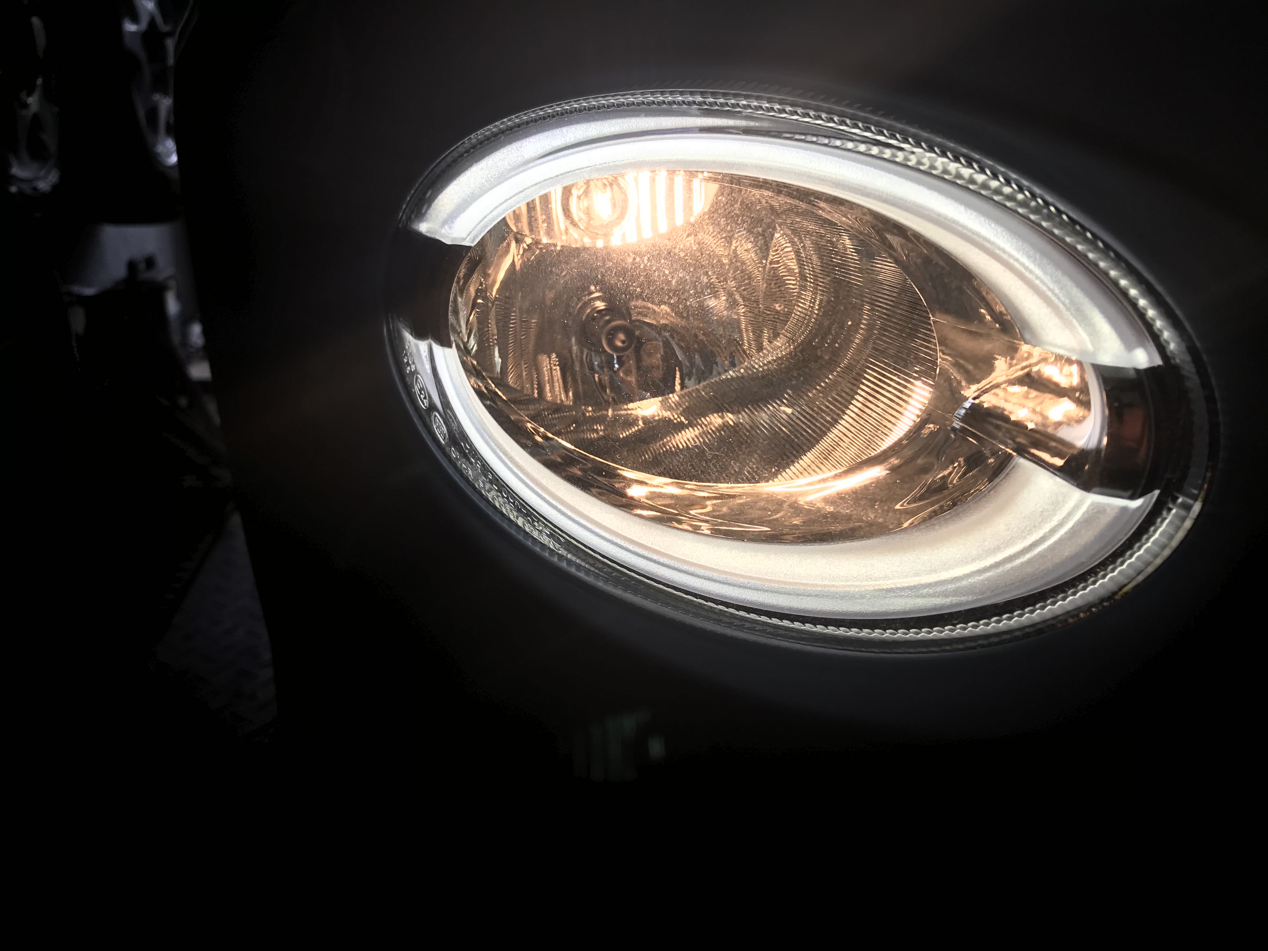

While the wheels were off, I took the opportunity to change the DRL bulbs. My interior wings don´t have the service hatch (good, I can´t lose it...), so it requires to remove the lower screws of the inner wings to get inside to the lamp housing. Had a good laugh when I saw the horn :D That´s another thing to consider for an upgrade.
It is still narrow inside, and (as we all know...) the whole lamp housing setup is a pathetic misconstruction. And I have fairly small hands. Nevertheless, I managed to swap the bulbs for "blueish" ones, looks much better with the LEDs around them. I know they may not last that long, we will see...
Before/after:
Interesting find: on the newer models with LED rings, there is no pilot light any more, the DRL bulb is a 21W single filament only. The dual 21/5W I put in still fits in the socket, but next time I can buy the simpler version

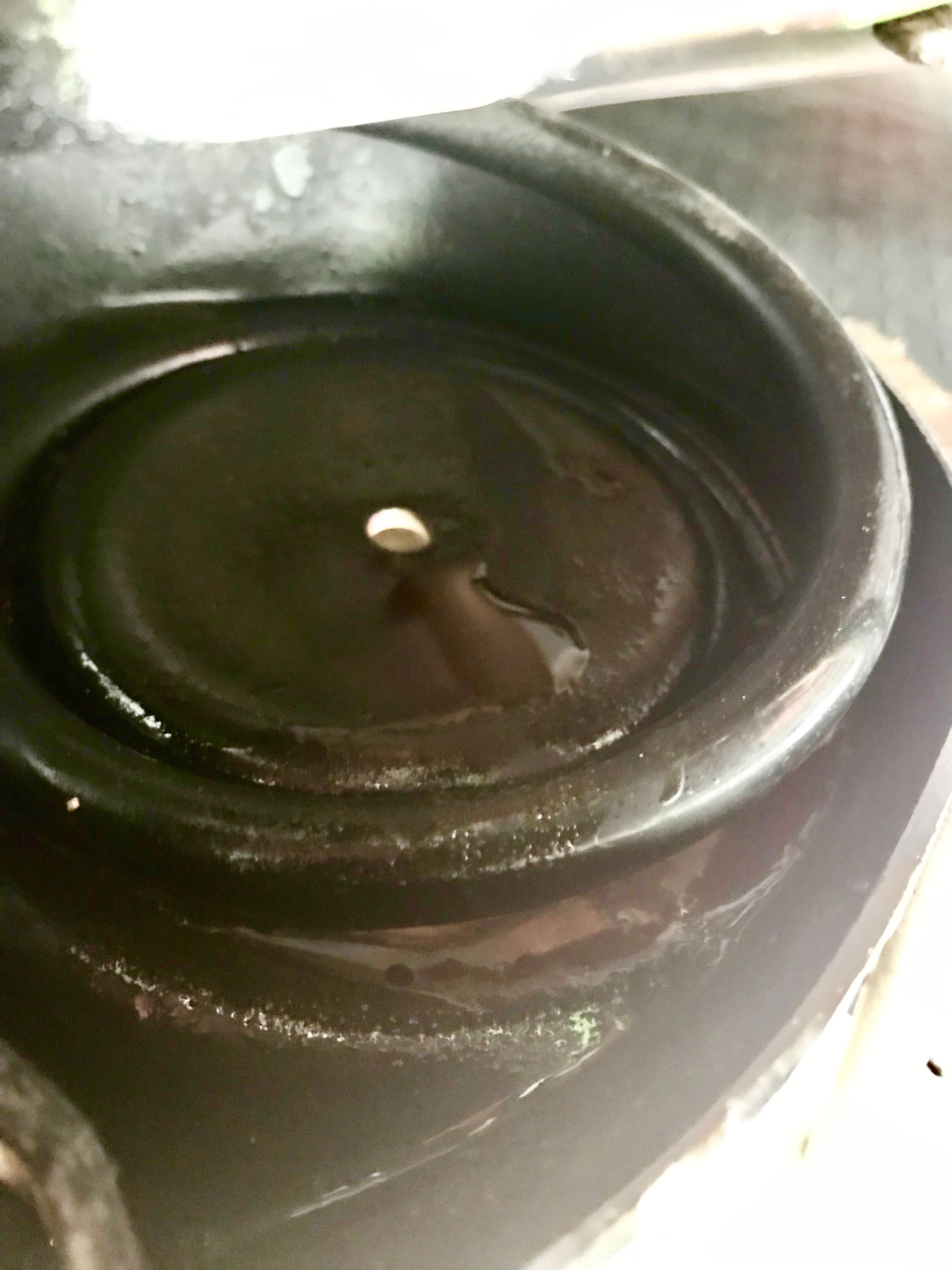

And while the rear wheels were off, the rear axle spring seats got a good flooding with wax fluid that will hopefully prevent early corrosion.

IIRC then it is not reccomended to paint the mating surface where the wheels come into contact with the hub/drum/disc, as the paint may get eroded away and then the wheel nuts/bolts may eventually become loose!
To ensure the wheel is easily removed next time ( after a winter season for example) it may be prudent to just apply a light smear of copper grease to the contact area of the wheel.

The paint layer is very thin, so I don´t see an issue there. The wheels get changed on a regular basis anyway. I will see what it looks like after the winter.
Grease or wax is certainly an option, but I did not want greasy stuff too close to the brake pads.
Before/after:
View attachment 204068View attachment 204065

What a great job well done!! You have inspired me!!! What bulbs did you swap for? Were yours not double filament?
Thanks ;-). The original bulbs are single 21W, Probably because of the LED rings that replace the pilot light. The replacemant bulbs are "xenon" type, which has nothing to do with xenon, just a blueish coating that makes them appear white. Just search ebay. It would be even nicer to use LED bulbs, but they are checked by the control unit, so need load resistors. Too much hassle in the small space that's difficult enough to get to anyway.

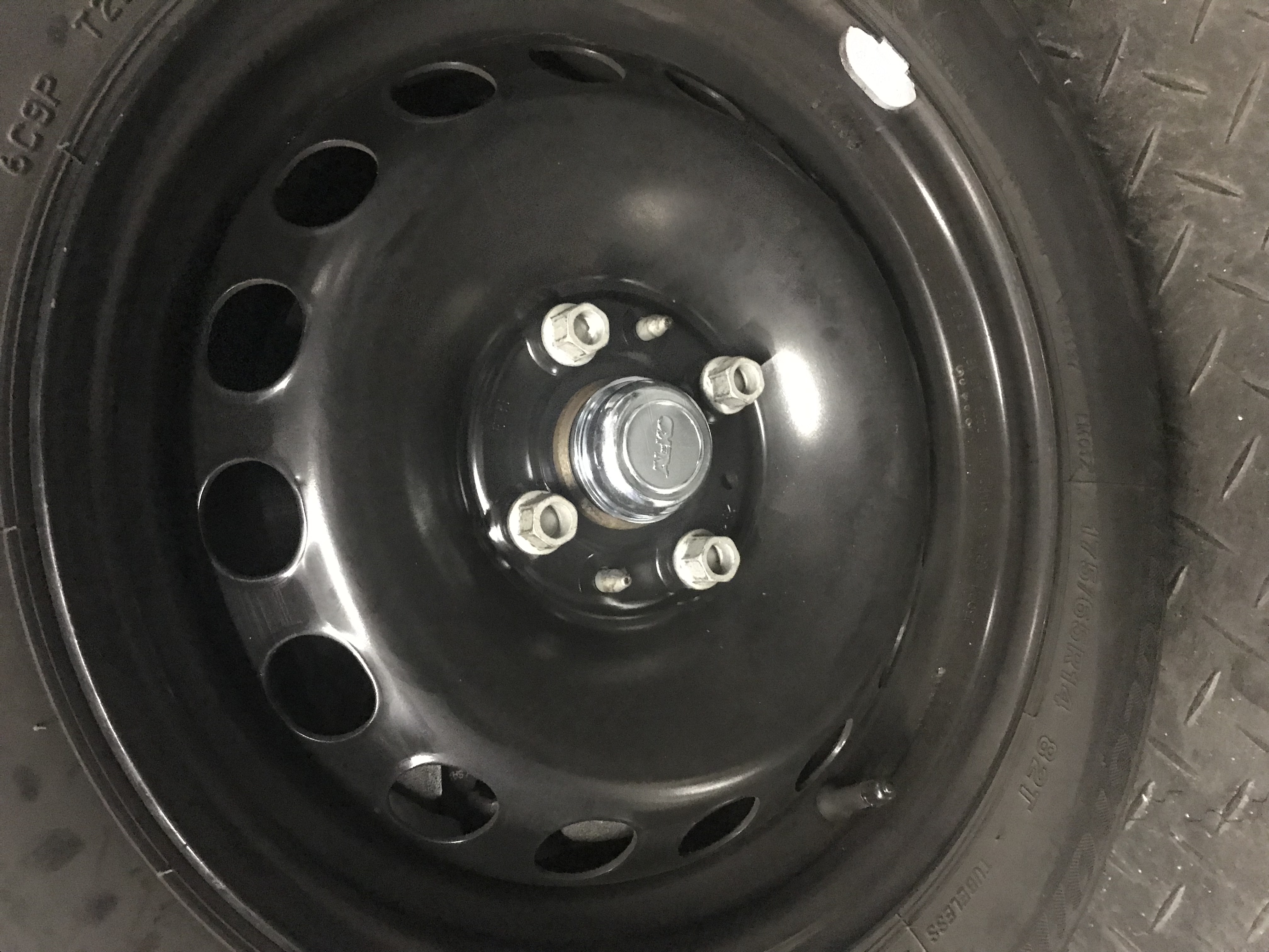

Greasecaps for the front axle. 50mm, tight fit, needed a few careful whacks with a mallet. Won’t stop corrosion, but makes it less visible..
10£ a pair
