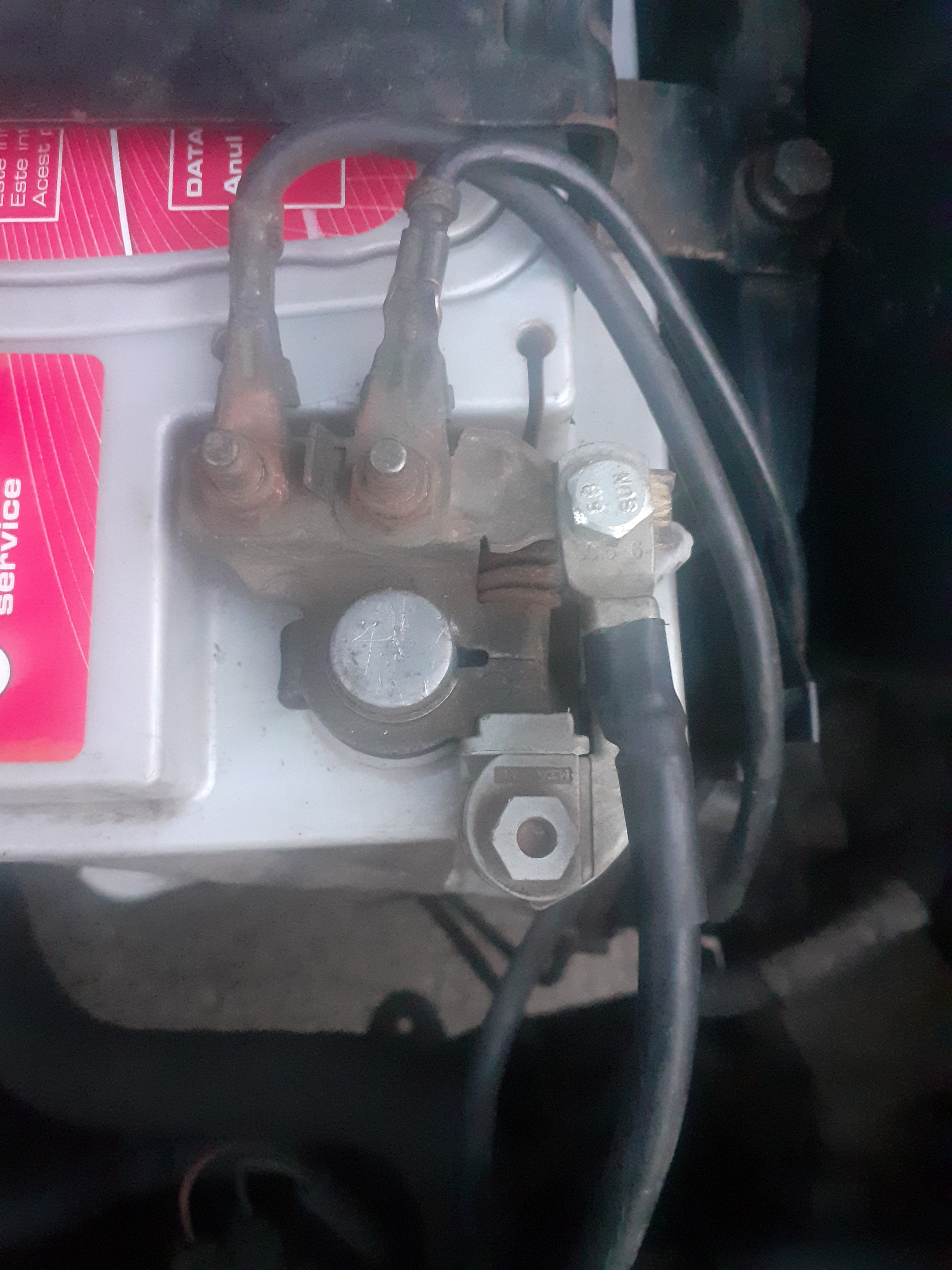

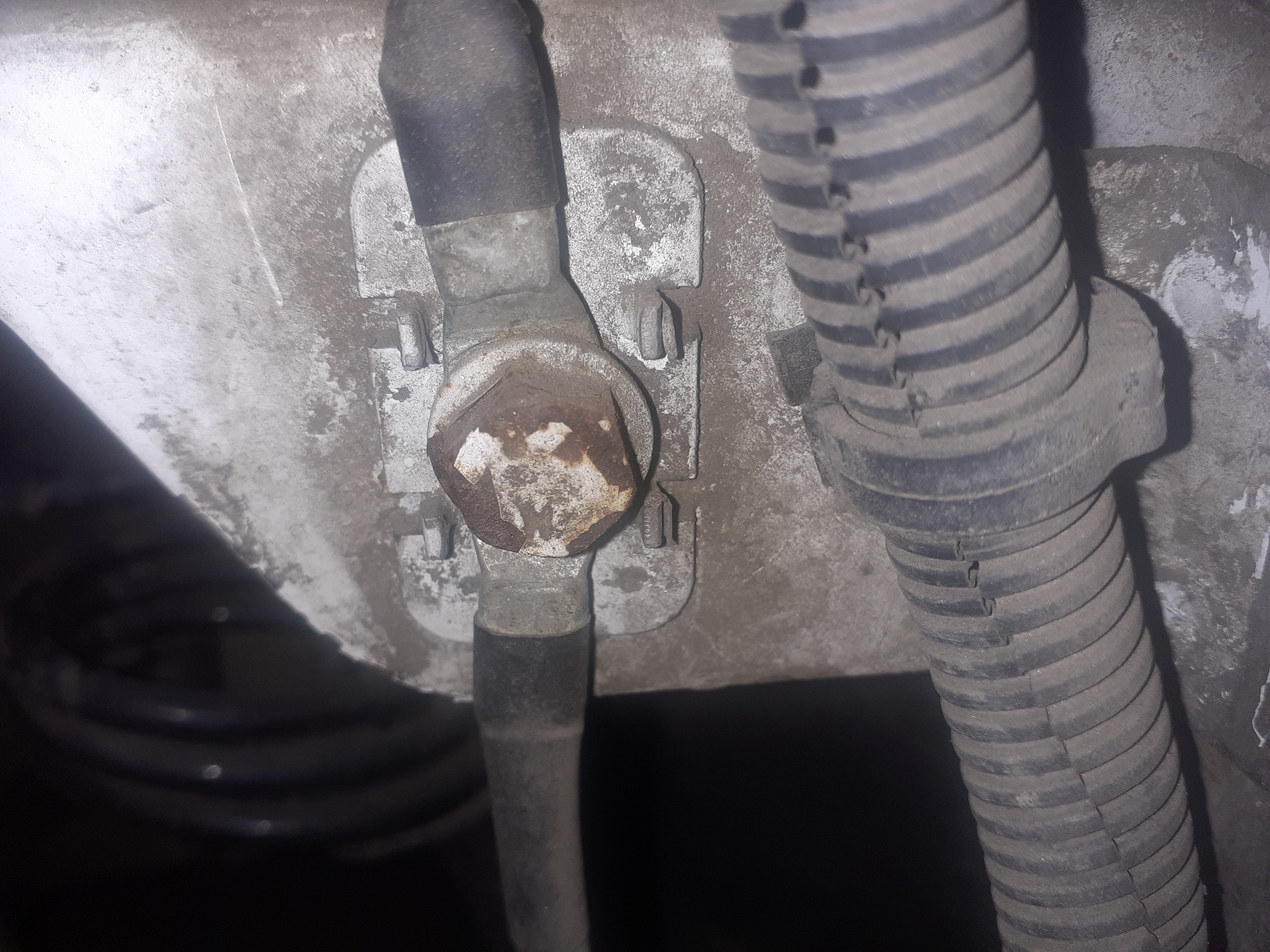

For ground connections, there is an easy and effective way to test them, using a multimeter. You read the voltage on the battery, then keep the (+) probe on the battery and put the (-) probe where you need to have goog ground. Now, if the voltage is the same like direct battery reading it means ground is good, if voltage is less, ground is not good. I had more than 1 V less on the chassis and on the gearbox, therefore I replaced the ground cable. I used a DIY new cable, actually made it from 2 pieces because on the chassis, about half of the leads were cut, broken. So I bought from an electric shop cable, connectors and thermo retractable isolation, made new cables and placed the 2 connectors one on top of the other, on chassis.

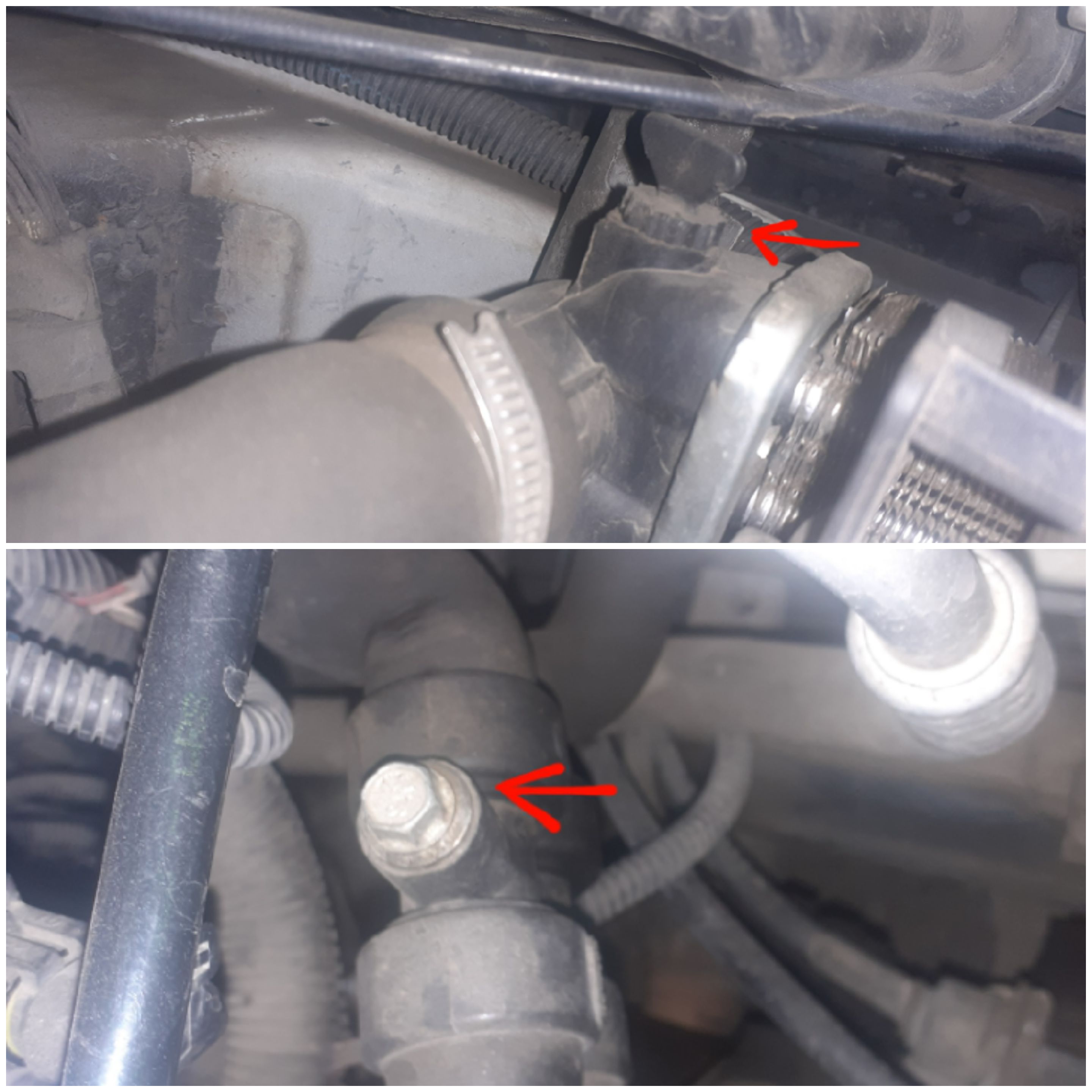

I mean you can take them down completely when the engine is not running (2nd faze of bleeding) cause that way air comes out completely and fast. When is cooler on top of those hose, you can screw the vents back, first the one on the radiator, secon the heater one. I even have a picture of them, so I'll post it here. The heater vent on mine is also a DYI, cause the original broke.
