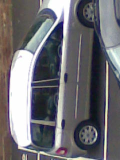

Attached picture, taken from the office on a mobile, but, you can see that all the tape has been removed. Newly painted frames will be posted on Monday, so long as the weather allows me to spray!
Sideways view!!??!! anyone?

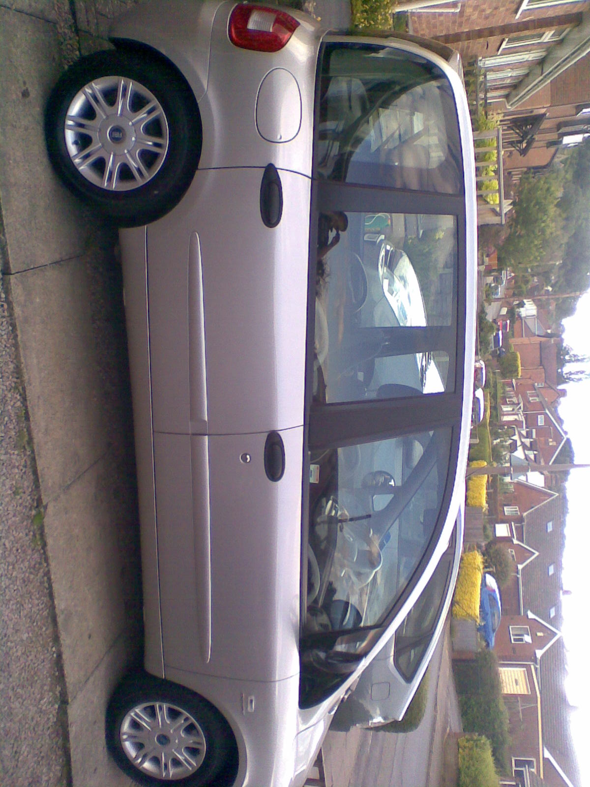

OK here is the multi with stickers peeled off and re-sprayed with Plasti-Cote satin spray.
Process
Wet & Dry sand (500 grit)
Clean and dry
Mask surrounding windows and area
Apply Plastic-Cote primer
Apply Plastic-Cote satin black
Remove masking
Enjoy
This paint is really good, touch dry in 10 mins and completely dry after 30.
