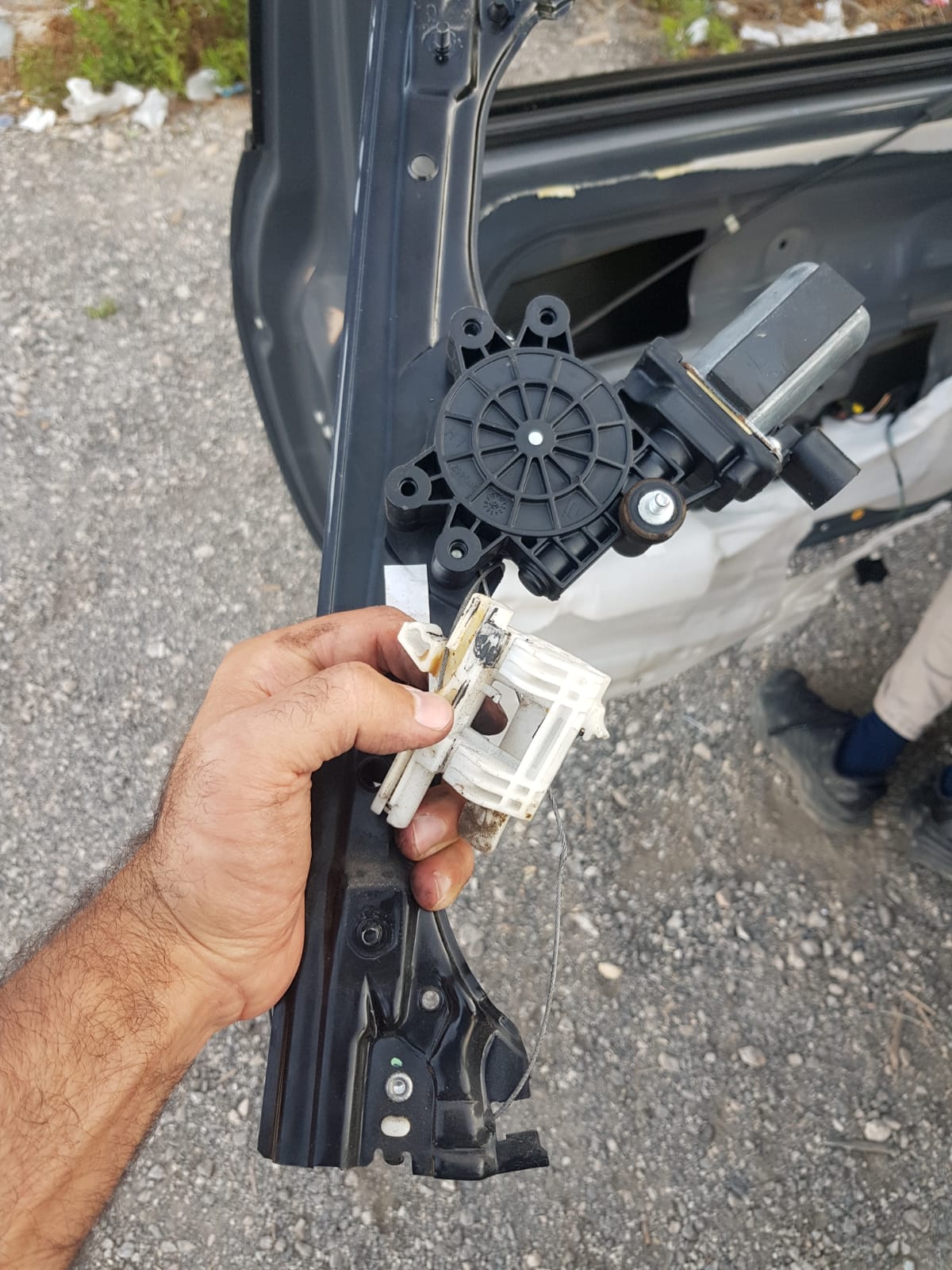

Window fell.
Opened door panel (thx youtube)
found this (see pic)
white plastic broken
silver metal cord spun out of circle tube (whatever)
need new "window regulator/mechanism"? or can I fix?

Hi was the mechanism loose or did you remove it? Was there any missing bolts?
Most likely it's possible to re install assuming nothing broken ?
All else fails Ebay here"could" at a cost post to you? Postage could be more than the part
I appreciate your response. After some more YouTubing I have found that the white part is the only thing broken, in the point that holds the window (there are 2 notches that the windows "sits" on, and they are broken, so the window simply fell inside the door.
At this point I am wondering if I should just get that white plastic part or the entire mechanism.
But I am not sure they even sell just the white plastic part.
Investigating.

Put the window in place (+ up) and secure it with two wooden sticks (one closer to the front of the car, the other one closer to the back of the car) cut to size with a narrow groove on the top of the sticks so they will be held in place by the windows itself. EDIT: they need to be put under the window, something like that. The sticks can be smaller, 2 x 2 cm will be enough.
The plastic part should be available as a separate part. It's not listed as a spare, but I've found it on ebay:
Double check the model / year before the purchase :)

hi.
so, i found out you can order just the plastic part on ebay for cheap.
unfortunately, i did not have time for that as i needed to close the window :)
went to a guy that was reasonably priced, he had the plastic part (without the electric motor of course - which is more costly).
i actually tried to do it myself - it's possible, but the cables got stuck in the mechanism and i couldn't get them out. so i gave up.
he changed the plastic part, rewired the wired, and installed it in the door.
it works.
hope this help!!!
