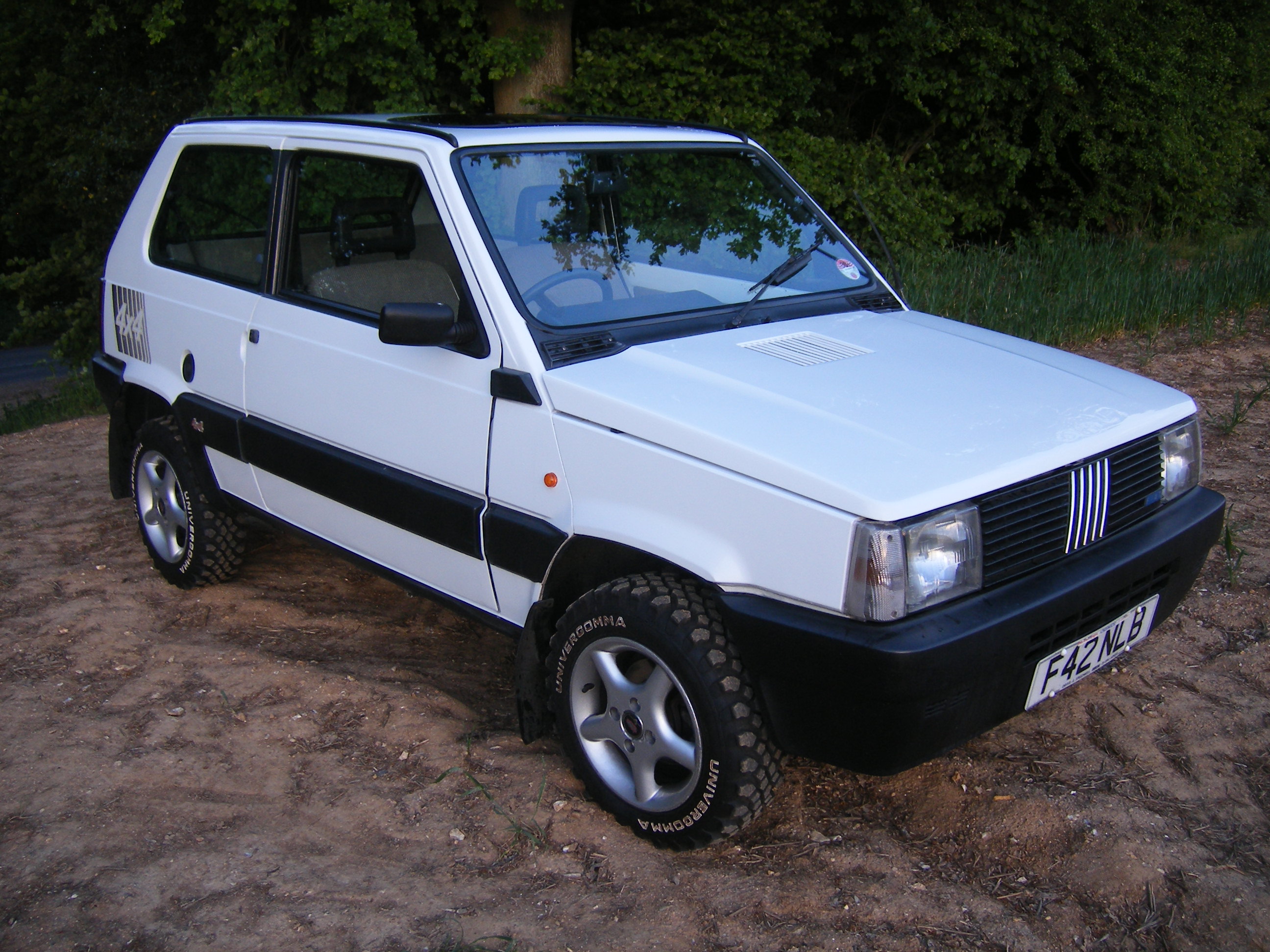

My camera's broken at the mo, but I do already have some pics on hear of the 155/70's if that's the ones you mean, or did you want pics of the 165/70 road tyres?
Here's the 155's anyway........
Now you say you'd like more ground clearance though you may be better off with the 155/80/13's. Again, I've had this size in a road tyre with no problems but you may have to adjust your fuel filler a little, I didn't need to though.
