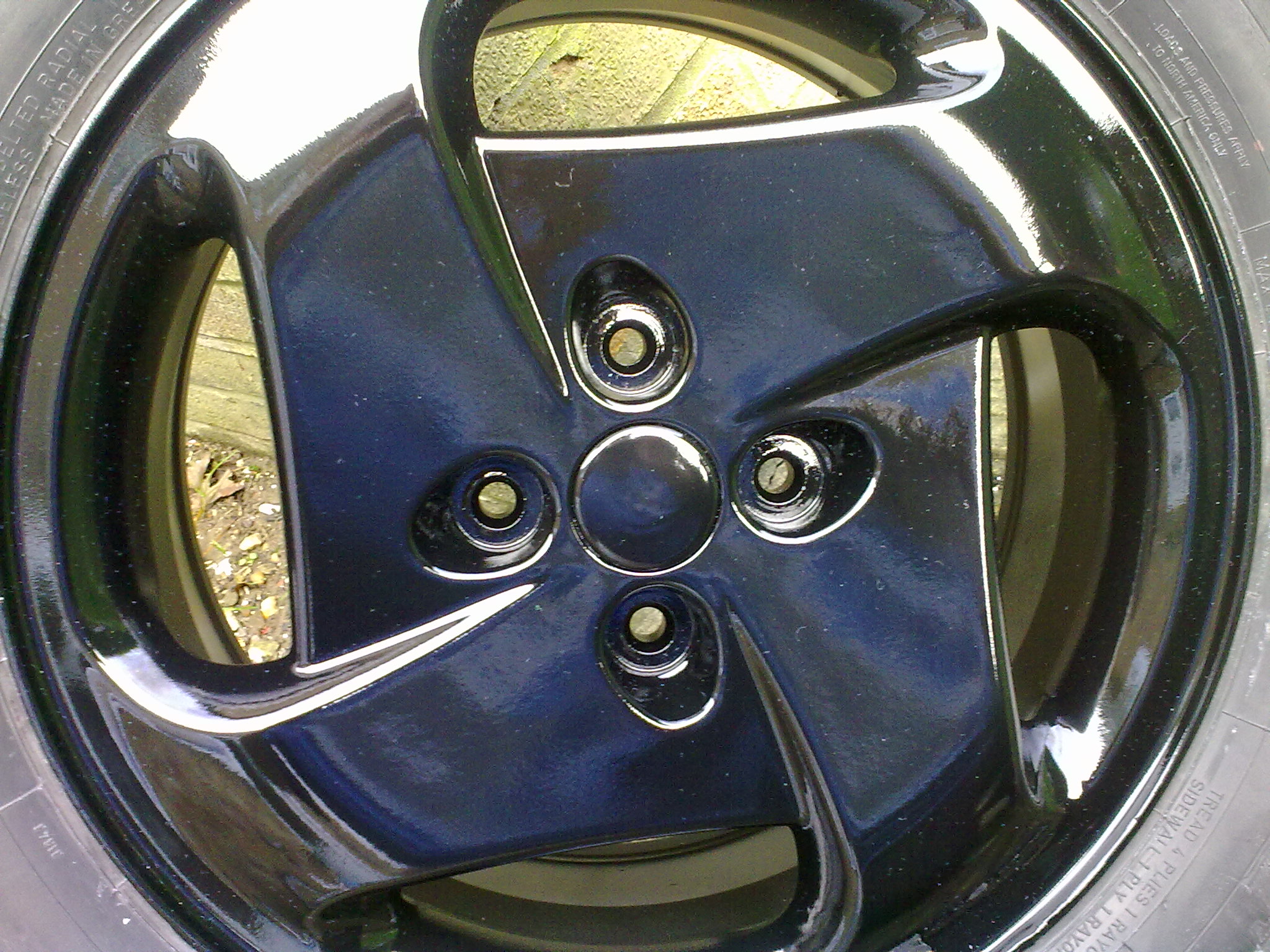

1 down 3 to go...
Thanks, took about 3 days to complete. 4 coats of build up primer, 6 coats of high gloss and then a quick rub with g3 rubbing compound then, 6 coats of clear lacquer. Total cost per wheel £18.00. Will post pics of all 4 completed and on the car...
thats gorgeous, id love a set of those for my Bravo.
