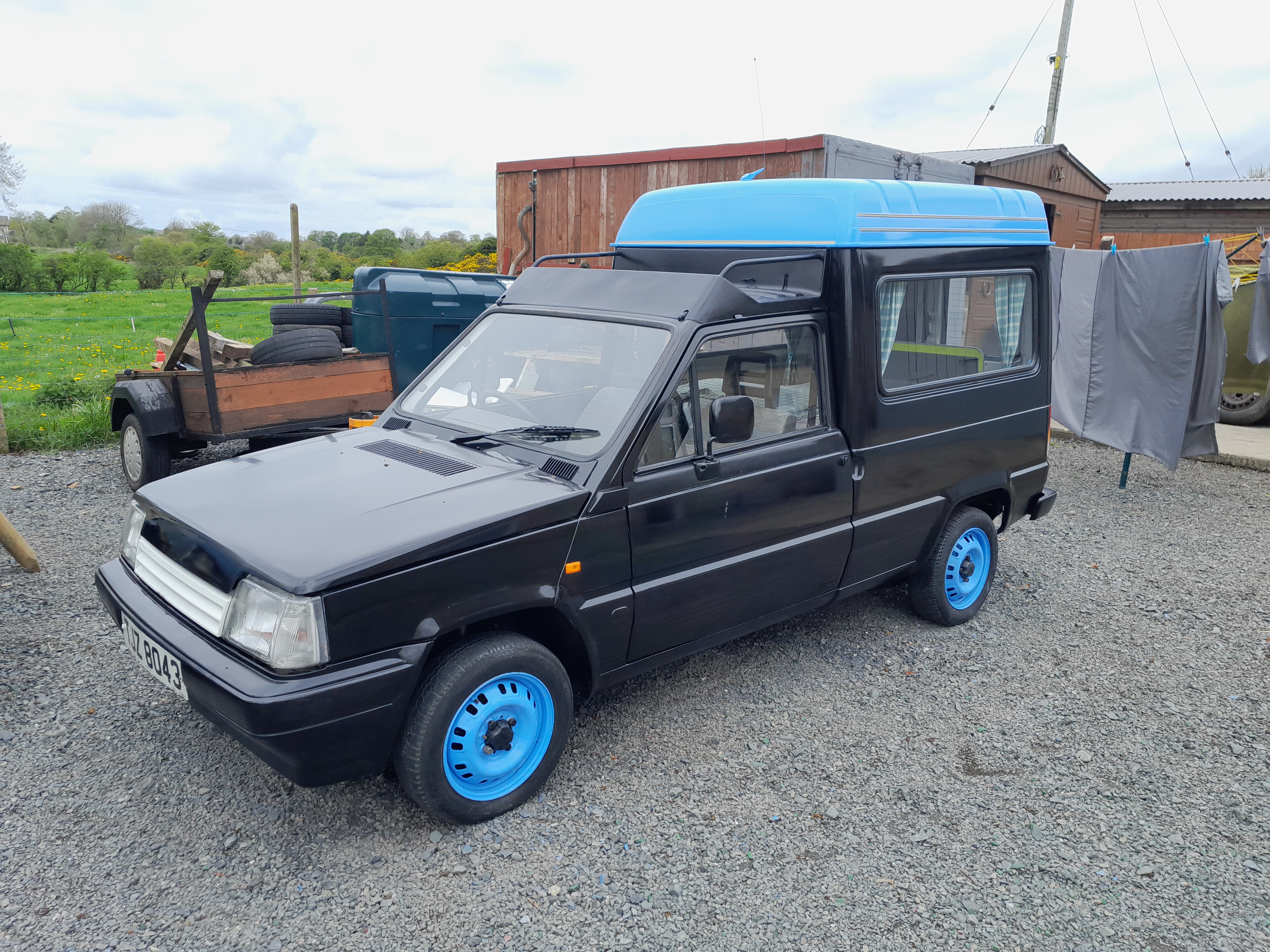

got a new 'panda' today
had a better look around the terra today. this is a growrings conversion of a 1.4 diesel, 5 speed. the previous owner didn't own it for long and did not mot it he did put a lot of filler and paint on it i will have to dig all that filler out . so ive got some sill welding, exhaust needs a bit of a patch /replace, prop shaft seals on gear box are leaking. some brake binding and rusty discs, gona replace timming belt. looks like theres two! and on the look out for bigger wheels. any one know what an atendant seat looked like on thease? its been removed and am wondering if i want to put one back in.
