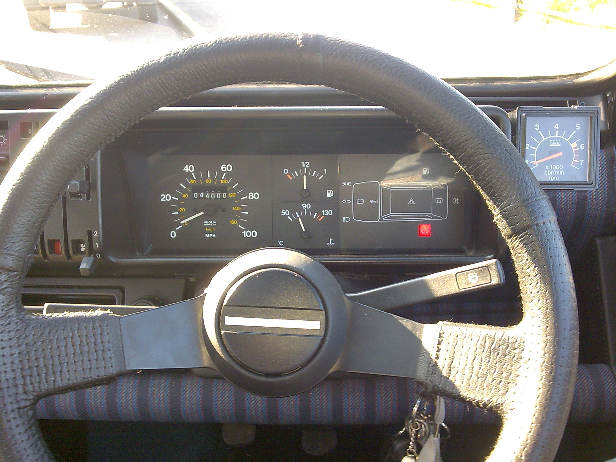

So I decided to buy and fit a rev counter from ebay. I think I thought the engine revved a bit higher than it does. What would people consider the red line top end of the 999 fire engine is?
In other news amusing though it is I'm going to have to do something about the light. Why do (cheapo) after market tachos have to come with white dials and blue back lights. Unfortunately it's not as easy to disassemble as I had hoped. Comedy pictures of the garishness

Well. I have dismantled the the rev counter and decided to make my own dial in a more in keeping black. I'm quite pleased with the results, though I just realised I should have removed the 8000 and made the red from 6000 to 7000.
That looks great with the black face, I can only ever find those blue ones on ebay and always discount them because of that. Did it come apart easily?
It was fairly easy to take apart and ditto replace the LEDs. Shouldn't pose a real problem for most garage tinkerers/panda owners!
