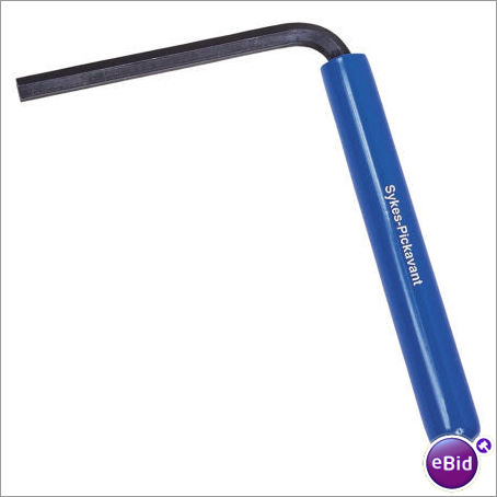

Hi, im changing the brake pads on my X reg Marea weekend and im not sure what tool/tools i need to remove the caliper bolts? Iv had a look and its not standard bolts that can be removed with a socket or wrench so anyone any idea what tools? iv had a look online and i think ill need Torx Bit Socket Set but im not sure, any help much appreciated.
as standard they should be either 17or19mm bolts at the front and a large (forgot size) allen key at the rear. neither should be a torque
Thanks for the reply, im thinking i need
Hex Bit Socket Set
seen it advertised on here from halfords and it looks like the thing i need, could anyone confirm this?
After searching the forum i have found the answer i need a 7mm hex bit or socket. here is the link to the forum page that i found it on incase anyone needs a guide. https://www.fiatforum.com/marea/101522-changing-front-brake-disc.html
