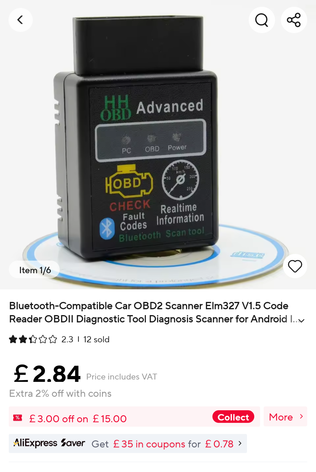

I have one of these?

Your is a china generic Bluetooth elm327, same as these I own
They are random if they will work fully, they nearly all work to read engine codes, the rest is hit and miss, you can't tell from the case they are packaged in

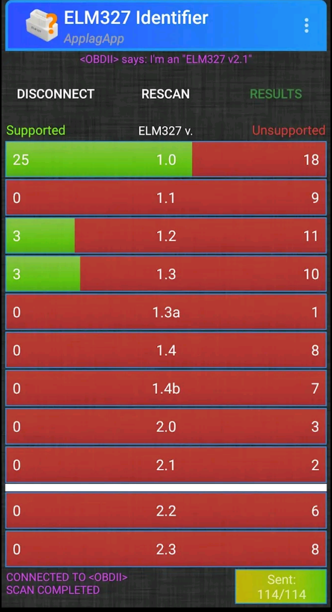

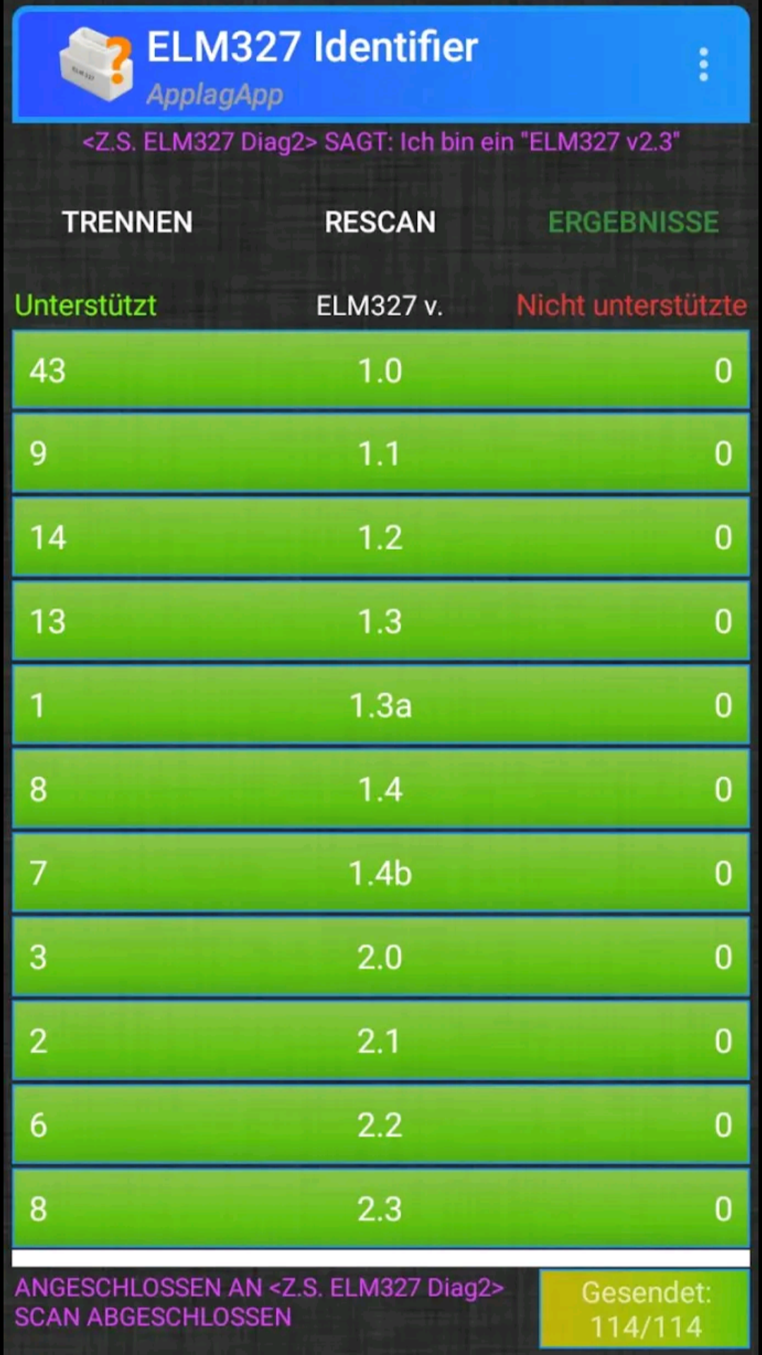

I'd start by testing if it's compatible,.if you have access to an android phone, there's a program free on Google play store
Elm327 identifier
Only one of these three actually works fully
It will either come back like this
Or hopefully
