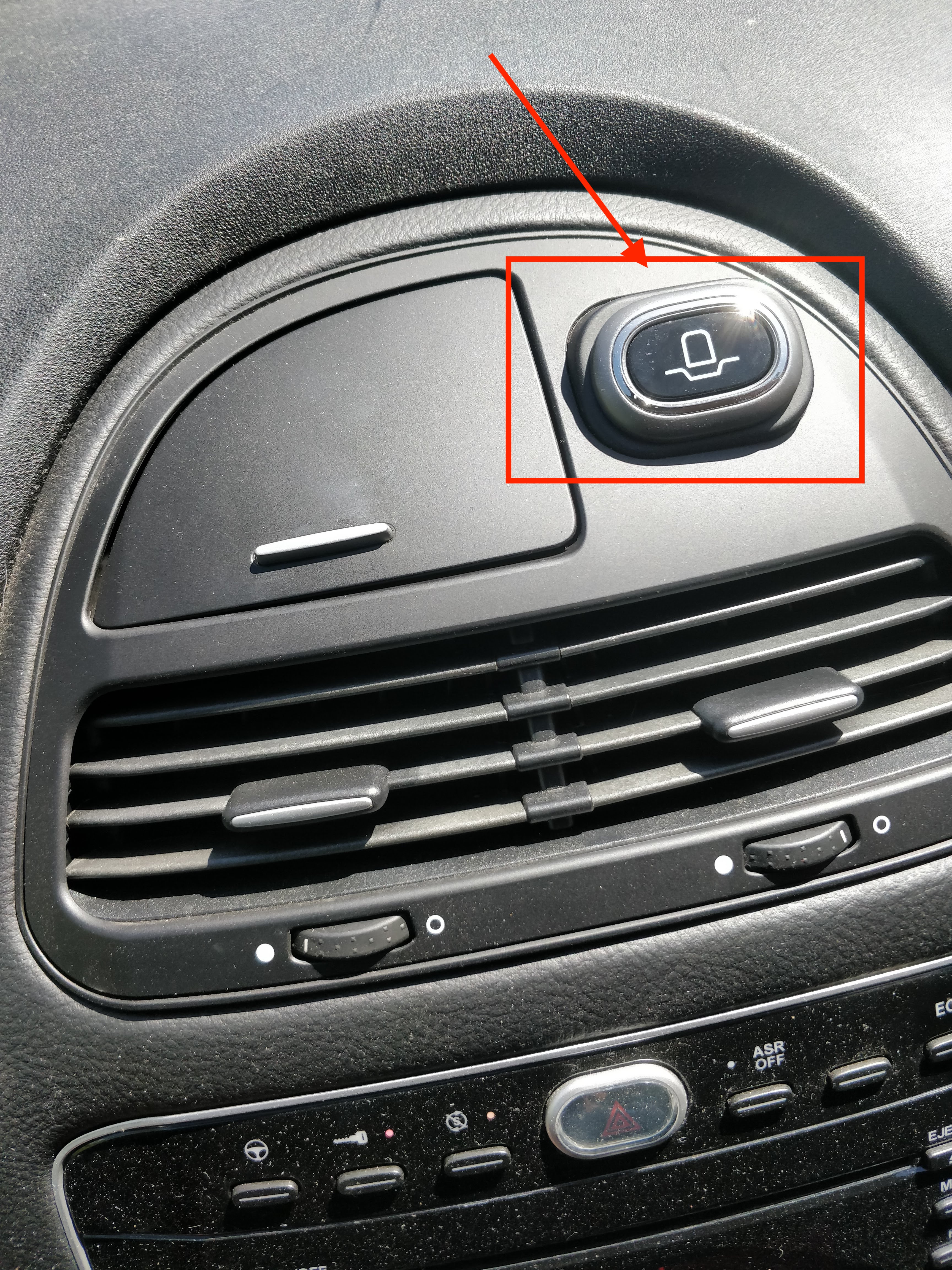

Been trying to figure out what this symbol means and its function for the longest time (in a Fiat Punto). Couldn't find the right owner manual either.

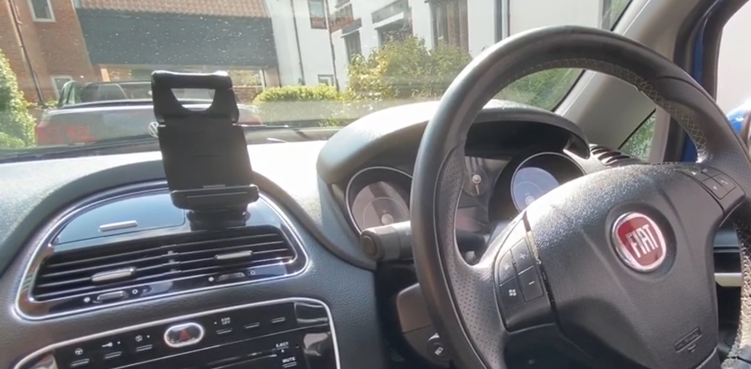

It is called the 68R port, you plug the holder for the tomtom satnav in and it carries the power connections for the satnav, it also will take a specific fiat phone holder (without charging or power connections) fiat had intended it would do more but this never happened.
So unless you have the correct phone holder or satnav the port does basically nothing.
