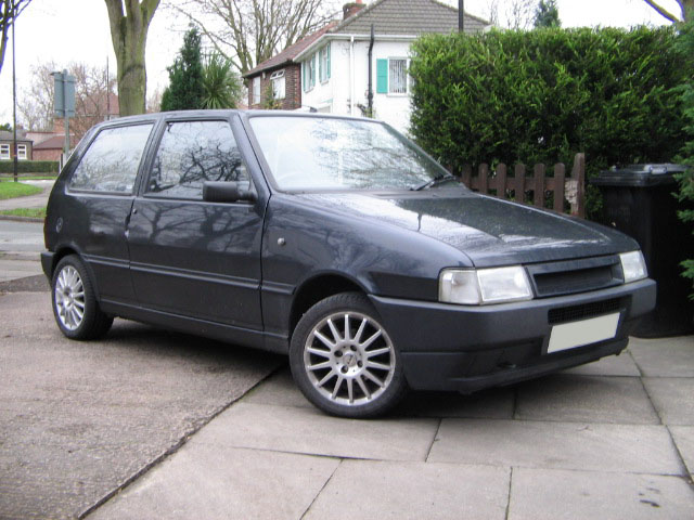

one thing I havent ever got:
Why do you have the bonnet high at the back?
They have spacers under under the hinge at the back to raise it so the hot air can escape.
yeah as metro said, its to let hot air escape easier out from under the engine bay. so not just for looks (even tho alot of people dont like it lol)
ud be supprised how much it works lol
Dunc
Nice one, when I saw your piccy, i thought it wasnt aligned correctly :D.
Doesnt water get in though?
no, water doesnt tend to get in. theres still the rubber seal there, even tho its not sealing, it acts as a block, which stops the water getting in.
yeah, ive had a few peeps sayin "ur bonnets not shut"
