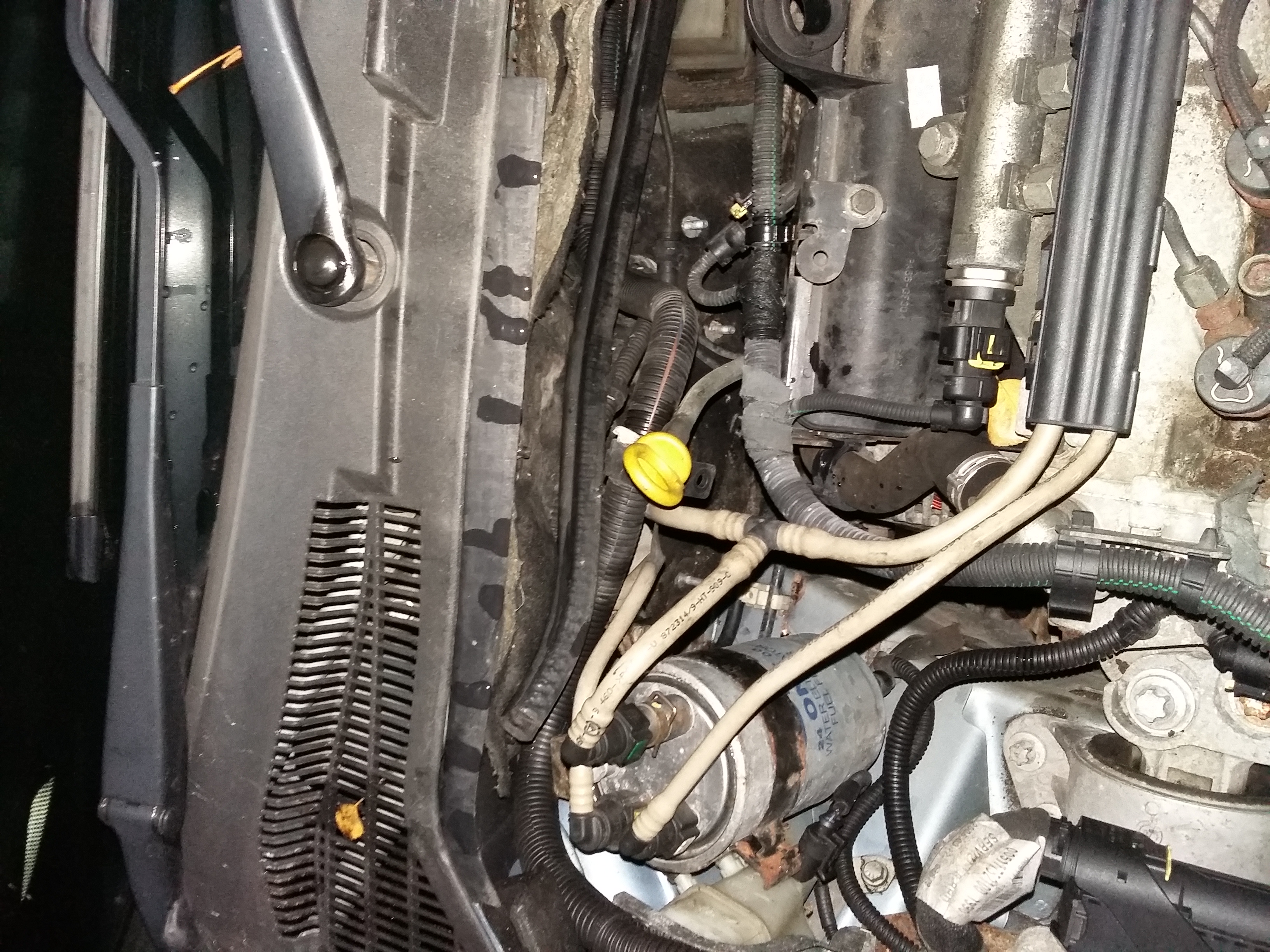

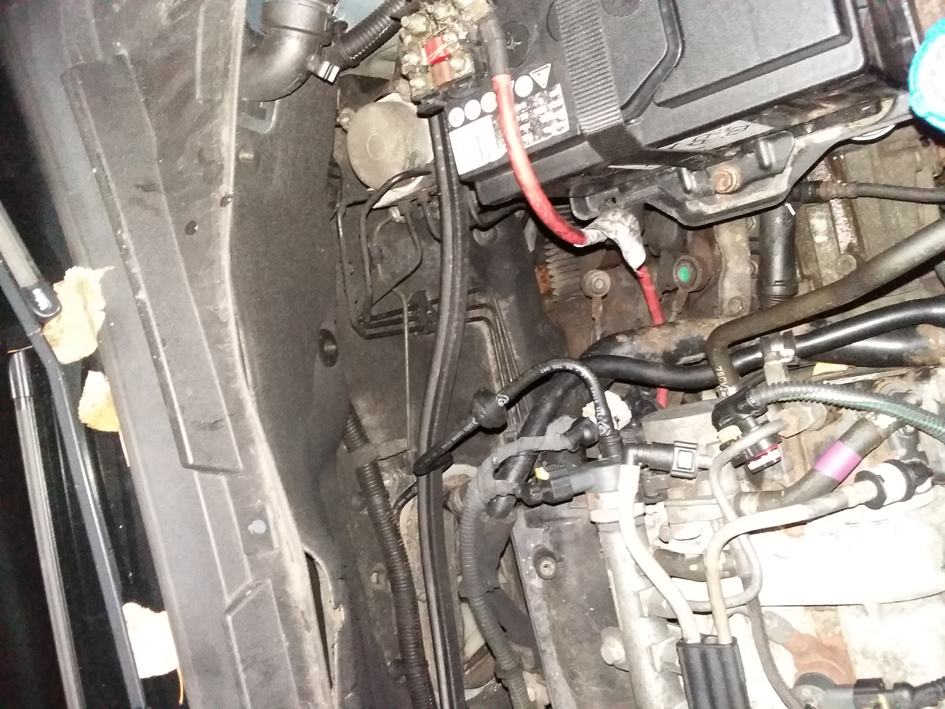

Update..
Well.. could be pretty simple :)
Yesterday I checked the oil level.. done some m.way miles recently.. all checked out fine..but it was wet and windy.. so a bit rushed.. :(
Tonight I decided to check other fluids.. all checked out fine..
then..just as I was about to fold back the bonnet stay: prop then - I saw it!!
The weatherstrip that all the puntos have loosely sat on the plastic panels on the scuttle.. it had fallen off completely..
And fallen to the back of the engine :(
There was a groove worn into it where it had rubbed against a pulley.
The sealing strip is in the boot ;)
Looks like an obvious thing to have happened..them most annoying thing ?
Popped the bonnet on the old GP ..
THAT STRIP HAD FALLEN DOWN TOO..!! :O
POXY CHEAP TRIM PARTS :(
My older cars had sections of this areas trims that would be lifting.. but these punto ones are just junk.. this cars trim has been a poor fit from day 1.

The no expense spent 1/2 width sealing strip does have a purpose as it keeps water of sensitive areas. Check under the bonnet the next time its raining. You might want to fit a replacement seal.
Good call on spotting the cause.
