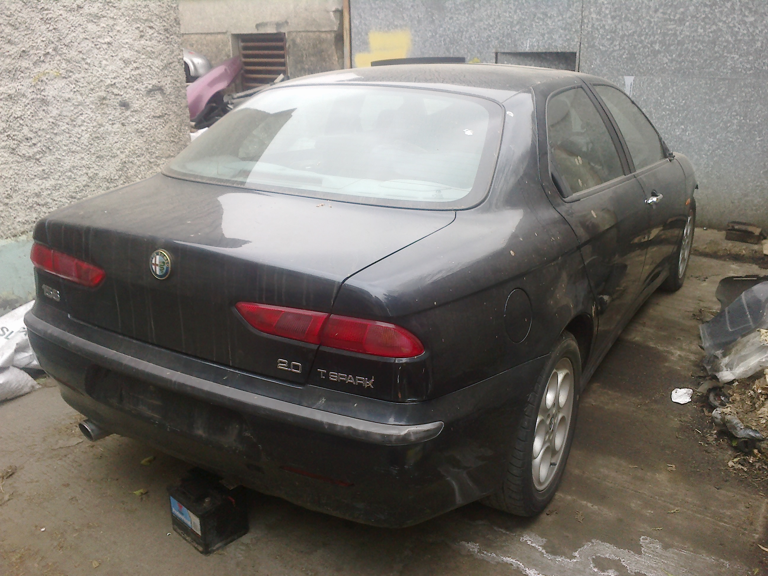

This one can't be rescued but has a lovely sounding engine :)
I also plan to transport these

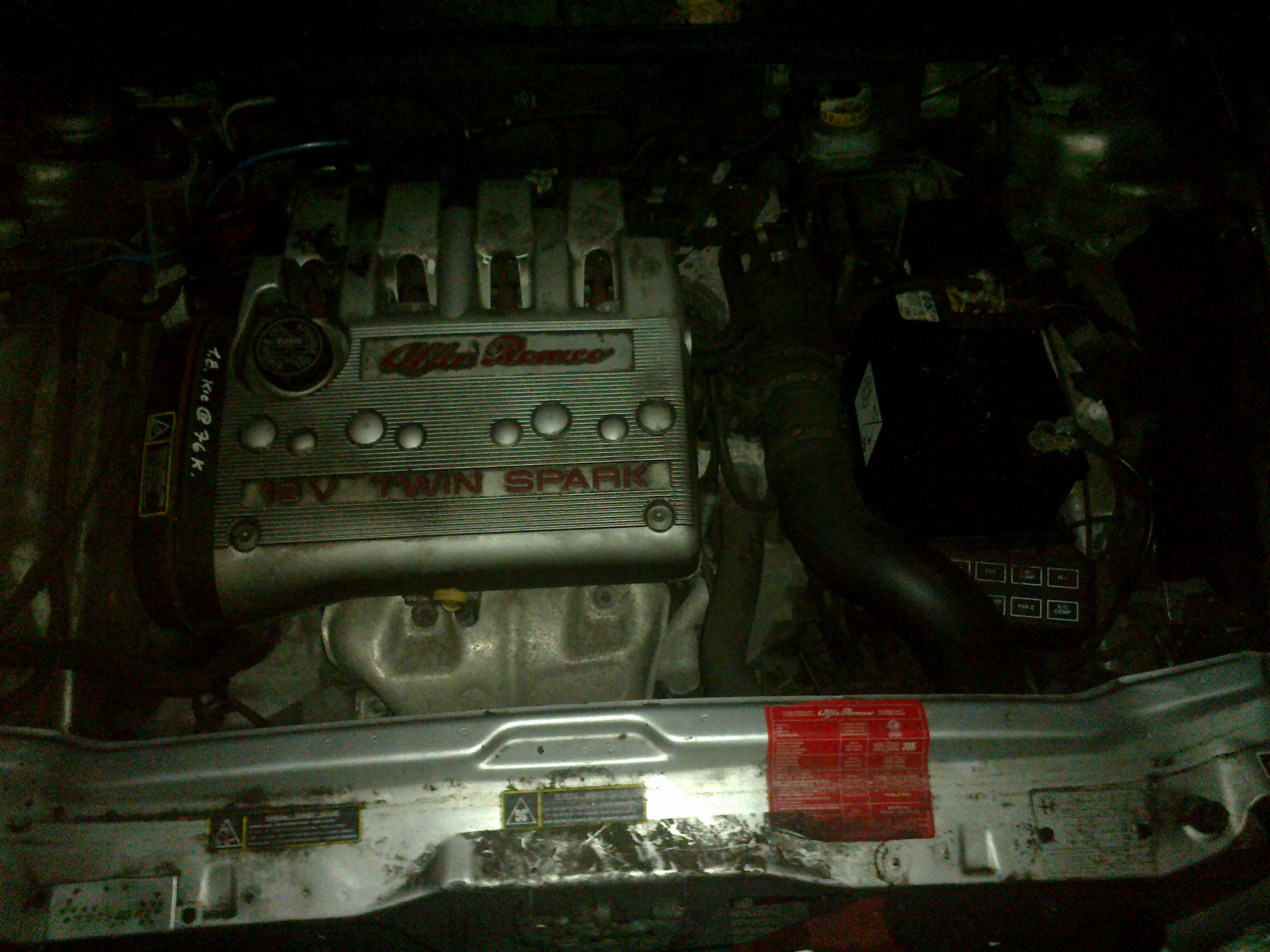

Im quessing either 01 or 02 as it has the three cats(y) . I had autodata but my dad decided to declutter the pc so its on the missing list must try and get a newer version of it anyway :idea: .
1.6, 1.8, 2.0 ? nice purchase, that going in bravo of course ?
This is my first question. Im guessing 1.6 based on the engine steady in the top left of the pic. (connects to the drivers strut tower, same part as Bravo 1.2 i think)
Edit, just noticed the Alfa wheels are 5 stud :p
A 01 :) this one doesn't need the cat! :p I've been meaning to get Autodata myself a while...

On the engine this man has it spot on:
Very well spotted, it is indeed a 1.6 ;) I was opting for a 2.0 CF2, I'm in the deep end with a CF3 setup! Didn't particularly want electronic throttle! Ahhhh

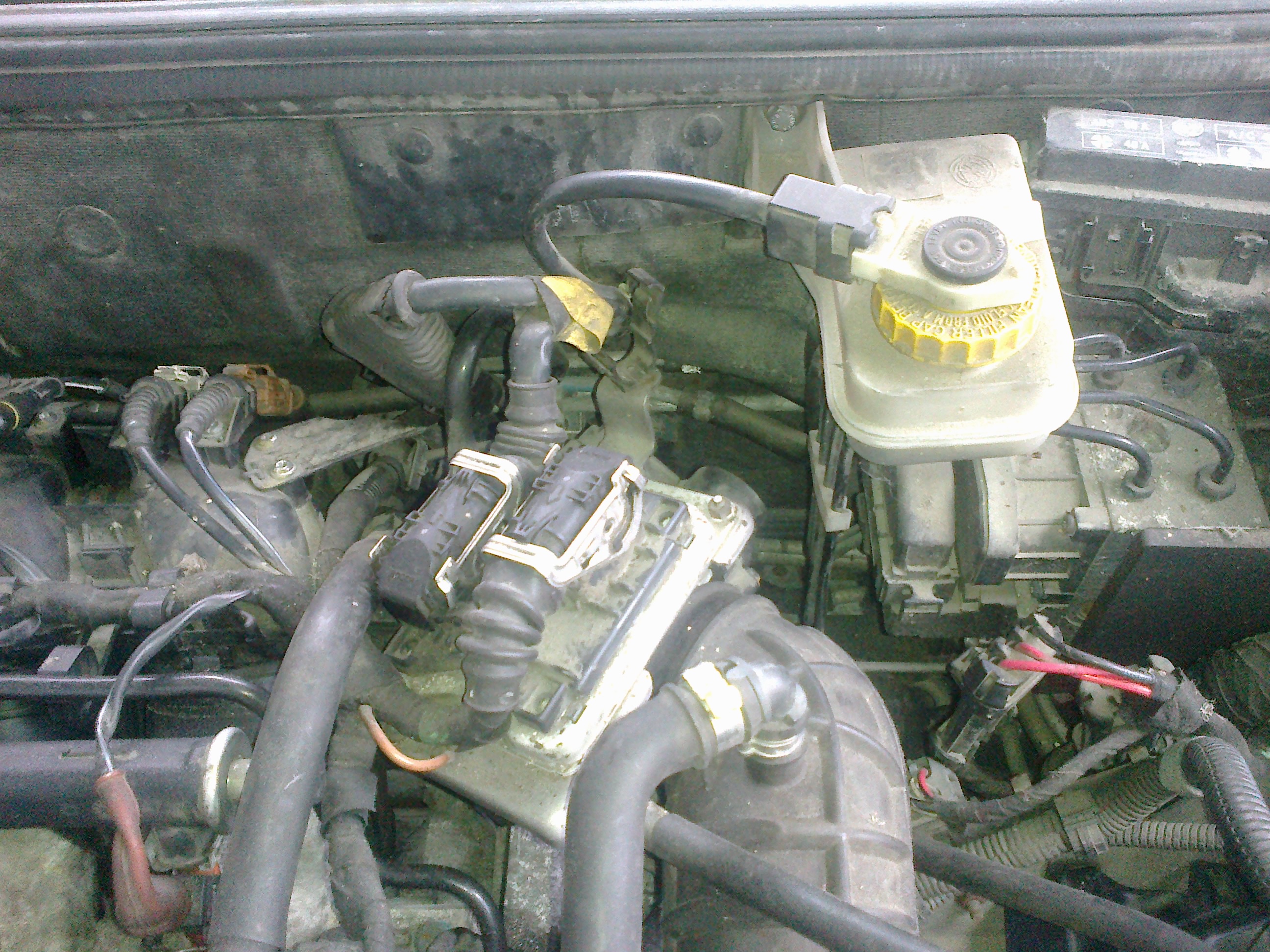

I've began to strip said 2.0
The main attraction
Conveniently, the ECU in the van decided to give up :rolleyes: taking it out, it plugs straight into the Alfa's plugs :) doesn't mean the pins are the same... If they are, happy out! :worship:
Then there's driveshafts to think of too.... Hmmm.....
Any light shed on both the ECU's would be a huge help! (y):D

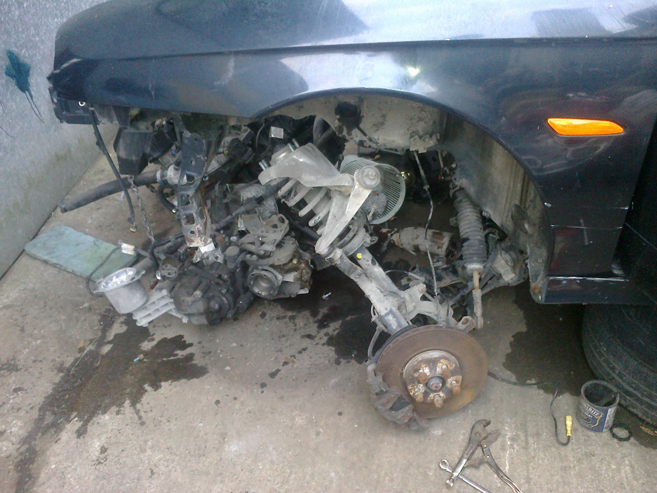

This will be fun to try and retrofit the driveshafts..... Feck the double wishbones I want to use my coilys!!!
Stay tuned.... (y)

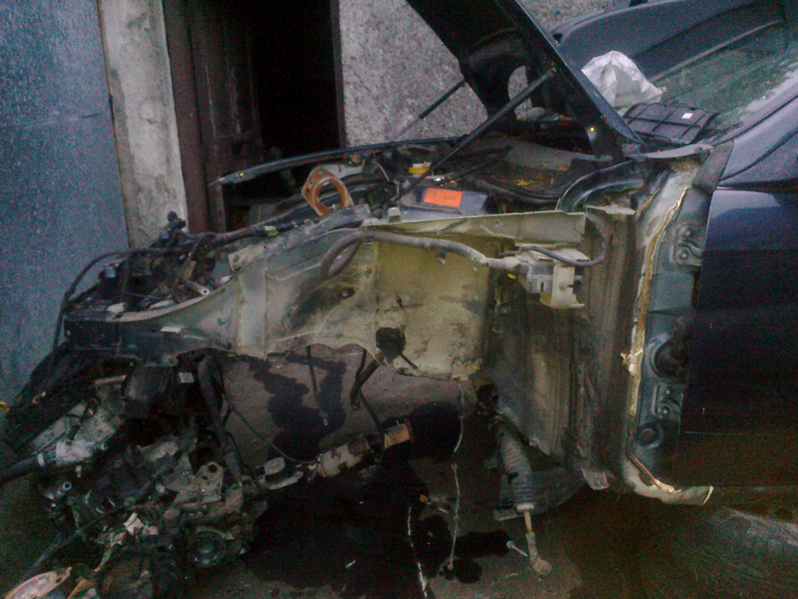

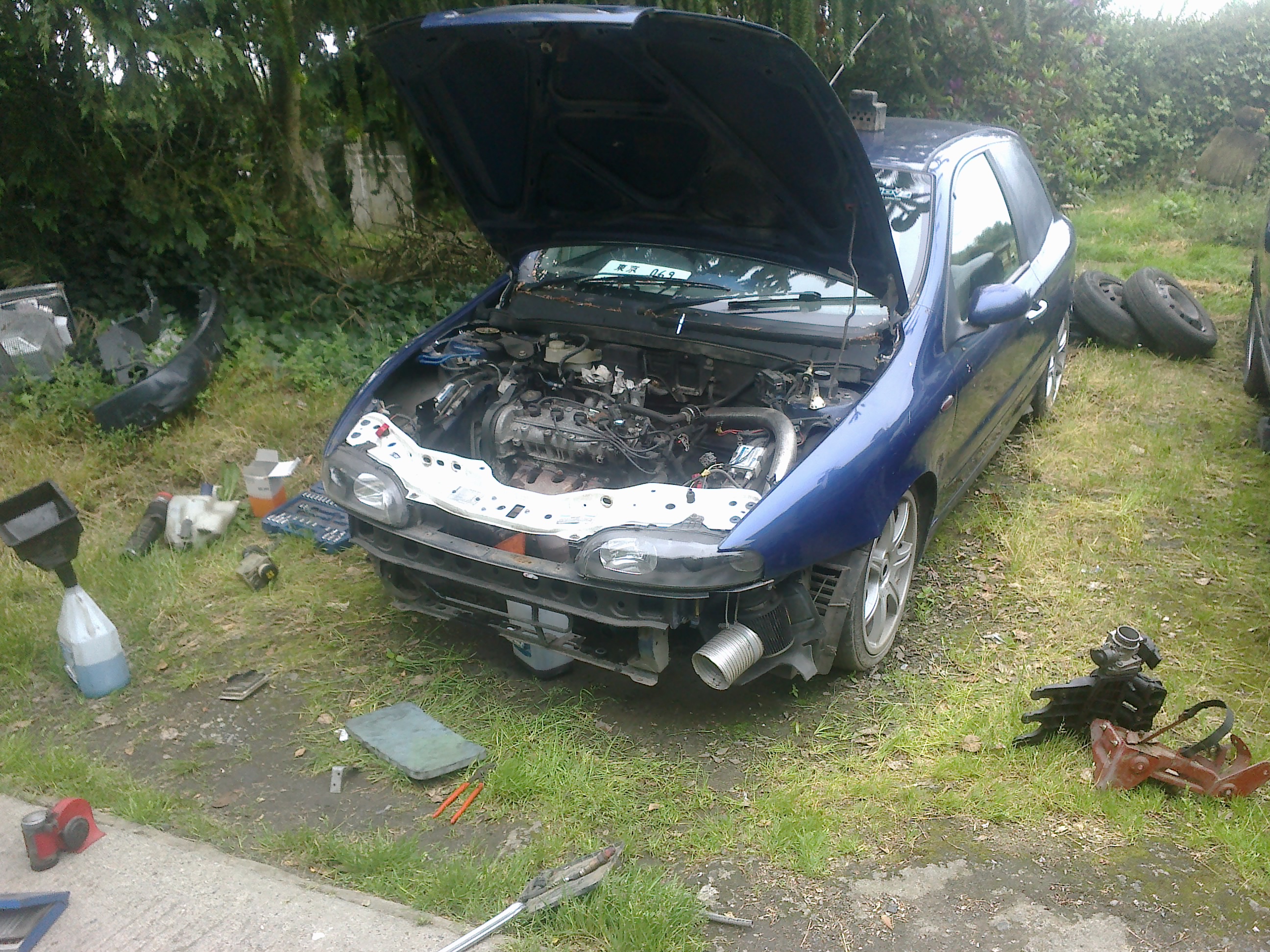

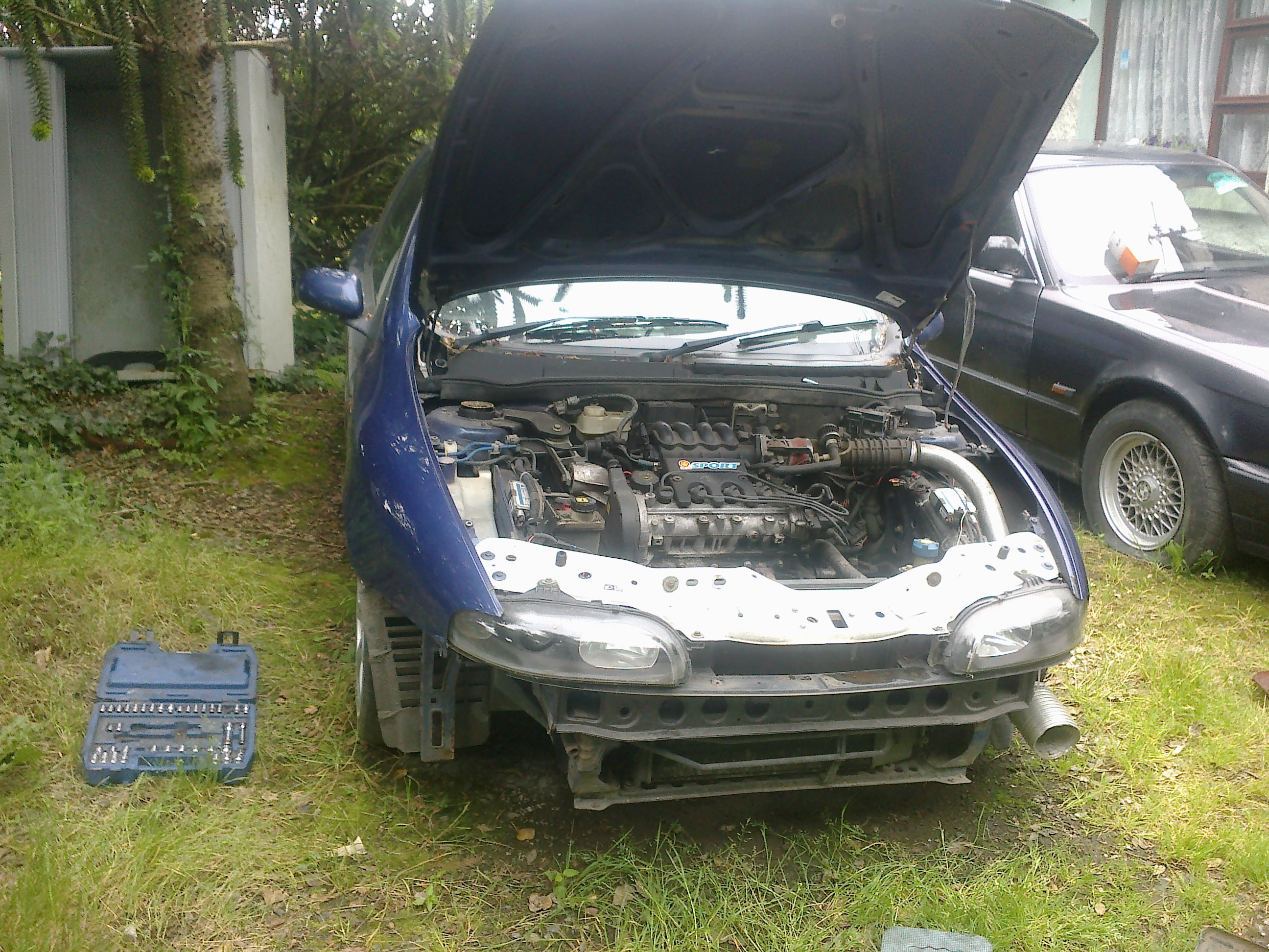

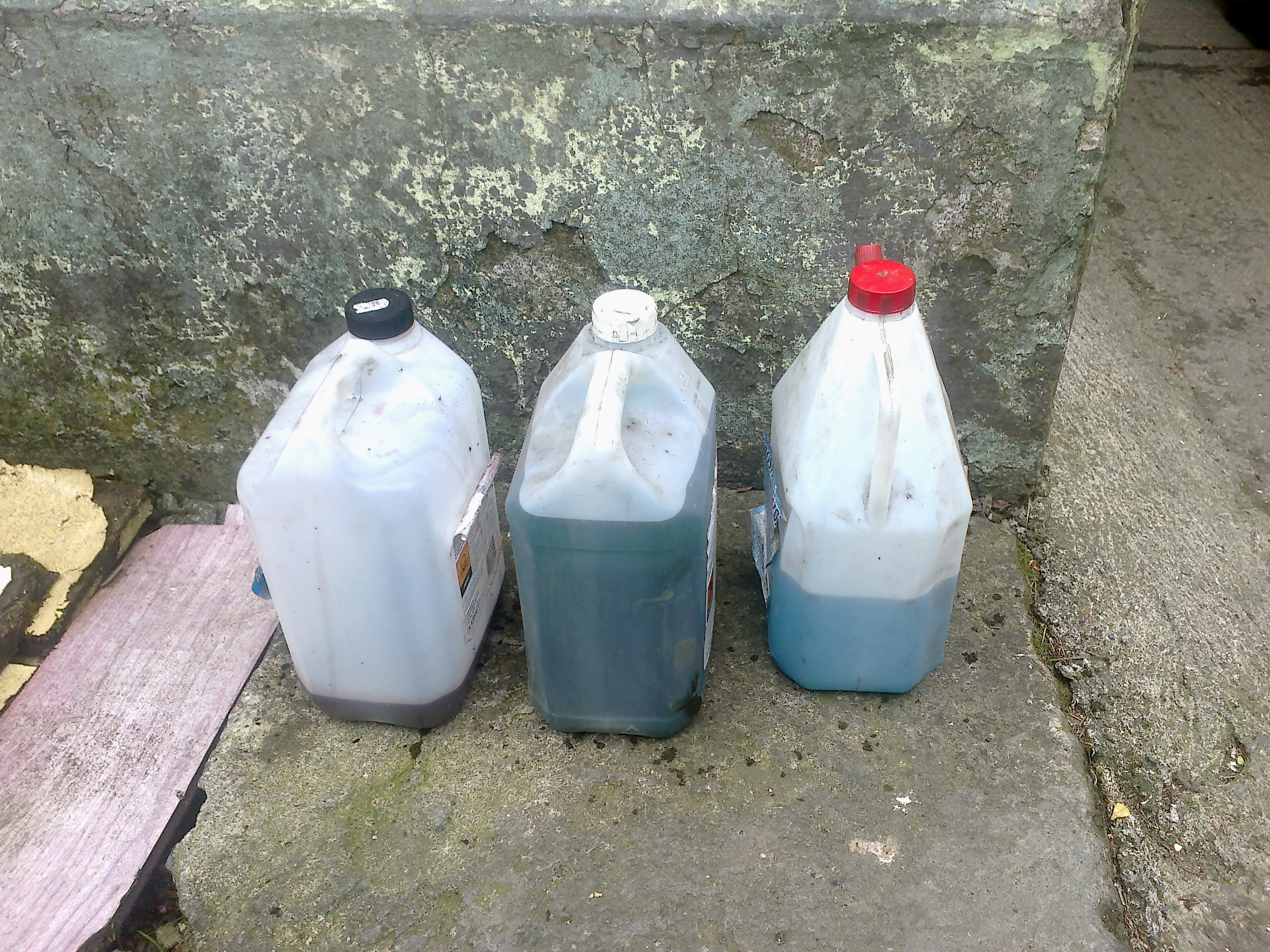

It hath begun.... Just prepping for the engine out.... ;)
De-polluting
Almost ready. Just shafts and the exhaust left to remove, but will do so when it's at the garage door :)
More to do..... (y)
