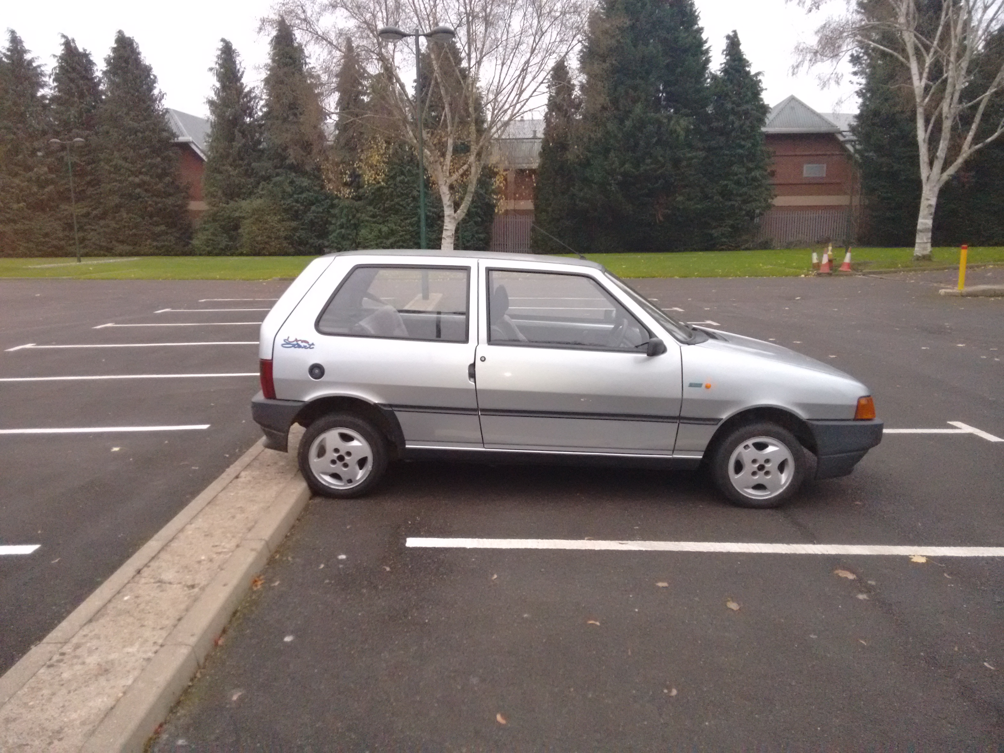

Got a nice set of 13" UT alloys with 165x60x13 tyres. The gap between the tyres and the body, or the wheel arch etc is too wide. Looking through this site the standard UT tyre seems to be 175x60x13 but this would only increase the width of the tyre not help with the height.
On the other hand, the previous steel wheels had 155x80x13 and I hated them. The profile was very high and it affected performance.
Thoughts/recommendations?

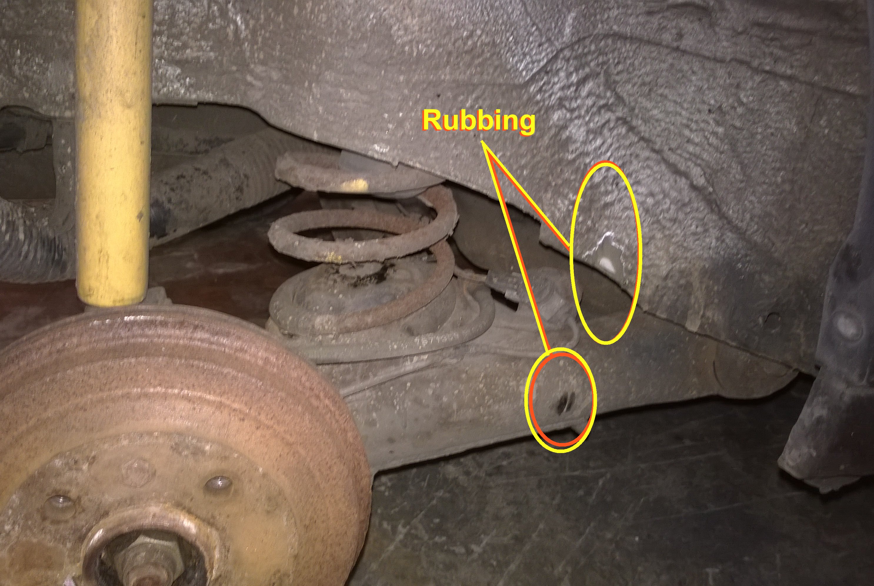

I had 185/60 14`s on mine, the fronts used to rub the inner wings quite badly, the rears rubbed the front of the inner wing during hard cornering (next to the seat belt bolt). I could have probably solved it with some 3 or 5mm spacers, but I dont like them!

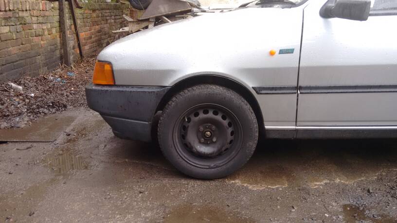

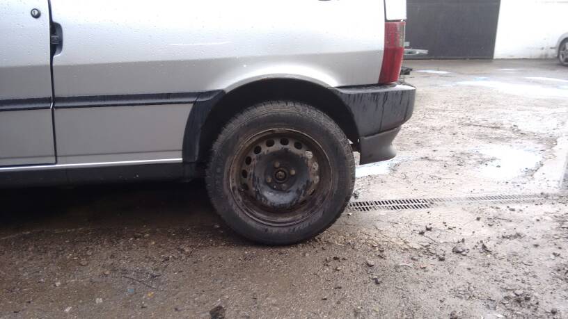

Just tested both 175 70 14 and 165 65 14 wheels I had lying about and they seemed to fit without problems. Turning and driving was fine with no rubbing on the arches or on the inside.
If the 14" wheels fit without rubbing then I think it's safe to assume the 175 60 13 or 175 65 13 tyres should be fine.

Thought I'd just mention that I took my wife out for dinner last night and while parking there was a mild but noticeable rub on the left front outer wheel arch. That was with the 175 70 14 wheels. She only weighs 58kg (9 stone).
