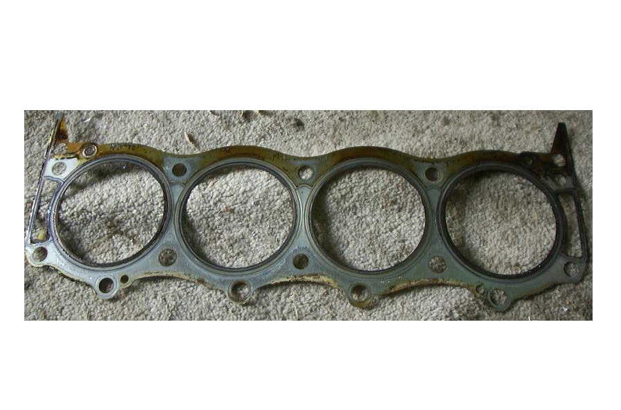

Must be the head gasket then :bang: .. if i get the headgasket changed.. then is that the only part needed to be replaced in this process ?.. gotta check ma pockets before i jump into doin this .. by the way i aint sure wats a headgasket .. have always heard about it .. is it the one when u take off the head, its a thin layer sheet, placed between the head and the base which has four cylinder holes?
is this what a head gasket looks like? :idea:

jup that's the one.
things need to be changed when you do that:
headgasket set (inculdes the gaskets for the cam cover aswel, becouse you need to remove that to get to the bolt for the head it self).
If you remove the head you gonna have to take of the cambelt, so you need to change that aswell.
if you say it's loosing coolent and oil aswel, it's pretty shure the headgasket.. To bad m8, but it's not lost, it can be saved..(y)
