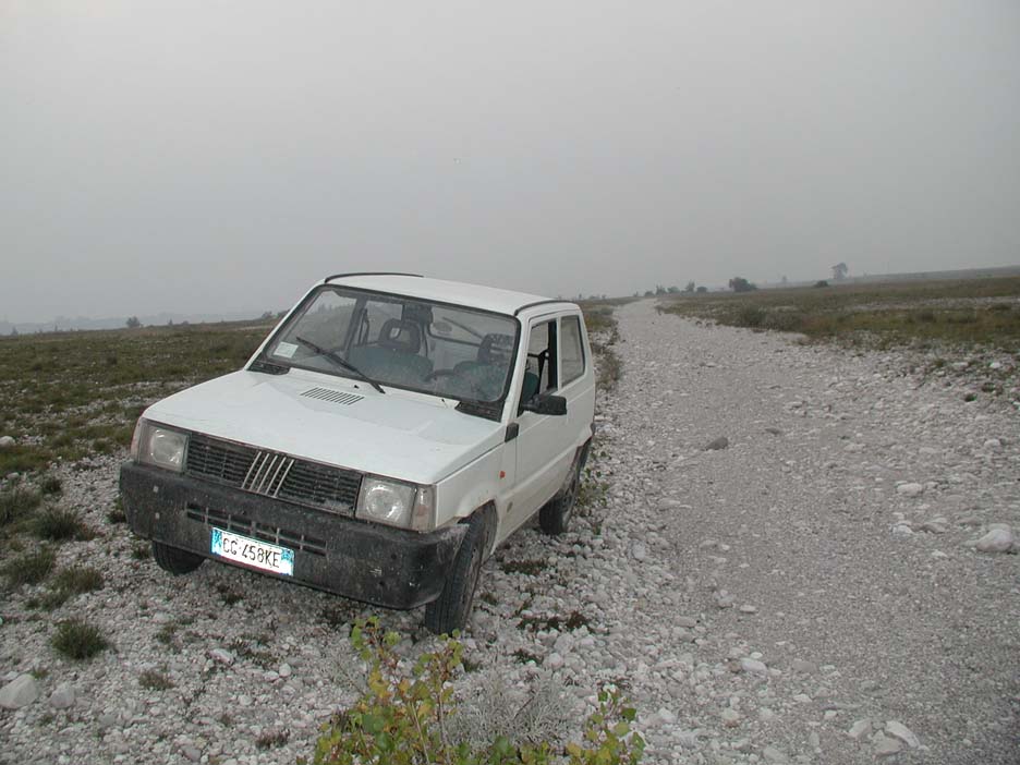

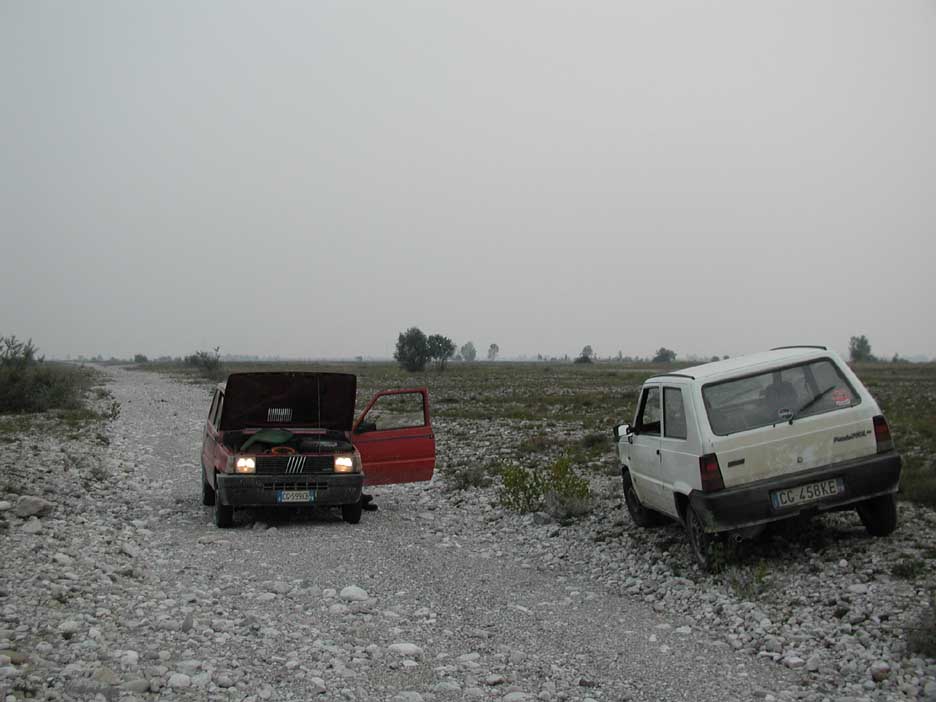

Kevin, here are the pictures you requested.
This is from 1st October. The oil pans took some beatings but no holes yet. Still running relatively strong. I have what I believe to be a vacuum problem and Nacho (in the red Panda pictured) is having a carb problem as posted in https://www.fiatforum.com/showthread.php?t=17572 We have some videos made also, but there will be better ones. I'm currently trying to come up with a site name and once I do, I'll host them there.
