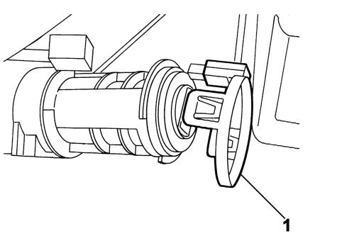

Every week my stilo cuts out a few times, i bought a code reader from ebay and there are two error codes storred:
u1600 Key not recognised
u1601 C-can network fault.
Didn't go to the fiat dealer yet, but can this be due to a battery problem?
I did the free stuff first mentioned on the guides section. The car runs better, but stil having the problem.
Cheers
re: U1600&u1601 [ECU poor contacts?]
As you have U1600 key not recognised and can bus fault, i'd have a look here at the immobiliser chip recognition pick up aerial ring at the ignition switch. Seems to be a common problem with poor electrical contact here.
Look for poor wire contact at the connector

Thanks for the quick reply's. I ordered the key barrel(antenna) just in case, wil take a look at the connections and clean them. Hopefully it's that simple!!! Will let you know the outcome!
Changed the antenna ring and cleaned the contacts with contactcleaner, but still cutting out. Any ideas?
