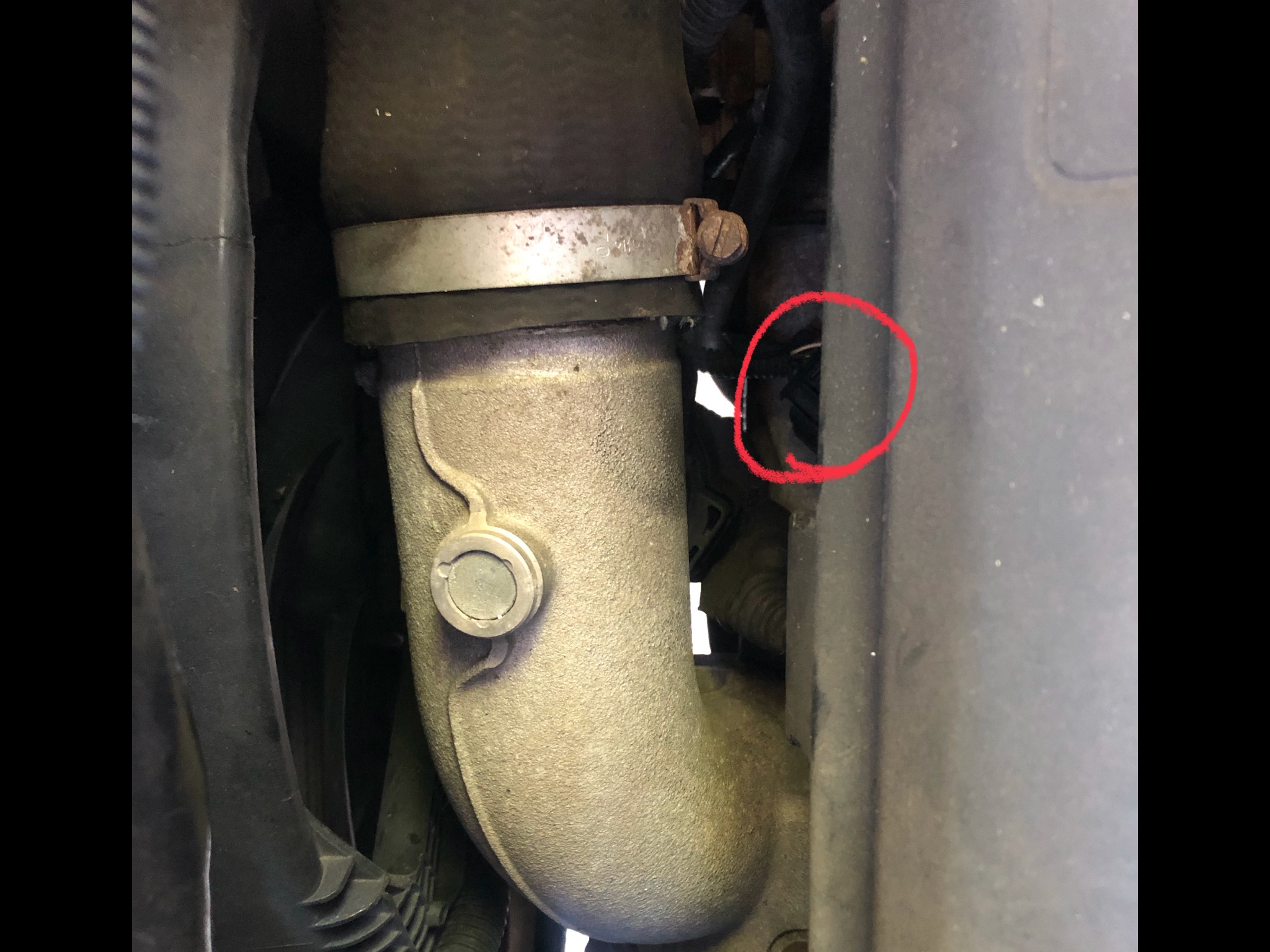

Where exactly is the MAP Andy please? I can't recognise from the photo.MAF is just after the air filter, so far right of engine bay, above gear box.
MAP is a joy to get to, and hope it doesn’t snap off.
The map is behind the throttle body. It’s where the TB and hose join. The “thing “ you can see in front of it in my above pic is the glow plug for cylinder 3Where exactly is the MAP Andy please? I can't recognise from the photo.
Old pic before I swapped the TBWhere exactly is the MAP Andy please? I can't recognise from the photo.
I didn't want to stick my oar in, but did think the first photo looked like a heater plugThe map is behind the throttle body. It’s where the TB and hose join. The “thing “ you can see in front of it in my above pic is the glow plug for cylinder 3
