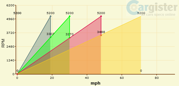

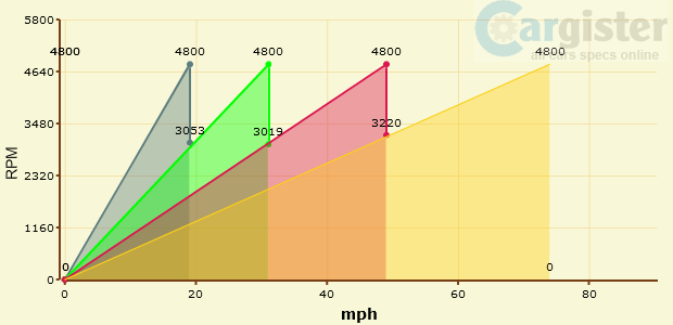

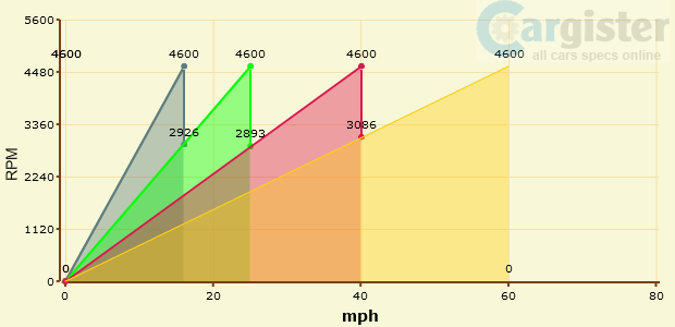

I noticed a useful lengthening of the gears when fitting the gearbox from a 126 and this uses the additional power of the bigger engine whilst keeping the high rpm reasonable at speed. Putting aside the fact that an everyday engine may not work well with the BIS crownwheel and pinion, does anyone know if the difference it makes to comfortable top cruising speed is in the same order of magnitude as going from the 500 to the air-cooled 126 setup.... someone was asking me. ;)
I've dug up my own answers and welcome anyone to refute them. I've worked it out from a basic online tool which doesn't take anything into account other than the basic gear ratios and the RPM of maximum engine power and I'm assuming standard tyres so a diameter of approx. 500mm.
It seems to accurately reflect experience on a standard 500 setup giving a top speed at 4600 rpm of 60mph. (1)
On a standard 650 engine at 4800 you get about 63mph. (2)
On a standard 650 engine at 4800 with a BIS crownwheel/pinion you get about 73. (3)
Taking into account that I can easily achieve a speedo reading of 70mph+ with a standard 650 and gearbox this implies an engine speed of 5200rpm! :eek: (4)
Stick the BIS setup in the diff at the same rpm and you get a theoretical 80mph. (5)
As I said initially, I'm not debating either the realistic chance of achieving this nor the advisability of doing it; I am aware that other aspects of performance would be likely to suffer and the whole essence of the 500's fun driving experience would probably disappear. But for straight-line cruising, of which I do quite a lot, it might make driving a Fiat 500 much quieter or quicker.
