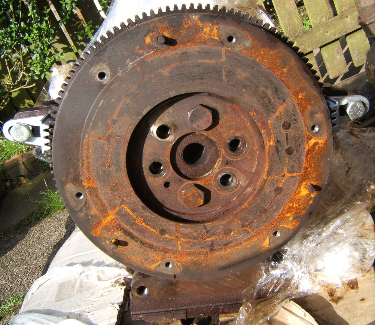

Reading haynes again and it says lock the flywheel so i was thinking two of these. Each bolted throught the lower gearbox mounts.
Im worried about braking the gearbox mounts, the crank sprocket bolt is tightend to 360nm. Should I be worried? I think two may help the load.

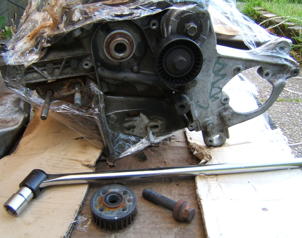

Well I got the crank sprocket off the spare broken block.
I used two flywheel locking tools in the lower gearbox mounts.
My mate stood on the block. Without him i was just rolling it round on the floor. Used my 24" new longbar
:D feels like ive turned a big corner today

Well they are franklin and BMS a local motorfactor wanted £23.99 for one! so no way i was paying that, plus they had to order it in. I found the same ones on ebay for £8.40 each. so got two. They are heavy for there size like all strong metals
You dont get bolts with them. Those i used where some my dad had from his old engineering job.
