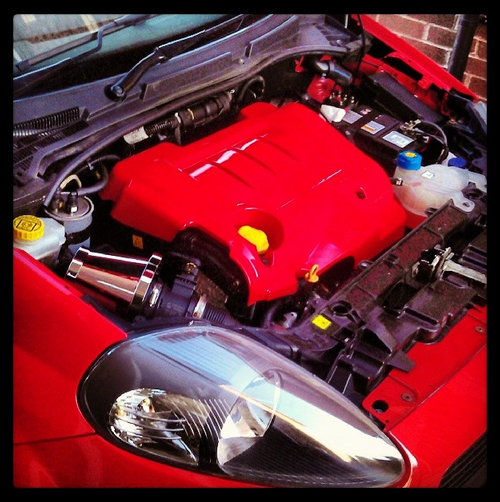

been doing abit of work under the bonnet for a change. gave it a clean, painted the engine cover red and installed a heat shielded cone air filter, loving the blow off noise even more so seen as in the missus hates it haha "ryan it sounds sh*t it sounds broken" bla bla bla
any who heres a pic!
im also going to be painting the "multijet" on the engine cover black...somehow...any suggestions? and sometime next week ill be putting a bonnet lifter on and ill get a pic up of that too. if anyone wants a vid of the filter ill try and get one up too ;)

Looks smart mate, what you paint the engine cover with spray paint?
thought about that wasnt sure if it would work :/ then i thought about plastidip and just peel it off from surrounding taped off area but wasnt sure how it would stand up to heat
i might try marker pen, will it fade or anything like that? thanks
and mr and mrs tjet i used sand paper starting with 120 working through to 800 cleaned with thinner, then did 4 coats of halfords red enamel paint, 7.99 a tin used 1 and a half tins, then 2 coats of laquer left to dry for 24 hours, came out well i suppose to say ive never painted before really!

ok kool looks like you've done a pucka job, is there any other colours? was it sprays cans?

theres loaaads of colours mate, yes it was spray cans youd be able to do it with one can most probably but i wanted an extra coat or so on it so i bought 2, all in it cost me around 20 pound as i already had sand paper and thinner. not a bad cheap mod imo!
