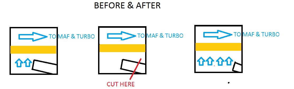

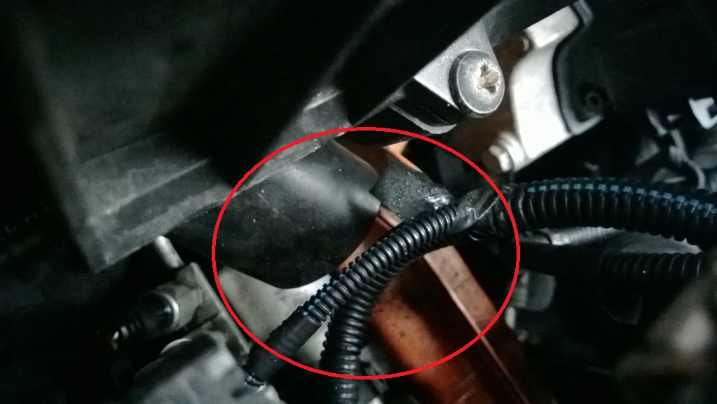

@Ryan D my pictures don't really show much so I've made some paint pictures too since I dont have a phillips to hand to get my airbox open...
:p
hard to see but where I've circled you disconnect the piping from the front bumper, this goes to the bottom of the air box.
this picture is of inside the air box
what I forgot to add in the picture was in the airbox, there is already a section that you can 'slide out' ( it will make sence when you take you open your airbox.)
followed by the otherside where I have diagramed where to cut :D
you have to options to either provide a 'less restrictive' air feed with some air pipeing or just leave it as it is after disconecting the inlet pipe.. just be sure to give your air filter more of a clean regulary.. (every 6k approx) :) getting yourself a panel filter will help flow too :)
thanks alot for the info buddy. im dying at that diagram last tho i dont know why just a great picture hahaha!
yeah ive already moved the "slidey out piece" im gonna take myself outside and grt to work removing the intake pipe and cut that other bit haha.
thanks man appreciate it!
:') I'm very busy in work honest!
I used a junior hacksaw with great difficulty at first, I then remembered I have a dremel tool!
already got the pipercross panel filter on. just took the airbox lid off and that little bit of tubing to maf and turbo is inside the airbox lid correct?
