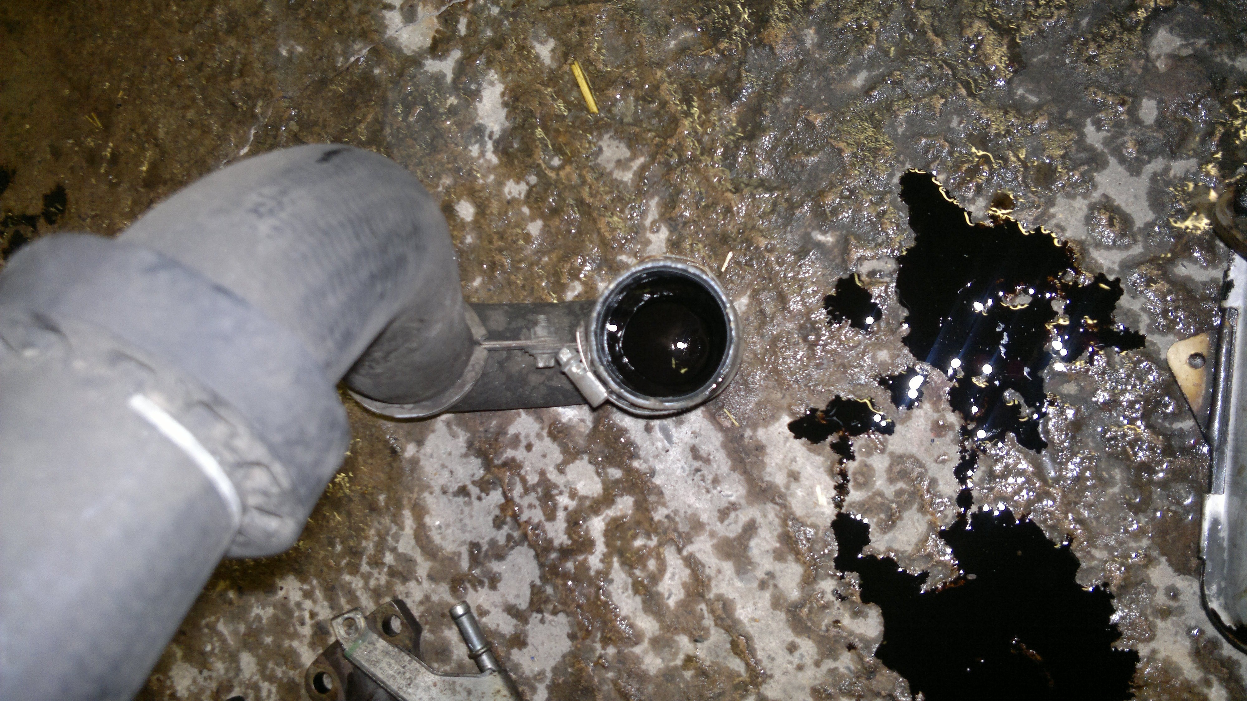

Put my finger up the exhaust pipe, finger was covered in oil.
Called a mate to confirm what I thought(Turbo failure), he said its a common fault, turbo thrust bearing fails and blows the oil seals.
Just finished taking the turbo out of his Astra VXR, must have been atleast 1 litre of oil in his exhaust system, thrust bearing and oil seals deffinately gone.
For those that are interested I've attached a few pics. The pipe from the turbo to intercooler is still full of oil.
