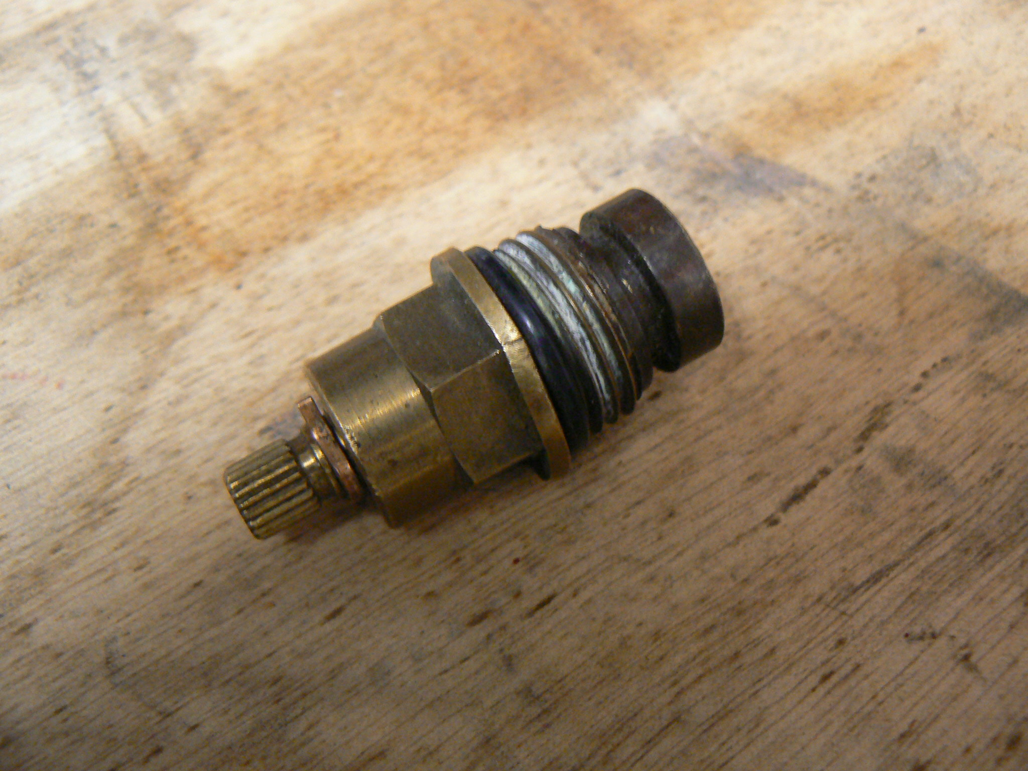

The type of jumper in this tap is the type I'm talking about here. What you find is that after a while, maybe years, the tap will only turn on enough to deliver a reduced flow. Then over time, this flow reduces until it won't flow at all. This is what has happened to many of this type of tap in our houses, and I've sorted out neighbours too.

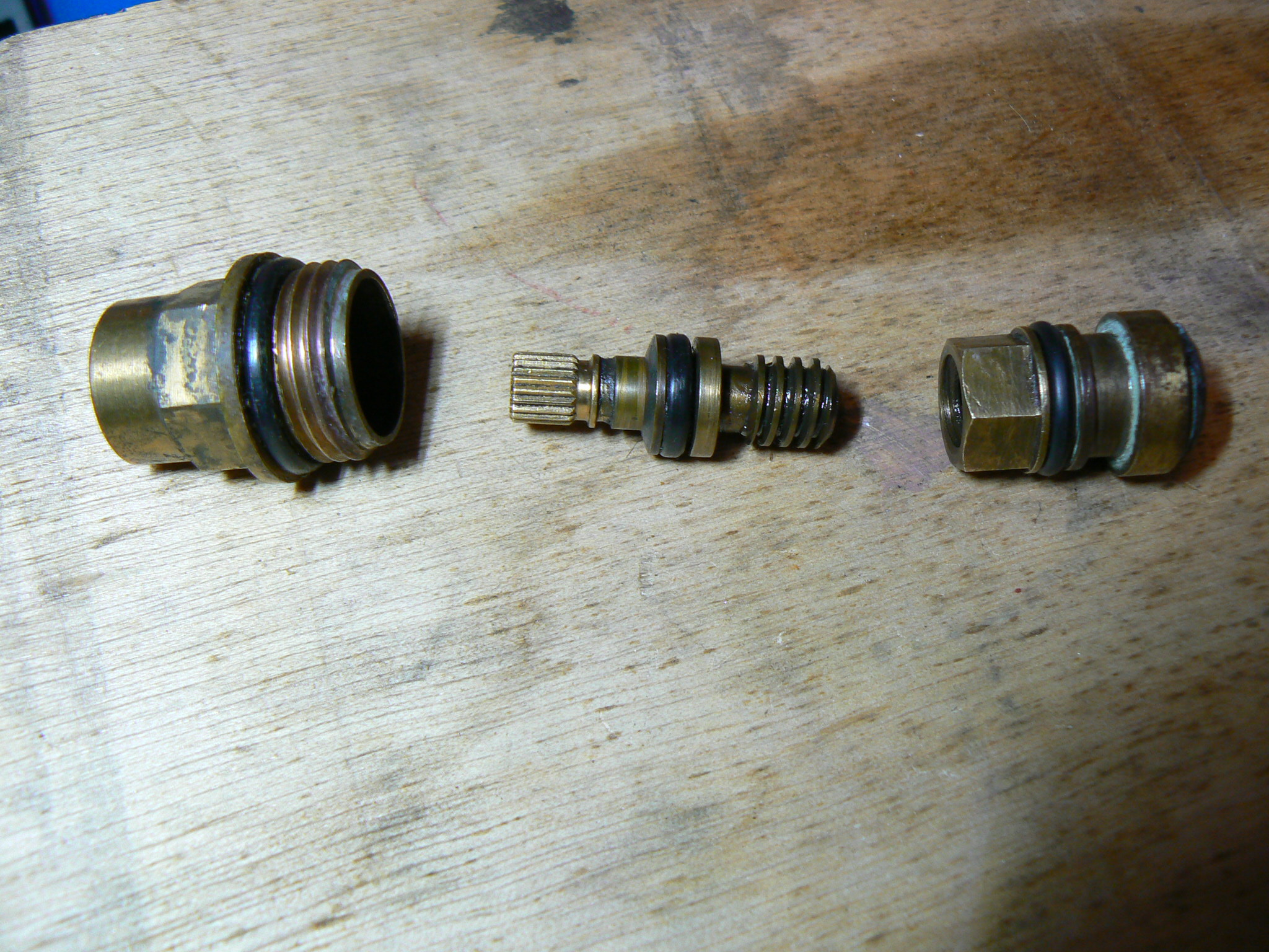

So what's going on? Let's take a closer look at the jumper unit shown in the last picture:
Look to the left and you can see the splines on the end of the shaft which is where the handle fits. can you see also that there's a wee circlip just to the right of the splines? Lever the circlip off and you can press the whole inner part out to the right and once out you can screw the splined shaft off the plunger which has the main washer which shuts off the water:
Now we can begine to understand where the problem lies. Look at the right hand component. Just to the right of the hex shape can you see there's an "O" ring? Now look at the middle part with the male thread. See another "O" ring? Well, what happens is the "O" ring on the right hand part gets hard with age and doesn't hold the water back any more. This lets water past into the very restricted space between it and the "O" ring on the middle component. For the water to flow through the tap the right hand unit has to be able to withdraw towards the middle unit. Water between the two, with water being a liquid and therefore not compressible, stops this happening and prevents you turning the tap on!
The simple answer is buy the jumper complete and simply swap them out. However, after a while, the new unit will just repeat the problem. Ok, they're pretty cheap, I think about a fiver from the likes of Screwfix? but you have to turn the water off and physically go through the motions each time.
