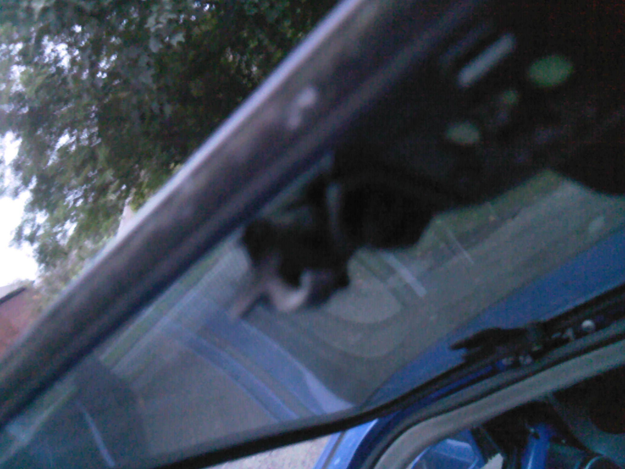

right **** easy two second job! turn the little screw, mine seemed to do a 1/3 of a turn either way. then wind the window up so its fully open. now from the outside of the car you will notice the glass is a little looser than normal.
now theres two parts to this clip one on the glass - can just see the hook thing in middle of picture
and one on the winding mechanism
the way i did it was move the little hook part so that fully disengages and then pull on the latch firmly and it pops the window out of the mechanism.
seems like the little hook on the window is like a safety catch to stop it coming undone. possibly why you cant move your catch.
hope this helps
