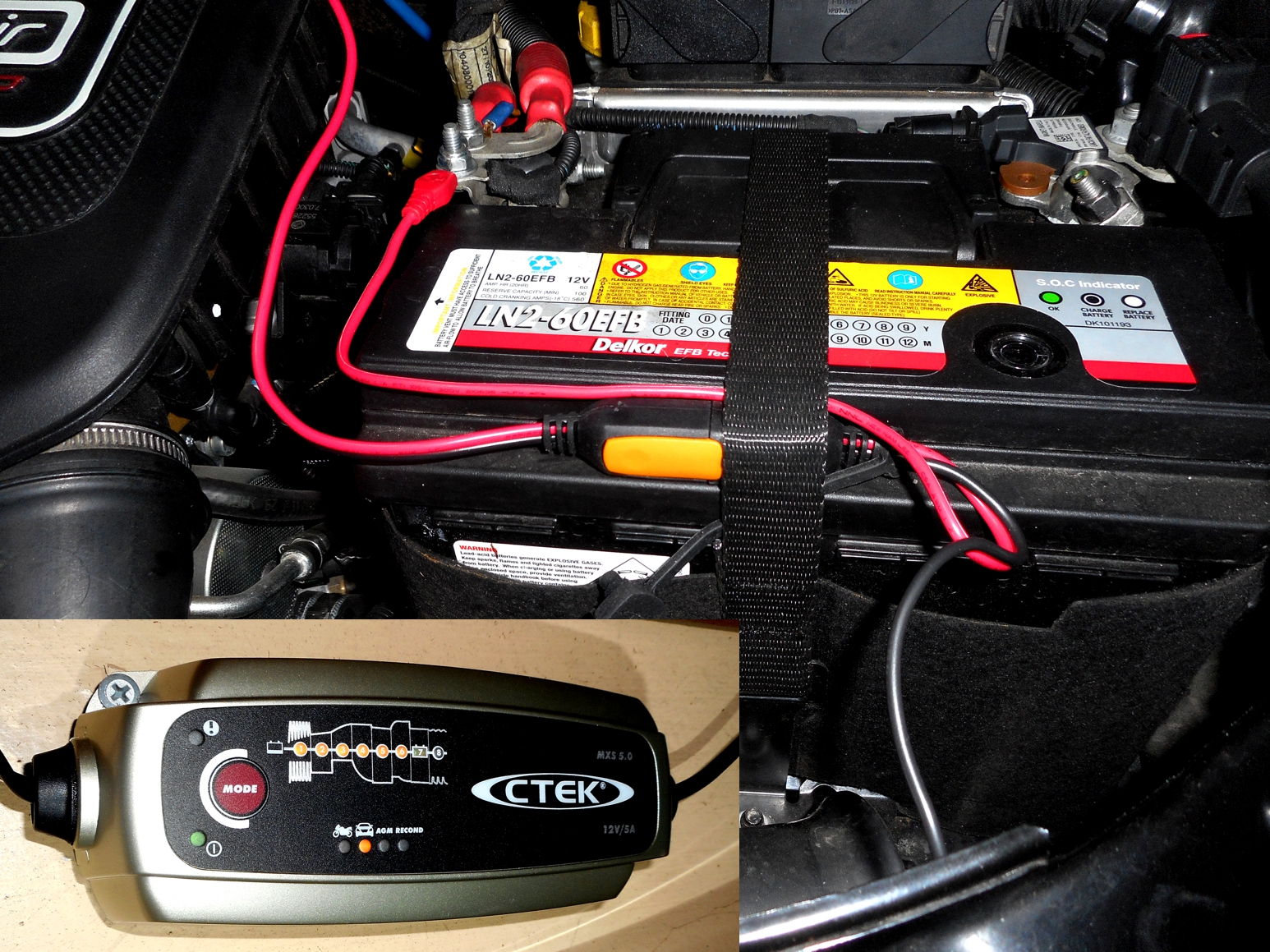

I bought a CTEK MXS-5.0 a few weeks ago and it's been connected to my car battery ever since. It has a dedicated AGM setting but my Stop/Start battery is an EFB type. I originally bought a similar NOCO charger but had to return it after it proved faulty.
The battery was in excellent condition before attaching the charger so I haven't had cause to use the reconditioning feature. As I understand it, if the device doesn't go beyond the No.2 LED then the battery is beyond help.
I used the supplied permanent socket with the eyelets, connected to the battery's positive terminal and to a good earth point on the body - that way I can quickly pop the bonnet and connect the unit when required. Do not attach the negative lead directly to the negative terminal of the battery; as I understand it this can cook the Stop/Start system's own battery monitor. The optional extension lead means the charger is screwed to the garage wall and I don't have a mains cable running across the floor.

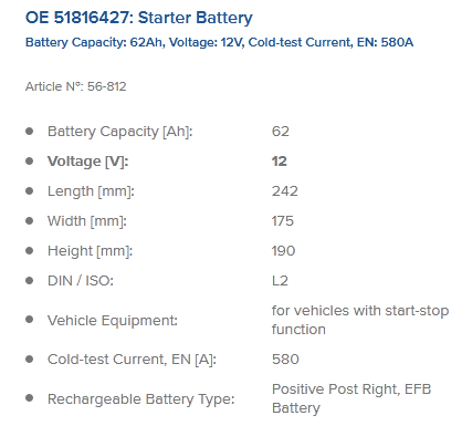

I believe my 2015 Fiat 500s 1.2 has the same EFB battery. Mine is the original Fiat/Mopar one with Part Number:- 51816427 printed on it. How can I determine whether this is an EFB type battery? Could it be an AGM type?
I also have a Ctek charger which I use for another car and I'd like to attach a permanent Ctek socket to my battery (as I have a spare). How about the stud on the battery tray that holds the strap down? Wouldn't that be good enough?
The cables on the socket are pretty short; no more than about 10"-12" on mine, so your choices are limited. I found an unused nut welded to the panel in front of the battery into which I was able to screw a retaining bolt to clamp the eyelet.

Yes! I found the nut you're referring to, looks to be M6. Thanks for the suggestion.
I didn't know what size the nut was, just hunted around in my spares box till I found a bolt which fitted:).
I was able to tuck the socket under the battery strap (see the photo near the top of this thread) so it's not floating about, though it's not going to reach any moving parts.
