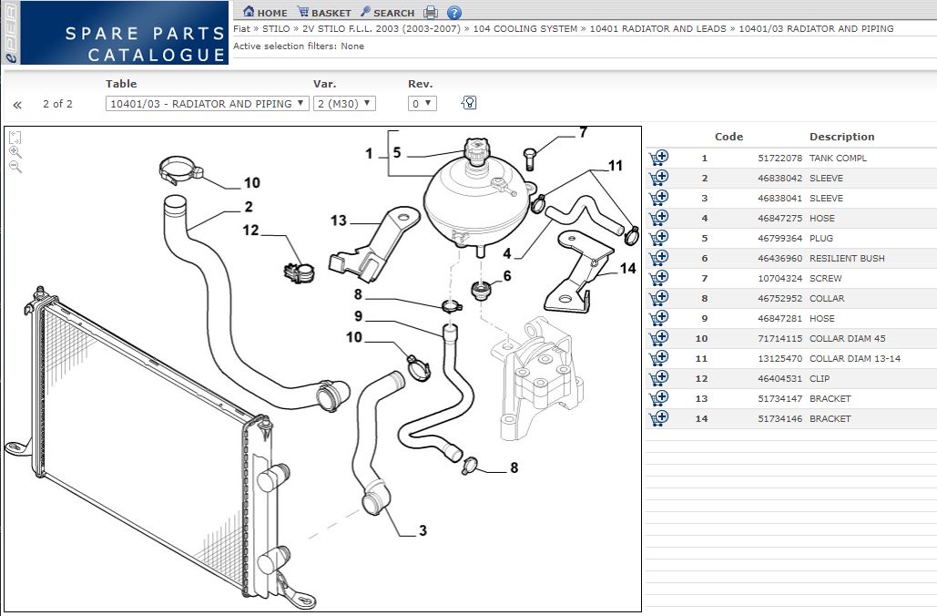

No mate,
it looks like that but is much bigger.. goes along the rear of the engine.. about 48/500mm long.. with a 30 mm bore..i saw that one and thought my luck was in..thanks anyway
No mate,

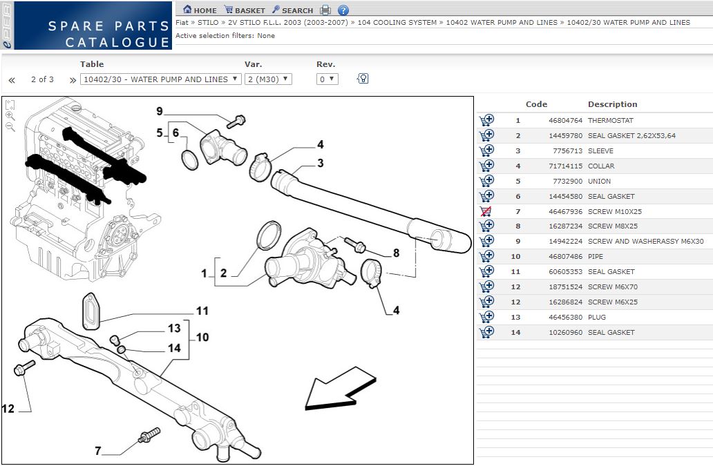

Item 3, part number 7756713 in the ePER diagram above goes along the back of the engine.
These are the only other hoses in the 2.4 engine cooling system.

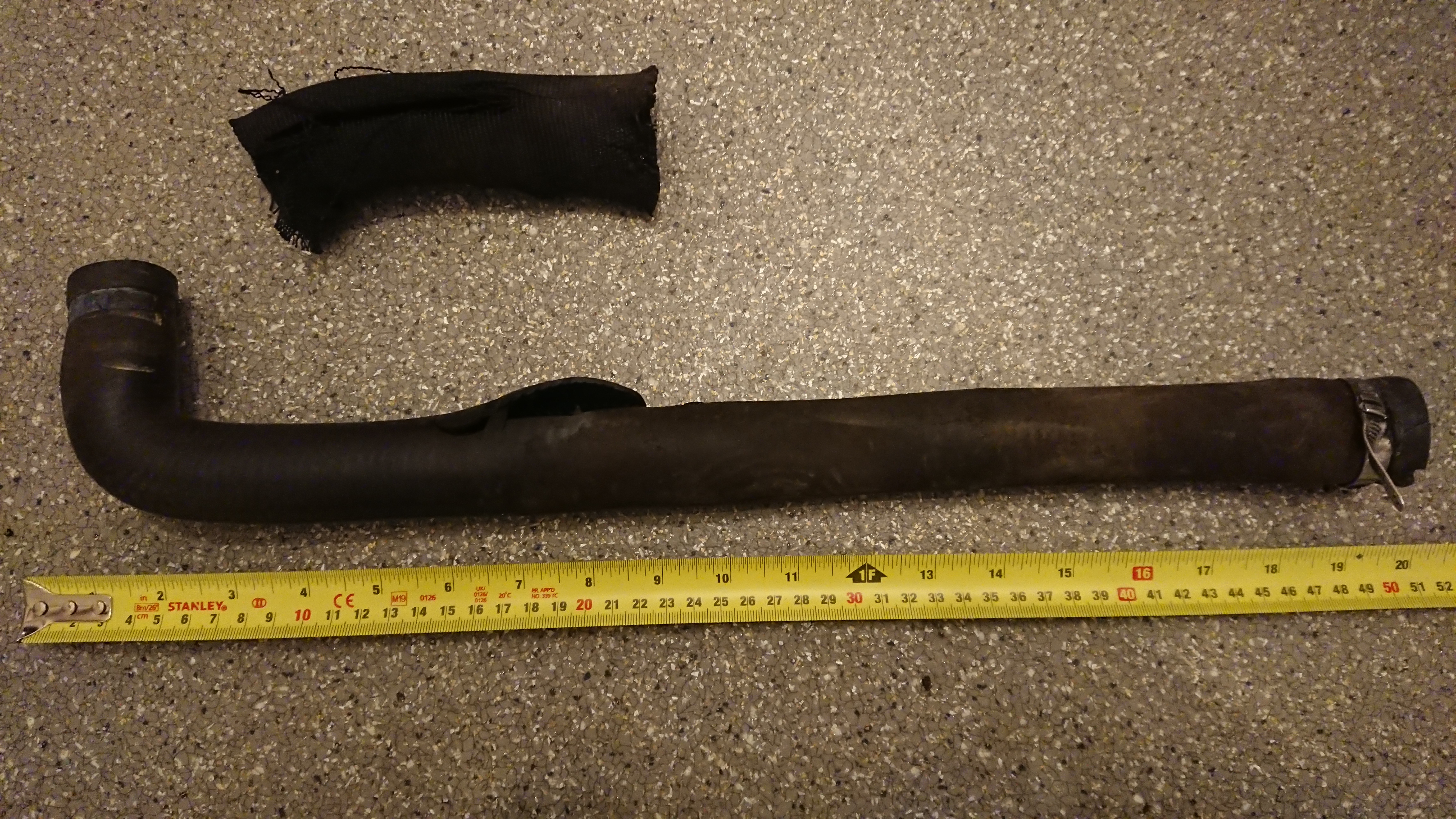

Yeah my thoughts as soon as it did a kettle impression.. but i have the hose here and its blown wide open about half way along the straight part..The guys are pretty good.. better than my local Fiat main dealer who have had nearly £4000 off me in the last 2 years.. DSC_0016.JPG

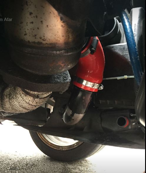

If you can't find the OE part *anywhere* then that looks like a simple piece of kit if you need to fabricate something yourself.
You would only need a short 90' bend section in red silicone and a short straight section in red silicone, with a joiner piece to join them. Any/most sellers of red silicone hoses will have something suitable in the right size.
My tip would be buy red hoses.. :D and get yourself a couple of stainless Jubilee clips... give them a buff with some chrome polish before you fit them. Then the beast will look like sauce whenever the bonnet is open for the next thing that's gone wrong... :D
Keep it going though lad.. you know you'll miss it when it's gone.

Yeah my thoughts as soon as it did a kettle impression.. but i have the hose here and its blown wide open about half way along the straight part..The guys are pretty good.. better than my local Fiat main dealer who have had nearly £4000 off me in the last 2 years.. View attachment 205121
You could stick the wreckage on your missus' kitchen scales.. the one in the linky https://www.buycarparts.co.uk/oen/7...MIlf-M6KnC5gIVWODtCh2_YAgkEAAYAiAAEgIIa_D_BwE says it weighs 287g... so if yours is 285-290g then it's probably the same item.

Hi Ralph,
looks awesome..
If the pipe burst like this it could have been due to a stuck thermostat.
Not sure what your sequence of events were when replacing the thermostat.
Hope it weren't because of no antifreeze, might have been the reason for thermostat and waterpump and welsh plugs might be next if due to rust.
Pipe could also burst due to head gasket passing compression air into water chamber.
Or oil or petrol leaking onto hose for excessive period.
Good idea to check before just replacing the pipe, next weak point will be waterpump drain orifice or radiator hoses to fail if head gasket is yhe culprit.
Not being negative, just good idea to find reason for failure of thermostat and pipe.
