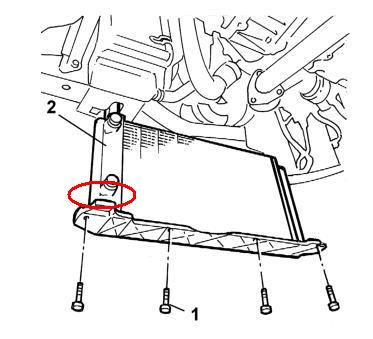

Common problem is radiator crack at base lh side looking forwards

It is most likely to be the radiator. The coolant is so hot that it won't show any signs of leak, as it evaporates the second it emerges.
See this thread:
https://www.fiatforum.com/stilo/237751-coolant-leak.html
Picture 1 and 3 on post #24.
I had do use dye to find the leak, as there was no obvious leak. Coolant goes from max to min in a month, and the radiator area has traces of dye around it. So radiator change is in the timeline this spring.

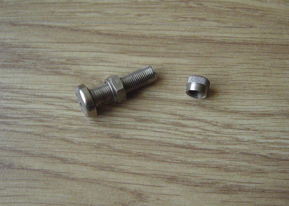

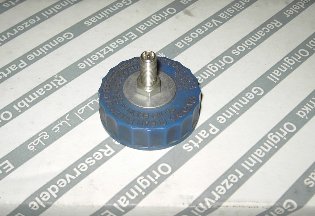

It's easy enough to make a cooling system pressure tester to confirm whether there's a leak and where it is.
Use an old Fiat brake fluid resevoir cap (they are the same size and thread as the coolant resevoir) and a screw in tyre valve and nut. Fit it to the coolant resevoir and pump it up with a foot pump that's fitted with a pressure gauge to no more than the coolant resevoir cap release pressure (1.4 bar I think for the Stilo).
Look for leaks and watch to see that the pressure doesn't drop. If there's no visible leaks anywhere but the pressure drops, then it must be leaking into the engine via the head gasket, or the original coolant resevoir cap was leaking.
You can also use the same device and pump fitted to the brake fluid resevoir for pressure bleeding the brakes.
This is the one I made and often use for both puropses.
Slighty off topic, but Davren, how did you make this fantastic little device? Can I use this to bleed my brakes? Let's say I open up the nipple on one rear caliper, go to the front and just pump, until I have completely bled that line? Then I go back to close the valve/nipple and I'm done? If so, it's a genious one-man bleed kit. :worship: I've got a foot/pedal pump.
It's just an old Fiat brake fluid resevoir cap. Drill a hole through it and fit a threaded tyre valve (available from any tyre fitter).
Bleed the brakes exactly as you describe, but make sure the level in the brake fluid resevoir doesn't drop below the level of the clutch master cylinder feed pipe located part way down the resevoir.
