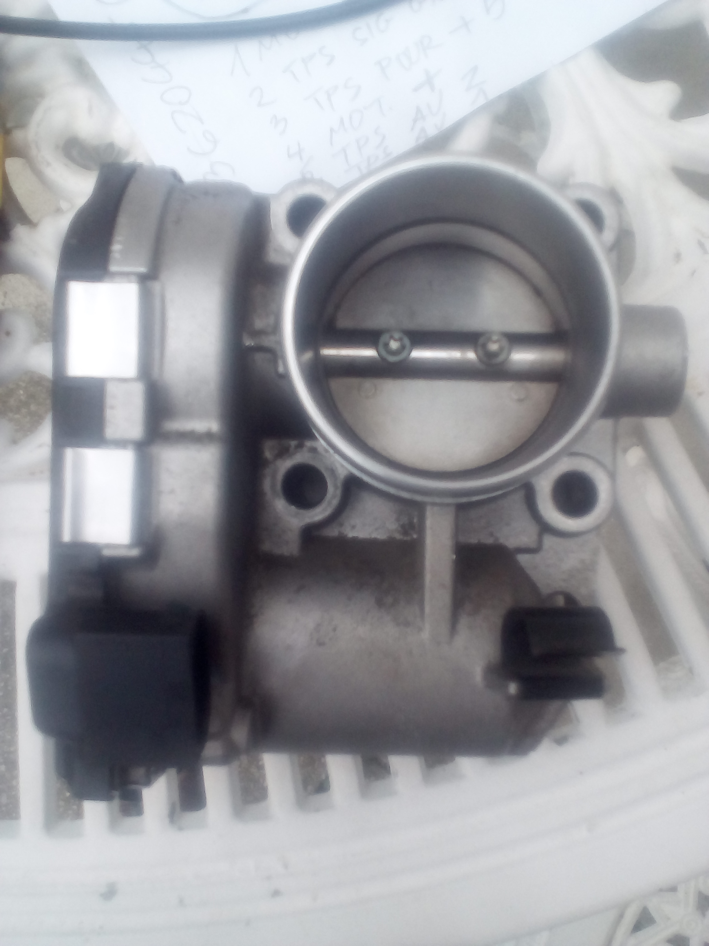

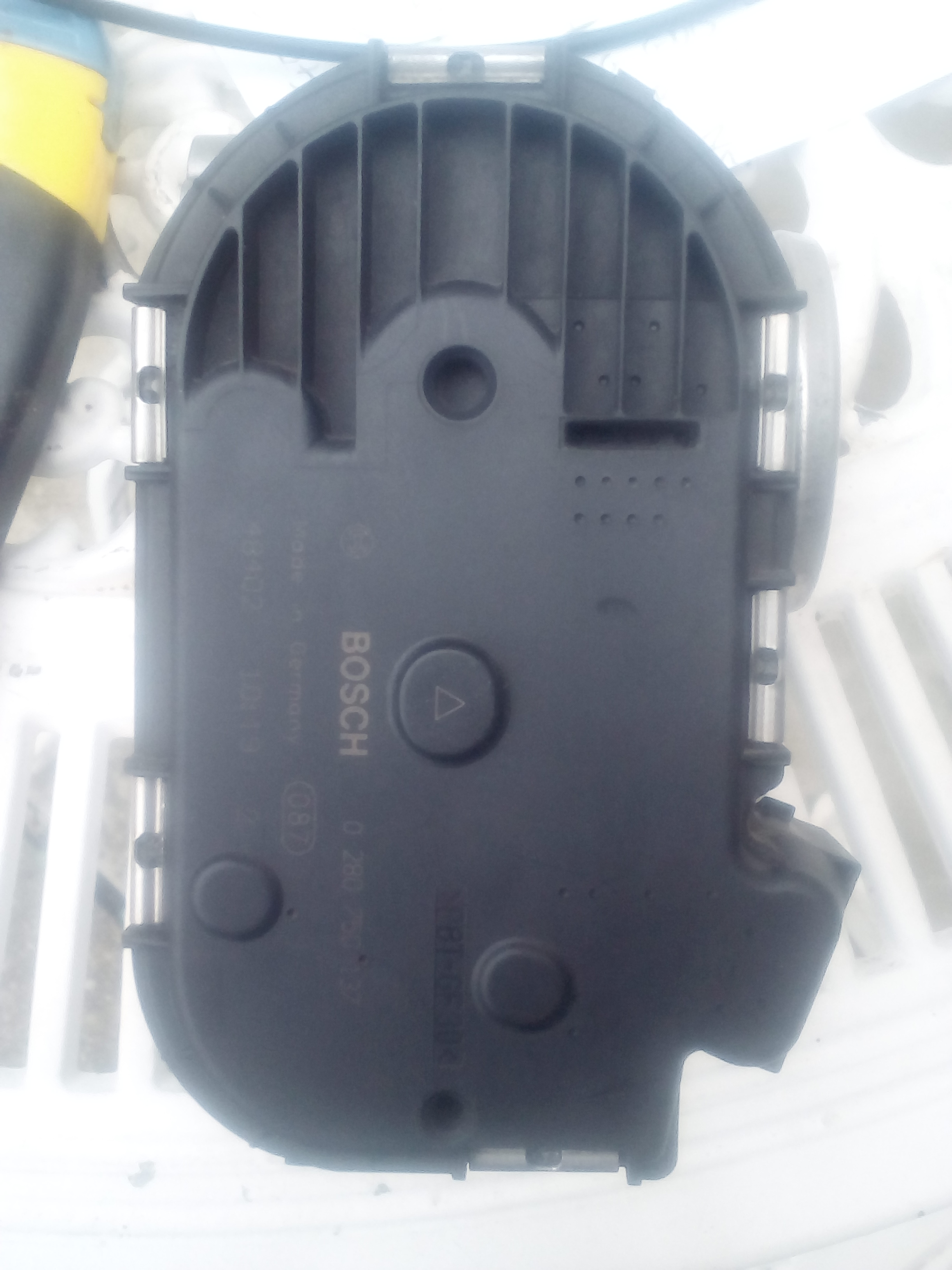

I have a question about BOSCH throttle body TPS on Stilo 1.4 ,throttle body part No 0 280 750 137. Can TPS sensor, black plastic cover be bought separately or can the whole assembly be changed? I can't delete the P1688 error, it keeps coming back after learning.:bang: Cleaning doesn't help. The car goes OK, no problems with idle, run smooth. I'm afraid the potentiometer has lost resistance, I measured at both less then 1.2 K Ohms, I think the factory spec is about 2.55 K Ohms. I don't find that part especially in car shops in Hungary or internet .
Thanks in advance for the advice.
Sorry in bad English.
