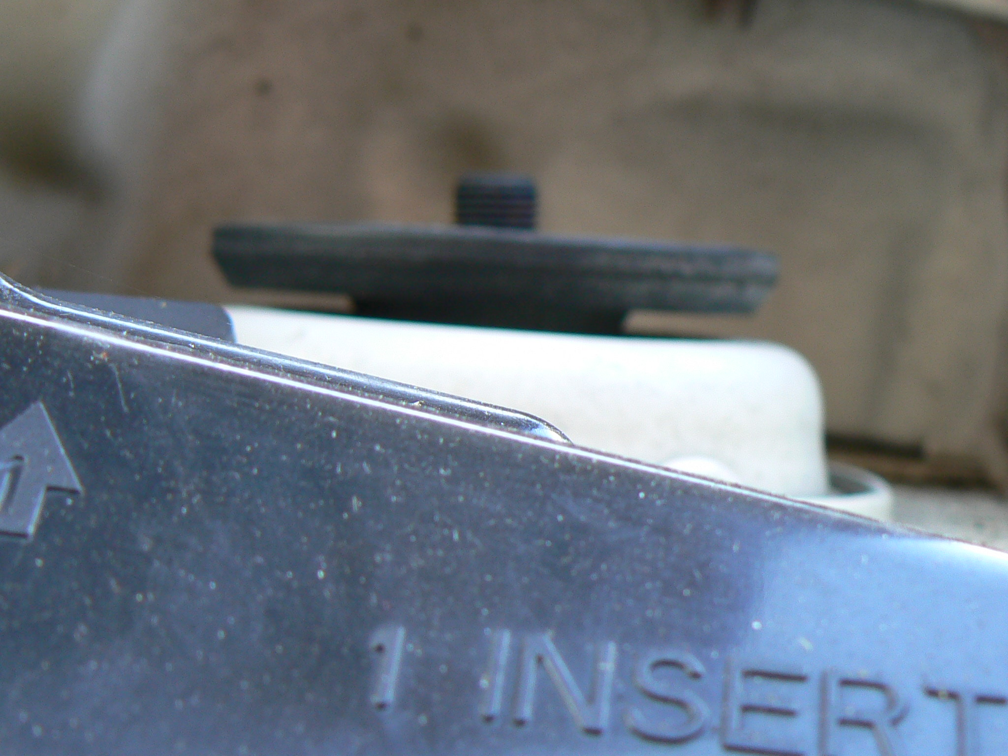

Is it just me or do a lot of the 169's you see in the street look a bit "down" at the front? Our Becky (2010 Panda 1.2 Dynamic Eco) had this stance and I didn't really think anything about it until I rebuilt the front suspension - because she spectacularly blew out her N/S front shocker, oil all over the place! - It was only when looking at her afterwards that I realized she's now sitting level. Because of this I tend to look at other Pandas when I'm out and about and quite a few are distinctly down at the front.
Having had a good look at the parts I took off Becky it's obvious that the new road springs made a difference but also that the top mounts, whilst still serviceable, had "relaxed" considerably. This can be easily seen if you look under the bonnet at the top of the strut rods and observe how far they protrude from the top mounts. On Becky one was protruding visibly further than the other (O/S if I remember) and both were protruding considerably less with the new top mounts.
So, I suppose what I'm saying is that if your's is sitting a bit down at the front when you look at it on a flat surface then it may well be mostly due to settling of the road springs but the top mounts also seem to play a part so I'd always renew them if replacing springs/shock absorbers/etc. Just because your car is sitting a bit "nose down" doesn't necessarily mean it's unroadworthy though. Becky has always pulled slightly to the left - despite resetting toe and doing numerous other checks and component renewals - It was noticeable that the degree of pull was considerably reduced - almost unnoticeable now - when the front suspension was rebuilt and I wonder if the combination of ride height being lower on one side - and lower overall - was the main contributing factor?
By the way, the pics of the top mounts were taken with the car on it's wheels. ie, not jacked up.
