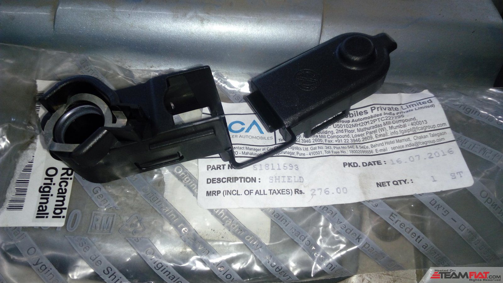

LOng term solution find the part number for the 'shield' Snows FIAT/SEAT of Southampton only have the entire starter motor listed BUT do recognise the only shield part number I have which is 46554401, this may not be for the 1.1 Engines starter but May fit, as the cap is missing off of my shield then I cannot quote its part number, can anyone help?? PLease!
This is a picture of a shield from another FIAT note the part number on the cap
