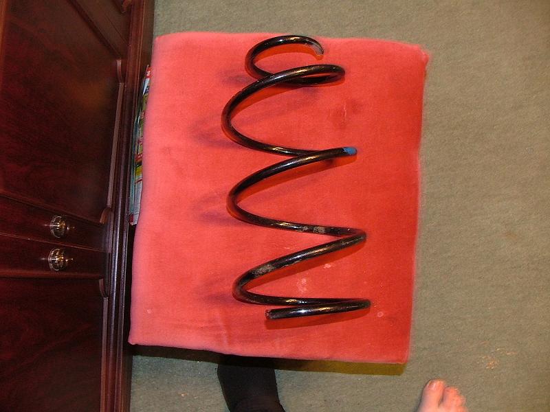

look just got a spring out of my sock draw to show you. see how the botton is flat? and if you cut then further up there no way its going to sit propper? sorry

Cinq_Sport_BiG_DaVE said:
:(but no 1 does a set of decent low like 70mm set of springs for a cinq
thats y i was gonna cut them:(
FK automotive do some 70mm at front and 50mm at rear springs... but ideally if u are goin that low u should invest in shorter shocks! it will go a bit lower with shorter shocks!!!
but if u want the springs only go to www.performancedriven.co.uk
Agree with what's posted above, don't do it - it's unsafe. Get properly made lower springs.
