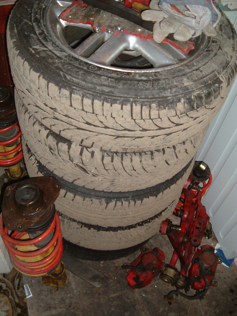

In a standard spring and damper system the height of the spring is fixed. On a coilover system the base is typically mounted on a thread allowing the height of the spring to be adjusted.
Coilover:
Standard Shock:
Not the best pic but the only one I could find.
