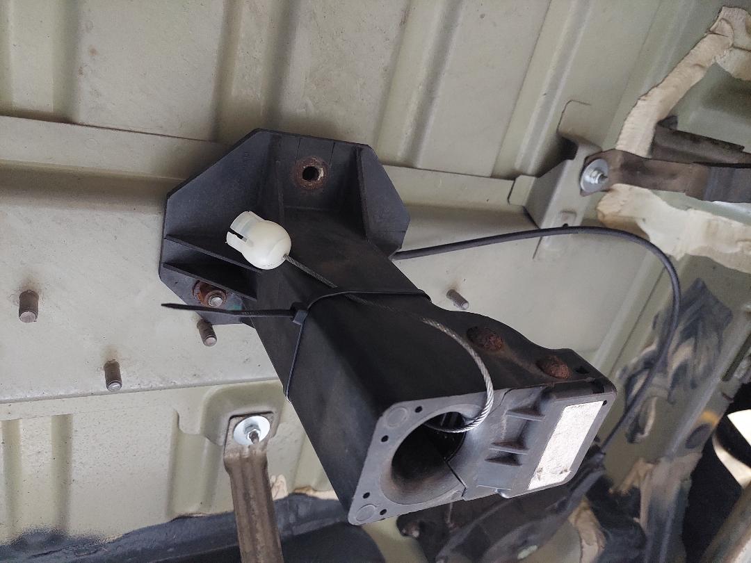

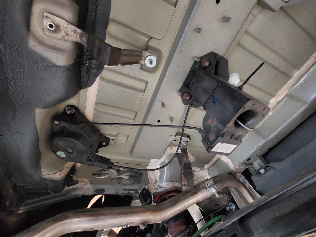

Regrettably, the Qubo didn't go in to the garage as arranged, to have its spare wheel carrier fitted. The Missus (and RVM!), convinced me to be a MAN, and have a go myself!
So the appointment was cancelled, and as you can guess, other urgent jobs intervened (and have since been completed).
I finally convinced SWMBO this 30-minute doddle was never going to be a priority, and reverted to Plan A. So, the Qubo duly attended our garage this morning and the job was, obviously, easy-peasy?
Er, no. It wasn't. The facelift model is different, and despite the seller assuring me the scrap parts would fit all Qubos of whatever age, they don't.
The central pillar has bolt-holes which miss matching the available bolts by about 4cm. Therefore, the two parallel bolt-holes must be fitted over two other bolts, set slightly further forward towards the front of the car.
That makes for two further problems - 1. that the third bolt hole has no matching bolt, and sits proud of the metal beam to which it should attach. Not forming a sturdy triangle, the pillar is therefore flexible, obviously quite unable to bear the weight of our space-saver, let alone a full-sized wheel.
2. That the cable is stretched far too tightly - it is now too short.
Without drilling holes through the car floor (which the garage was understandably reluctant to do), it seems difficult to work out how to attach the wheel-holder to the underside of the car.
I am attaching two photos of the underside, with the wheel-holder attached to the forward bolts, and you'll see what I mean.
Anyone any thoughts on how best to proceed?

I recently purchased a Fiat Qubo to tow behind my motorhome. 2014 model with the 1.4 engin. The car came with a temporary sparewheel but not fitted to the underside with a wheel carrier. I made inquiries through the local Fiat dealership and ordered the wheelcarrier or modem as the call it. Fitting should not be a problem as the winder meganisme bolts on to 3 existing stats and the centre pilar bolts on to 3 existing stats. I had a look at the previous photographs and my suggestion would be to get a plate and using the existing 6 stuts to fasten it and then bolt the pillar with 3 bolts on to the plate. Hope you come right alternative cut all 6 stuts off and bolt the pilar with 3 bolts through the floor centre section
Sorry they call it a module not modem. Should you wish to buy a new carrier please quote the vin number of the car this makes life much easier
