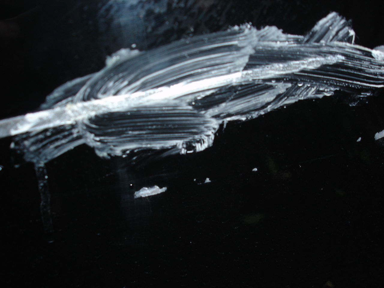

So lets assume your stupid, like i was, and you've ripped off the plastic without really caring that much, or, that however slowly you do it it still leaves rubber like below.
this sucks, and the best way of getting this off is a credit card or something similar, i found (in my dads shed) what looked to me like a plastic chisel, so i used that for the duration, you may not be so lucky, a credit card will do fine, but i'd use an old membership card as if it breaks your not going to be that bothered.
pretty self explanitory how you use it, simply scrape along the rubber, again short sharp bursts of power seem to work better than contanly scraping the whole length.

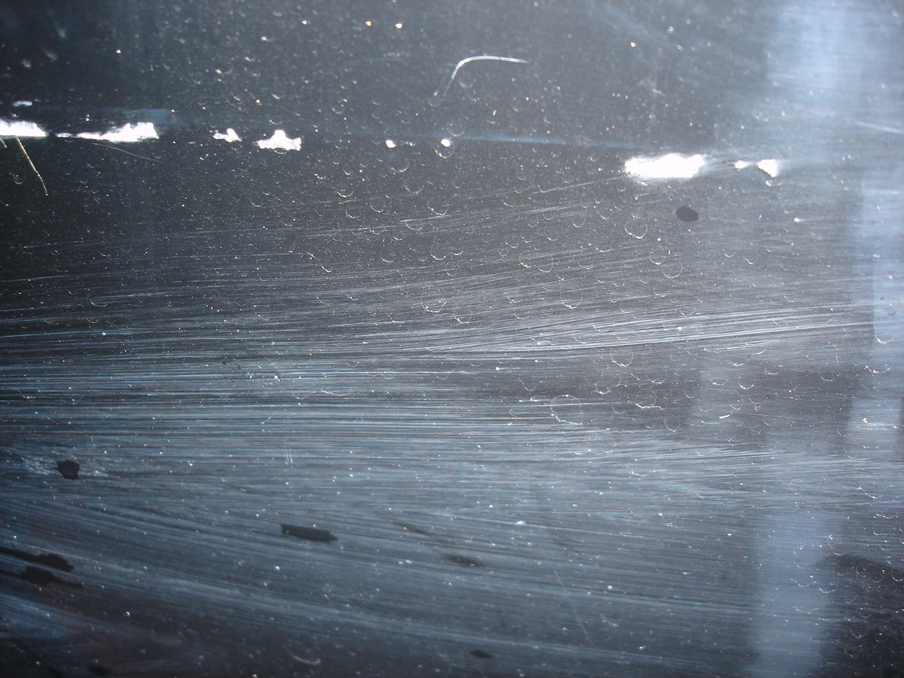

this is what you are left with,
2 mm thick rubber, more like just the adhesive, this is when you start bringing out the big guns, i used petrol from my dads lawn mower, only need a mug full, i made experimented with mixtures, i found that a mix of petrol, fairy and brush cleaner was best as this made a paste like bubbly mixture that when applied didn't drip as much.
depending on how retarded you are and how quickly you pulled off the plasic bumpers, scraping this stuff off can take from 30 mins to 3 hours.
it took me 3hours 30mins.
remember to t-cut after aswell!
