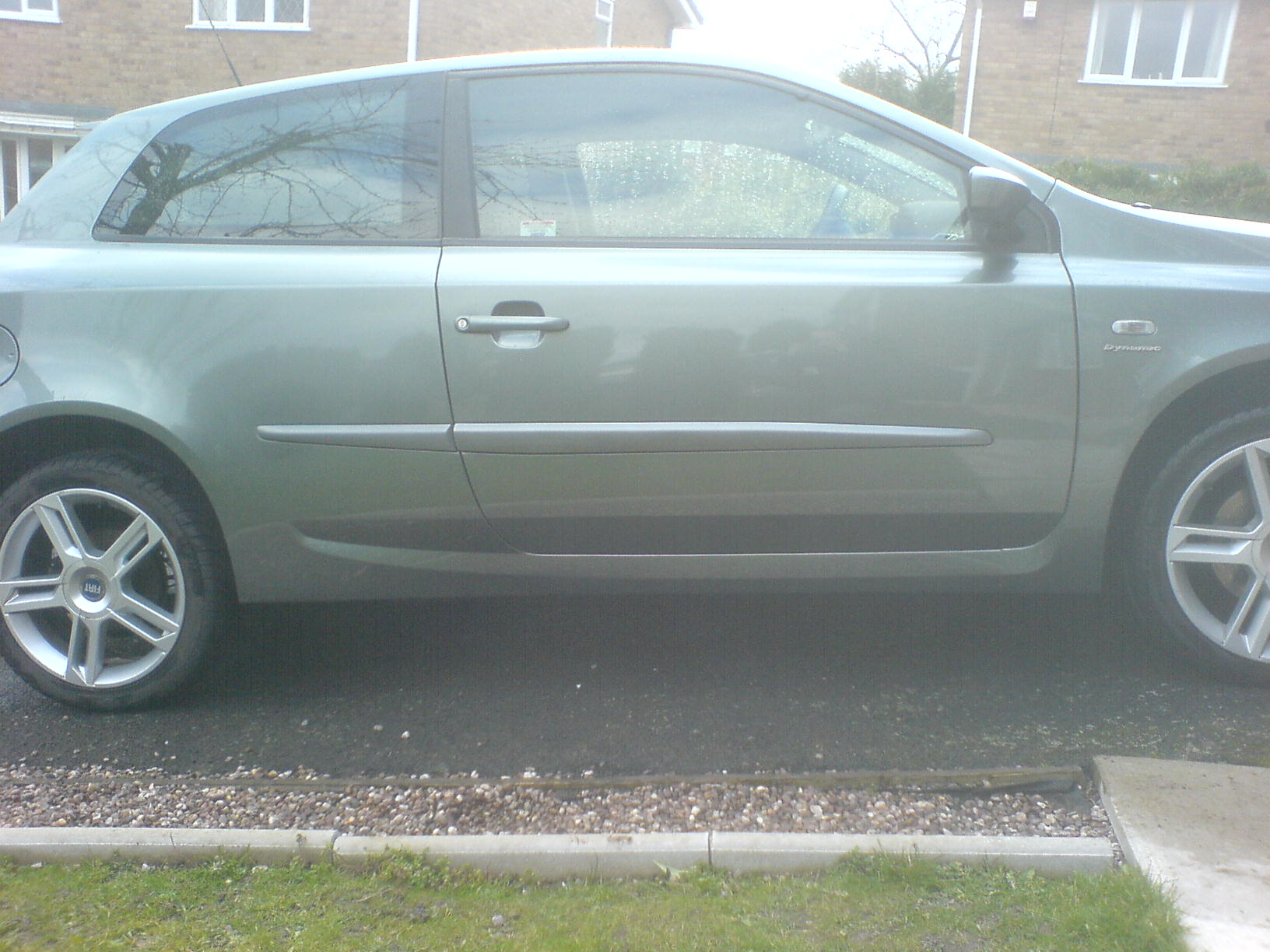

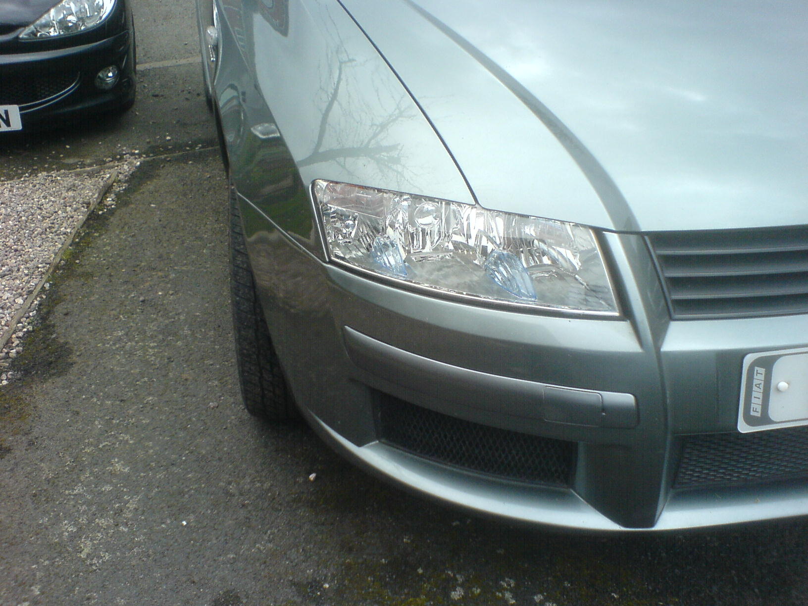

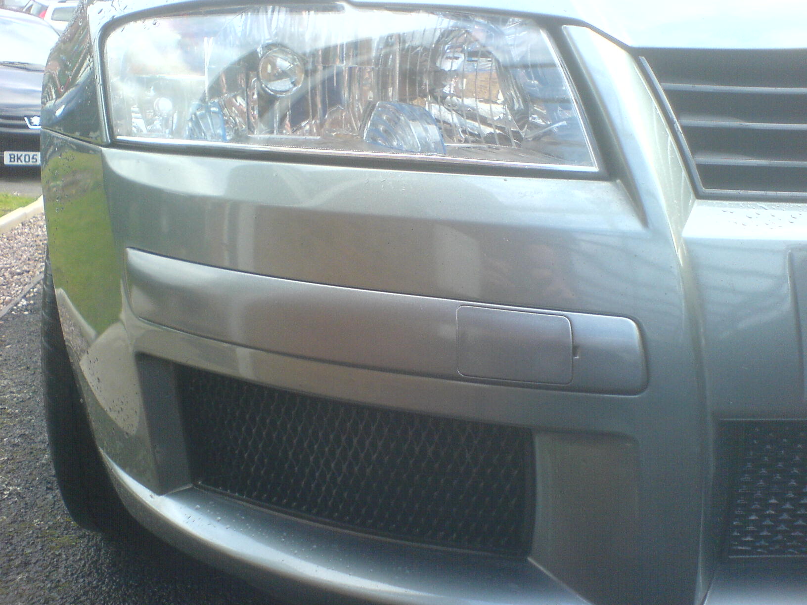

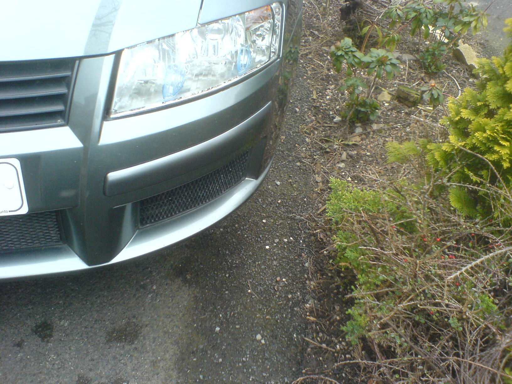

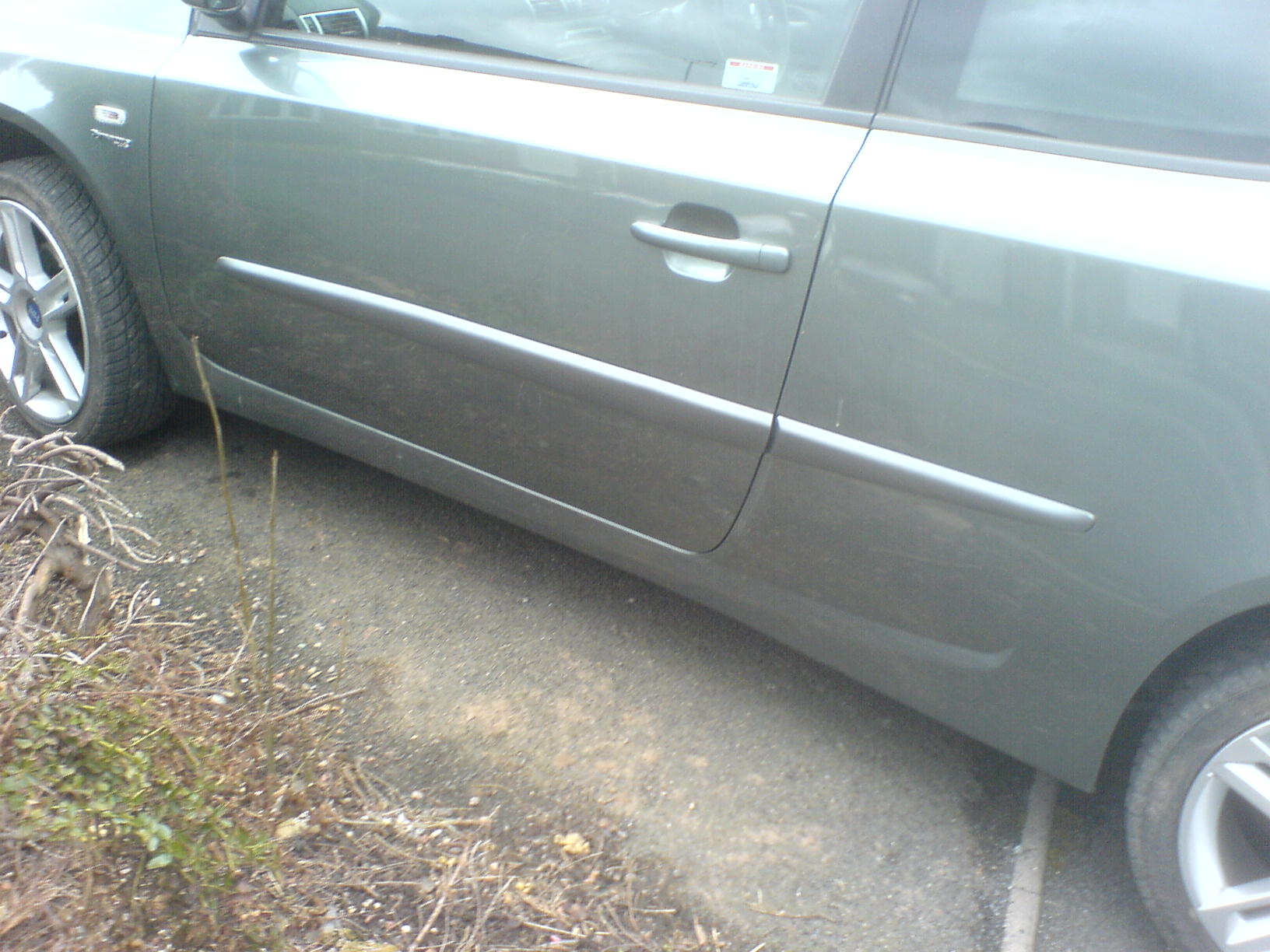

paint has arrived, door strips off and bump strips (except rear). new door clips on order, all but three snapped when removing strips. should all be done by the weekend :slayer: then the skirts need fitting :confused:
front bumper and side done!

Looks like a top job there m8, its suprising how much of a difference they make :)
Just noticed you've got black mesh on bottom sections of your bumper, which is what i want to do to mine? Did you buy them as inserts or just buy the meshing and cut in down and bond it to the inner of the bumper like fitting mesh on bodykits??
i bought some black mesh, cut it out (took ages) and pulled the plastic grills out and used cable ties to hold it in, then pushed the grills back in place ;)
