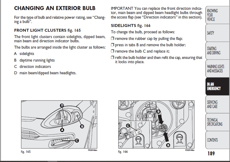

Have a look at the attached pic, taken from a Evo handbook download. (If you have a handbook, perhaps a read through might help you understand your car better. If you've not got one, choose the most appropriate download from the EVO section.)
As I said, the sidelights are the little twinkles in the headlamps. (A in the pic) What you have circled is the Daytime Running Light (DRL). It does have an orange appearance in your pic, presumably just a reflection.
DRLs come on with the engine, to highlight a moving vehicle. They are brighter (21w) than the normal sidelights (5w) and legislation states they must either extinguish, or dim to sidelight level when headlamps (or foglamps) are on. It would appear that your car is working as it should, and no, you can't have the bright lights on with the headlamps, as that would be an offence.

That is an EVO in the picture, the Grande doesn't have the black plastic front bumper.
I think it might be OP's car, based on his profile pic it looks very similar.
Based on OP's picture, and Bill's manual extract I think he's talking about the DRLs, rather than the side lights, and wants them to stay on with the headlights.
Edit: And the EVO indicators are in the black bumper section, OP seems to have tinted them black.
