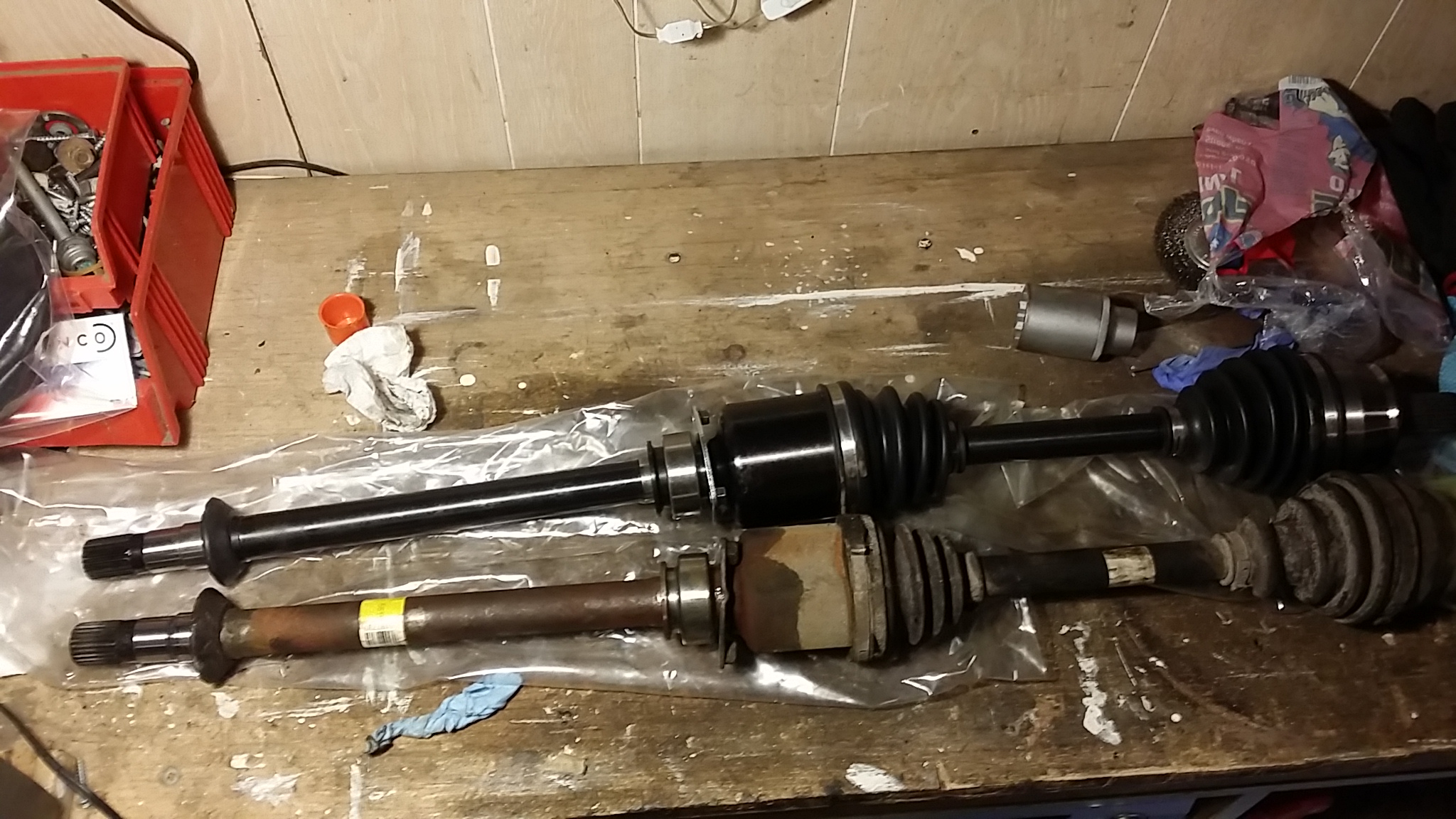

Had the same shake 1 year ago, changed the right side axle and it was fine for 25000km, now Shaking Stevens is back.
So changed the right axle again to no avail.
Next cleaned all the wheels that are filled with mock this time of year from road salt etc which cause the car to shake at motorway speeds, but this has nought to do with the shake under acceleration. Wheels are balanced and brand new so not the culprit.
Well this time it is the left axle (UK passenger side) that is shot. It has the same ca. 3cm free play as the right hand had when it was gone. I hope this will send Shaking Stevens packing back home.
It is the spider = 3 bearing housing, that is not strong enough for the torque of this little engine, so torque under acceleration eats them spiders, only a few millimeters, but that is too much play for a bearing to do its job smoothly. The same axles are used for petrol engines. They should be refinforced for the diesel, but Marcello at Fiat engineering dept probably though that, "noo... it is a fine for this carra also, no?"
Modern cars have this proble sorted with turbos that kick in immediately at low revs, so torque is even adn does not destroy the axles and bushings...not like the 1.3 mjet that requires Lada style revs to take off from halt. (MOT lads almost could not get the car out of the brake testing dyno last year :)
So to remedy: Here is what you do: order (on ebay or whereever) the whole axles with shafts & nuts (these are quite bulk as the same is used for Opel/Vauxhall Corsas, so do not bother to buy just the outer or inner axles) as below if yours is the 75bhp version (if other look at eper for the correct partnr)
Right axle (UK Driver side) for Fiat Grande Punto 1.3 mjet Diesel 75hp part number:
46308329.
I ordered from ebay.uk seller j_r2006, (their item ID was 142239530881)
at £82 shipped to Finland. Came in 1 week and perfect quality.
Left axle (UK passanger side) for Fiat Grande Punto 1.3 mjet Diesel 75hp part number:
46308345.
I ordered 17.11.17 from ebay.uk seller in Poland Uniwersal.pl, (their item ID was 332106905941)
at £60 shipped to Finland. Should come within a few weeks and should be teh correct part. I will post here.
Next in line is to change the tierod ends,lower control arms, and stabilizers, which can be ordered from e.g. Autodoc for about £100 the lot for both sides. That should make the front of the car new..for ours is driven 170.000km already so these are just basic wearables..
The engine mounts might be good to change also, as was said above, that albeit they look ok to the eye, our engine rocks like Mick Jagger on start up and shut down, so they are prob shot.
I'll keep posted, and would be most glad if others tackling the same would alse find the time. Cheers

Hello Daniel, do not worry, I am 99% sure it is the part that your garage did not change that is the cause for the terrible shaking and juddering. My GP does the exact same starting at about 45km/h-75, and then whenever I need torque to accelerate, so therefore it is the axle that is bad.
The axles should not have any free play at any direction. Not up, not down, not left, not right. Some mechanics may say that is is normal....well it just is not. So out with the old and in with the new, and off you go happily again.
Look at the picture in my post above: the inner axle the garage did not change for you has the spider housing (tulip shaped) which has now eroded away a few millimeters inside its cup causing the vibration as the bearing balls are not tightly against the tulip shaped spider thingy anymore.
I do hope this is the case for you. As you are in DK, I bet the garage will charge you like 400euros for the inner axle, as they did for me here in Finland....Well do not pay, buy the part your self, as I did this time for 90euros as above stated, and you can change it yourself if you only have a warm enough garage and basic tools.
However it is an 1,5 hrs job for a garage, so you may not want to bother with the 32mm and 36 millimeter size. If you have the nerve, you should have the garage change it for you for the price of a coffee, because they do not seem to know a whole lot about drive axles /causes for torque vibration...I am no mechanic, but using common sense and reading and watching what possible causes for problems are is not too difficult these days of the internet.
Have your car VIN (ZFA.....), Engine type (199A2000 for me) ready before you order, as it is wise to double check from the seller the axle you want is axle that will fit your exact car.
- Hope this helps, have a good weekend , -Andy

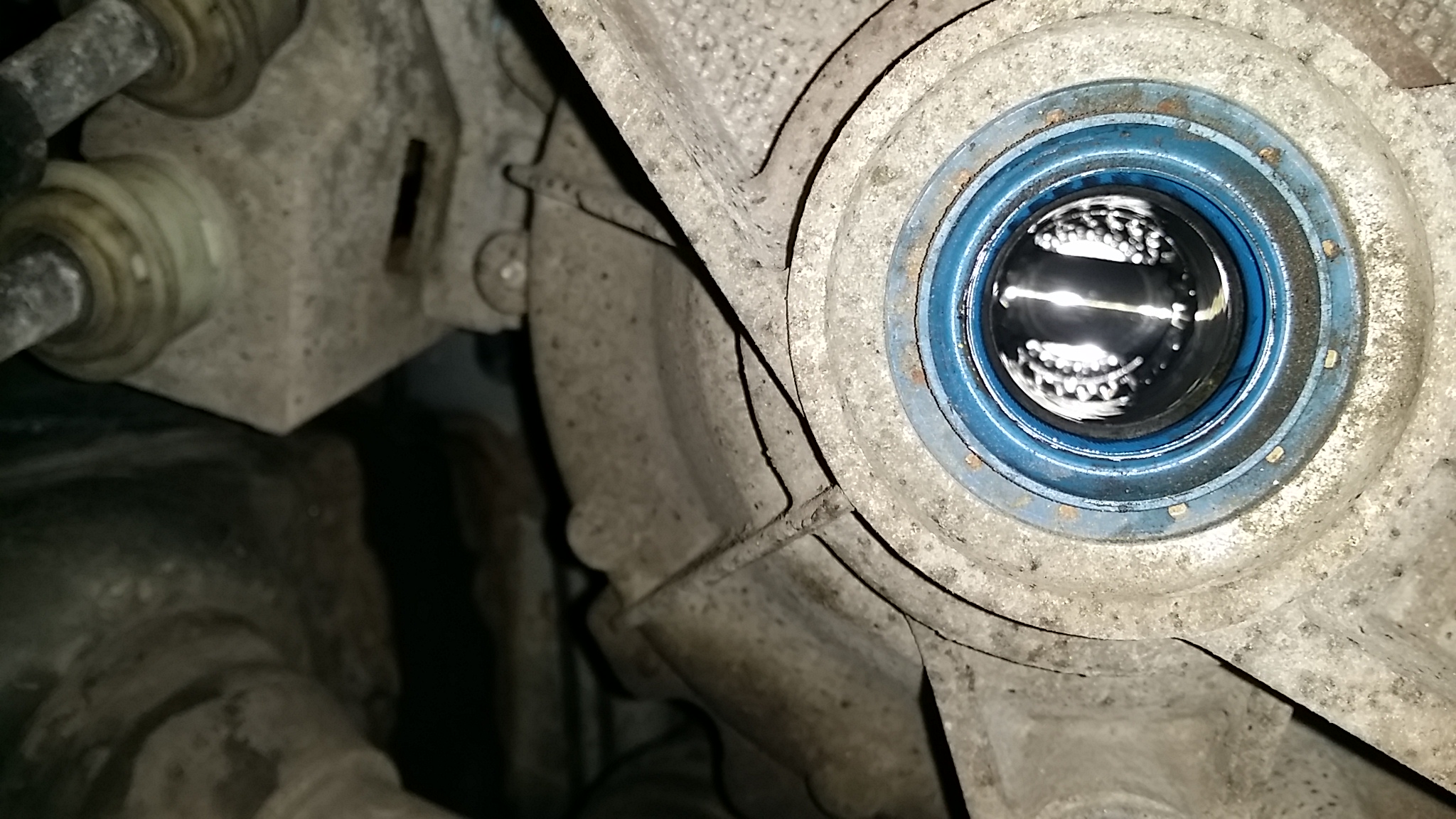

I was wondering if I could just replace the inner part of the right axle:
thumb
as the outer part of the axle is only 3000 km old (4 months)?
But this will might cause trouble if the bearing balls on the outer part has been worn a bit by the old broke spider housing on the inner part?
So this is maybe not were I should save 45 Euro compared to buying a new full axle.

The driveshaft only has two working pieces - the inner and the outer CV joints.
If you have one good (outer) CV joint already, then you don't need to buy a whole driveshaft - that just makes life easier. You can replace just the old inner/spider CV.
I did mine recently:
https://www.fiatforum.com/stilo/454298-tripod-spider-replacement.html
The symptoms I got was a growling or vibration when the worn joint was loaded, so for the right hand CV, it was worse when I turned left. It also rattled more when the car was loaded and going up hill (I guess the driveshaft is less horizontal).
If you get under the car and push the driveshaft upwards (hold the shaft just next to the cup) then it should not move at all (although "some" play is normal). Mine moved several centimeters up and down. If the other side is good/new, you can compare the two sides. If one moves a lot more than the other, it's knackered.
Spider is an easy fix... hammering on the new one without breaking it was the trickiest part (I used a old socket that was the right size to fit on the face of the spider but inside the orbital bearings.
Ralf S.
Thanks for the reply Ralf!
The whole outer part of the right axle is new (has droven 3000 km now), so the inner CV joint is also new. It continued to vibrate even after the new outer axle was put in. So the only thing that has not been replaced is the inner part of the axle with the CV housing on.
So I think it is the CV housing that is gone bad - if it is the CV joints that are making the vibration.
