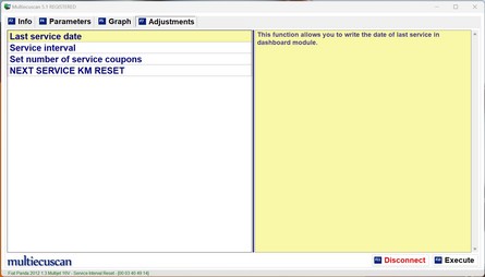

Connecting and running MCS gives me the following:
I was surprised to see Last Service Date is 05/05/2023 (the last garage service date) not when I did the service and reset on around 25/08/2023.
So I probably didn't do the Service Reset properly.
So can anyone tell me what to change when I service the car again?

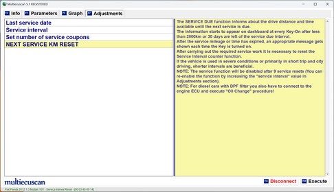

The action in all capitals is the one that resets the service.
Then, somewhere else is the oil degradation counter reset for the diesel. Not sure where that is, as I don't have a diesel, so not needed it.
EDIT: Just fired up MES. After resettign the service, disconnect from the 'Service' function and then select Engine. Once connected to that module, the Adjustments section will show 'Oil Change'.

Finally got access to the car this morning, did an oil and filter change and plugged MES in.
Followed the instructions from The Panda Nut
Arrgh! - it still showed 'Service 8 dd'...
Realised what portland_bill meant by 'The action in all capitals is the one that resets the service.'
That did the trick(y)
I've made full notes (with a link to this post) as I'm sure I'll have forgotten all this by next year:unsure:
